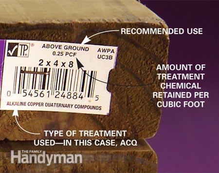

The treated lumber that is sold here has a label which states 'Not for direct ground contact" which I always thought was kind of odd. So as far as sinking it in the ground without additional protection might be problematic in the long run.
What I've started to do is spray then bottom ends of any outdoor wood (even metal fence posts) with truck bed liner for the length under and near under the ground. Cheap insurance. Just my 2 cents though.

Finding PT 4x4 posts around here isn't easy. Most everything is for above ground use. OTOH the 6x6 posts are landscaping timbers designed to be for ground contact. Ground contact doesn't mean burying but will last longer than those designed for above ground use. Back in the day I would just say get some creosote and brush on a nice heavy cote but the EPA has ruled it out. I had access to old telephone poles but now the EPA makes power companies treat them like toxic waste so they don't give them away anymore.
