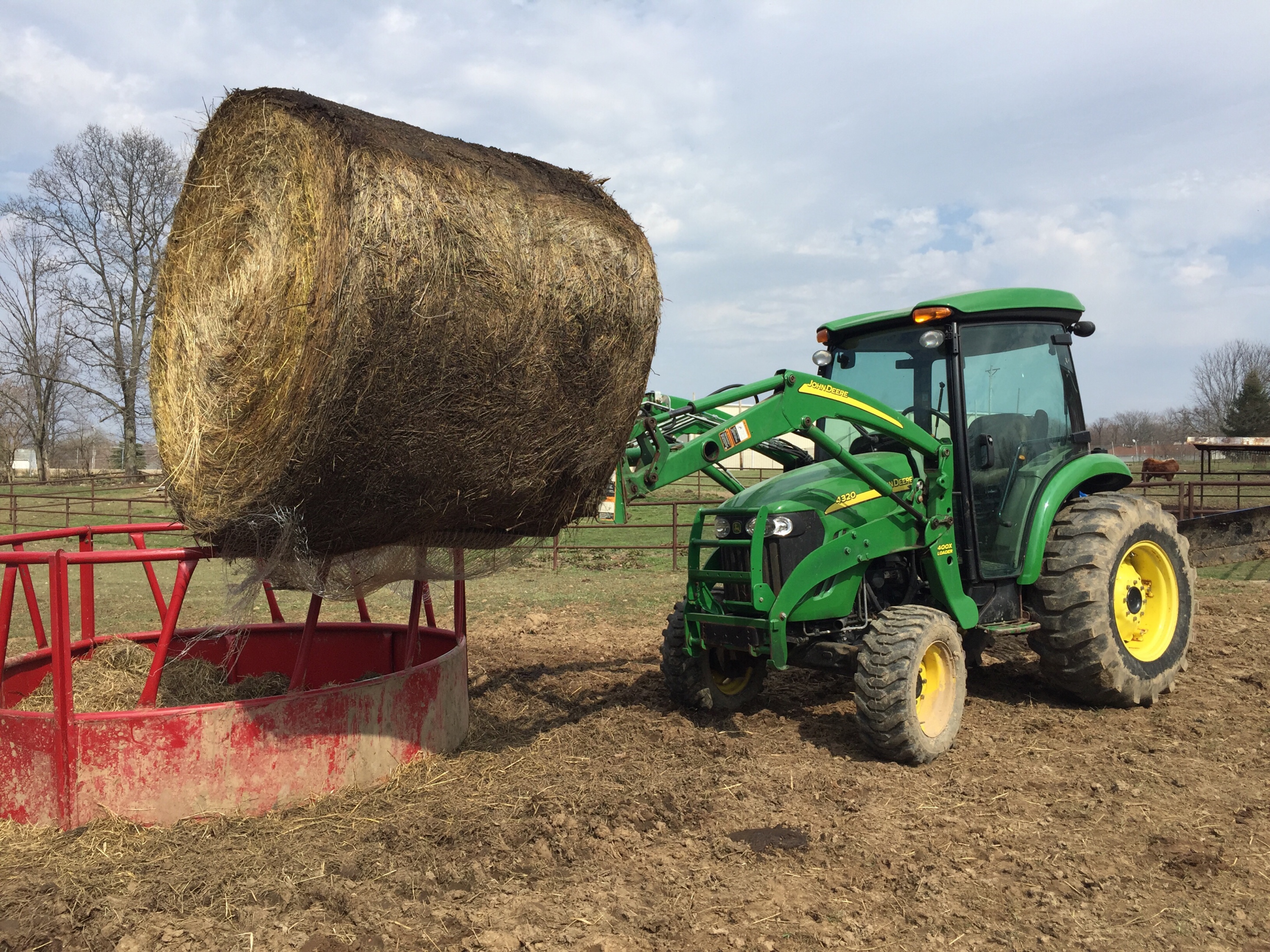

I have only owned my tractor 6 months, put about 30 or so hours on it in that time (now 855h) no issues so far.
I just use mine for FEL work feeding cattle round bales and such, I have to run my tractor down the road once or twice a month in high range to work it lol. I'm not the one to ask on longevity. But it doesn't matter what color it is, eventually it will break down. IMG_7252.JPG
