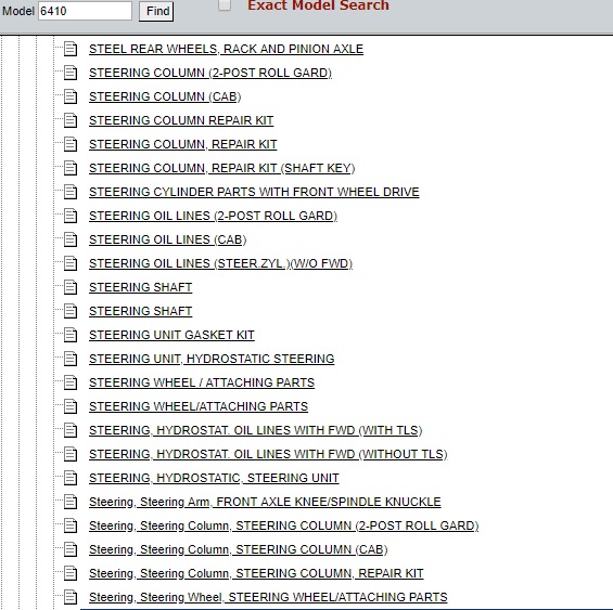

I need to reseal the steering cylinder on my 6410. How do you get the cylinder removed from the axle housing?
/ 6410 steering cylinder removal #2
hozjob
There are different options for the 6410, and a screen shot of those from jdparts is shown here. A pic of what you have also may help, but more info possibly needed.
AL113744 is the part I'm trying to remove
/ 6410 steering cylinder removal #4
Ahh, see it. And nut key#1 or #3 won't come off?
