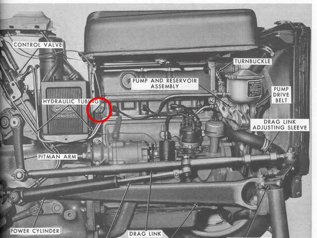

I am trying to install a new temp gauge but the previos owner cut the cable to the block. I have been unable to find where to hook into the block for the temp sensor. Does anyone know where this would go or have a pic or diagram?

I believe it is the same place as on my NAA model. That would be on the right side of the engine near the rear, just in front of the battery box. I'll check for sure and post back in the morning.
EDIT: Yes, its at the rear of the engine head inline with the spark plugs and just in front of the battery box. The original probably had a bulb in the engine and flexible metal tubing running up to the gage wrapped in a wire spiral for protection.

Here's a scan of a photo showing power steering components, but it also shows the location of the temperature probe (circled in red).

I looked there and did not see anything. I removed the battery and looked all across the back of the engine and did not see anything that resembled access to the block. Everything else on the diagram you posted looks identical to my engine except that component

I had a '64 Ford 4000 industrial and I swear the temperature probe was right there on the back of the head. as shown in the photo. Your profile says you have a '68 4000 Industrial. Is it possible you have a typo in your thread title? If your tractor is a '68, it might have a different head without the port for the temperature probe. :confused:
BTW: Are you aware that the temperature probe and gage are NOT electrical? There is a bulb that screws into the head and a tube that runs up to the gage. If there is anything electrical, it might be a light that can be installed into the gage for night viewing. If your gage was removed, the head might just have a plug installed where the bulb previously was.
That photo shows the exact location of the temp sender in a 134,144, 172 or 192 cu.in. Ford 4 cylinder engine. There is a provision for the sender to be installed there, no doubt.

Well you guys are correct. It was behind my ground wire so I didnt see it on the corner by the plugs. I was able to get the new temp gauge installed thanks to everyone that gave me input.
