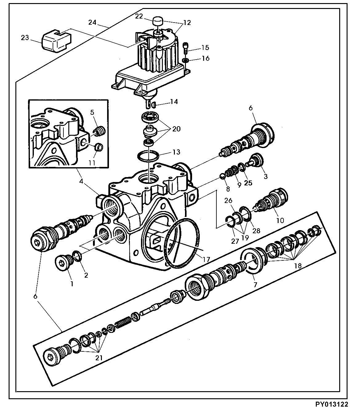

Hi . does anyone know where to connect free Hydraulic return on 6000 20 series . i am running hyd motors that need free return (not through remotes). 6000 10 series has a port but 20 series have changed ! Any thoughts ?

They should have the new "power beyond" kit that has the regular loop that intercepts the full pressure line from the pump to the rockshaft. Plus it has a third line that dumps directly to the sump. That third port is where you want to connect your open return.
I have seen this on 3x20,4x30 and 5x20 so I am assuming it is the same for the 6x20.

Can you tell me where the 3rd port on 3x20 enters the sump? I have no power beyond but need to run a zero restriction return on my Clemens weeder. I can't find pictures anywhere.

On your rockshaft valve, as viewed from the back of the tractor, you want the right port. It has Plug Key 1 and O-ring key 2 in the drawing.
