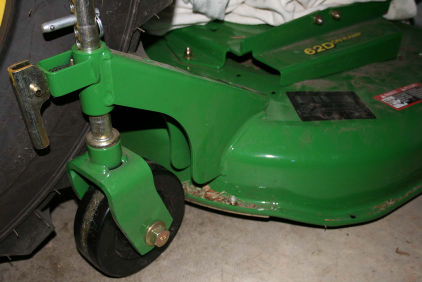

When you get it, check to see if the front wheels on the mower are rounded or still have the squared edges. This will be your first clue if anything has changed. JC
   / 62D MMM Creating Divots with Front Wheels #72
Does anyone have a part number for the rounded wheels?
   / 62D MMM Creating Divots with Front Wheels #73
I don't have a part number for the wheels. I just kept telling my dealer how unhappy I was with the mower. Finally they did a dtac on my tractor and Deere sent me the wheels. They have bearings just are not drilled for the zerk fitting. I installed zerks on the shaft and that makes the wheel swivel much better. Supposedly Deere has done this for others, but not me. JC
   / 62D MMM Creating Divots with Front Wheels #74
This might not help the situation but my 62 MMM does have offset wheels. Is this the new model or something. I purchased it in January. I dont have the divit problem described in this thread, although I do find it a knuckle busting experience getting front bracket to attach to 2520 tractor. IS there a fix for this problem?
   / 62D MMM Creating Divots with Front Wheels #75
Your mower is just like mine. If your lawn is flat you will not have the divot problem. My lawn is not flat.
I have not had a problem attaching the front bracket on my 2320.
