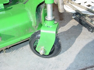

I just got mine back after the update, as this winter was the perfect time to get it done. Four new wheels and grease fittings on the front swivels. They told me they did every update that was available. Plus the front shafts had to be replaced as they had slight bends in both of them. Here are some pictures of the wheels and fittings.

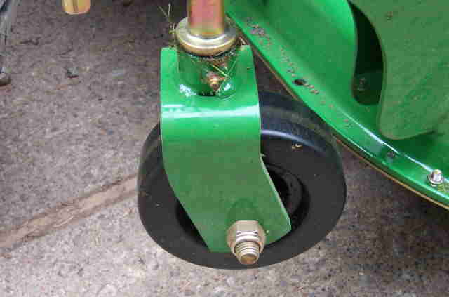

I got mine back in May, it had the grease fitings on the wheels and spindles. I'm not sure if my wheels are the "updated" ones, but I mowed all last year and had no problems..

You have the old wheel. I just bought a 62d last week and it has the more rounded wheels. They almost look like very large roller blade wheels.
