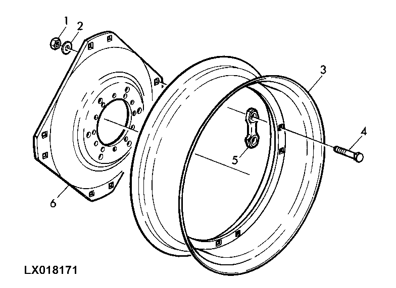

Can you put 12.4 42 tires on a 6230 JD without axles?

Now... if I had to make a "reasonable" guess at what the OP was asking... he's wondering if you can put a larger tire/rim combination on a tractor that has a bolt/hub configuration versus the adjustable axle stub configuration.
Sound reasonable?
Now, I don't know if that particular tire would fit - given the dimensions of the tractors fenders, etc. And I wouldn't venture how that tire size might affect the transmission ratios and the final drive of the tractor.
If you're referring to the type rear axles called "flanged"(similar to photo) that the wheel bolts to with 8 bolts I didn't find a 42" wheel listed in either 6230 parts catalog.
There ya go! "Flanged", huh? (A hub is kinda, sorta similar..) Thanks, Tx Jim.
AKfish
That's what the JD rep's called them at the sales meetings I attended when I worked for a dealer.
