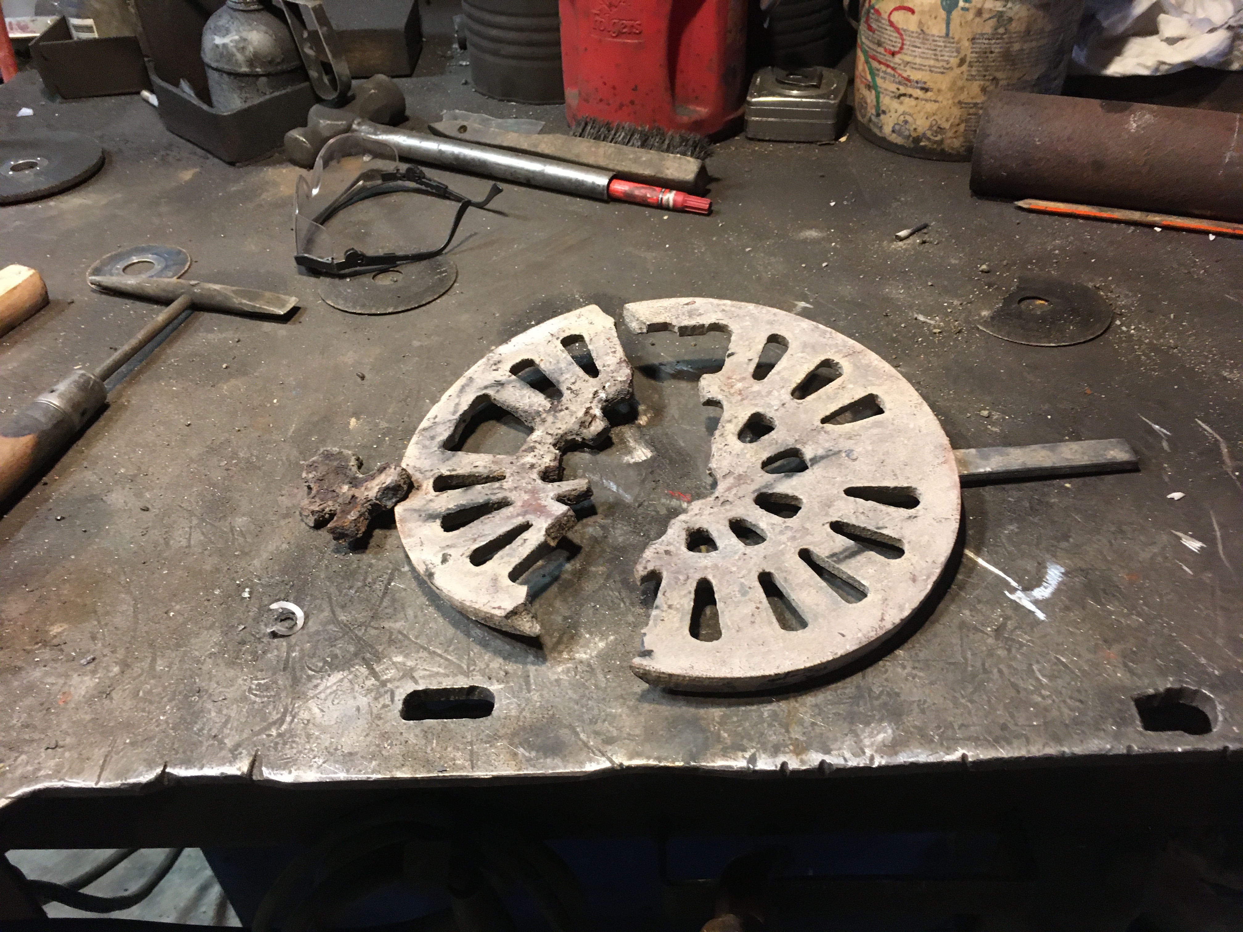

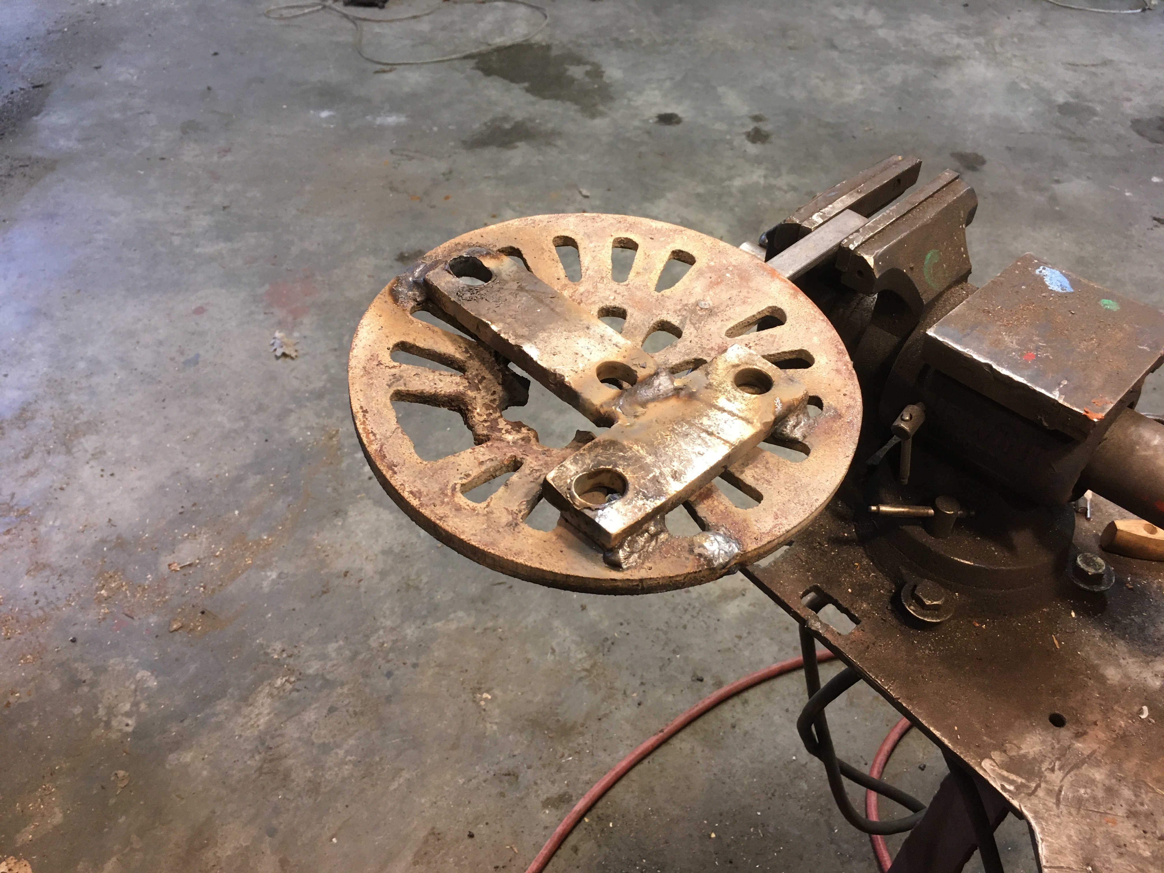

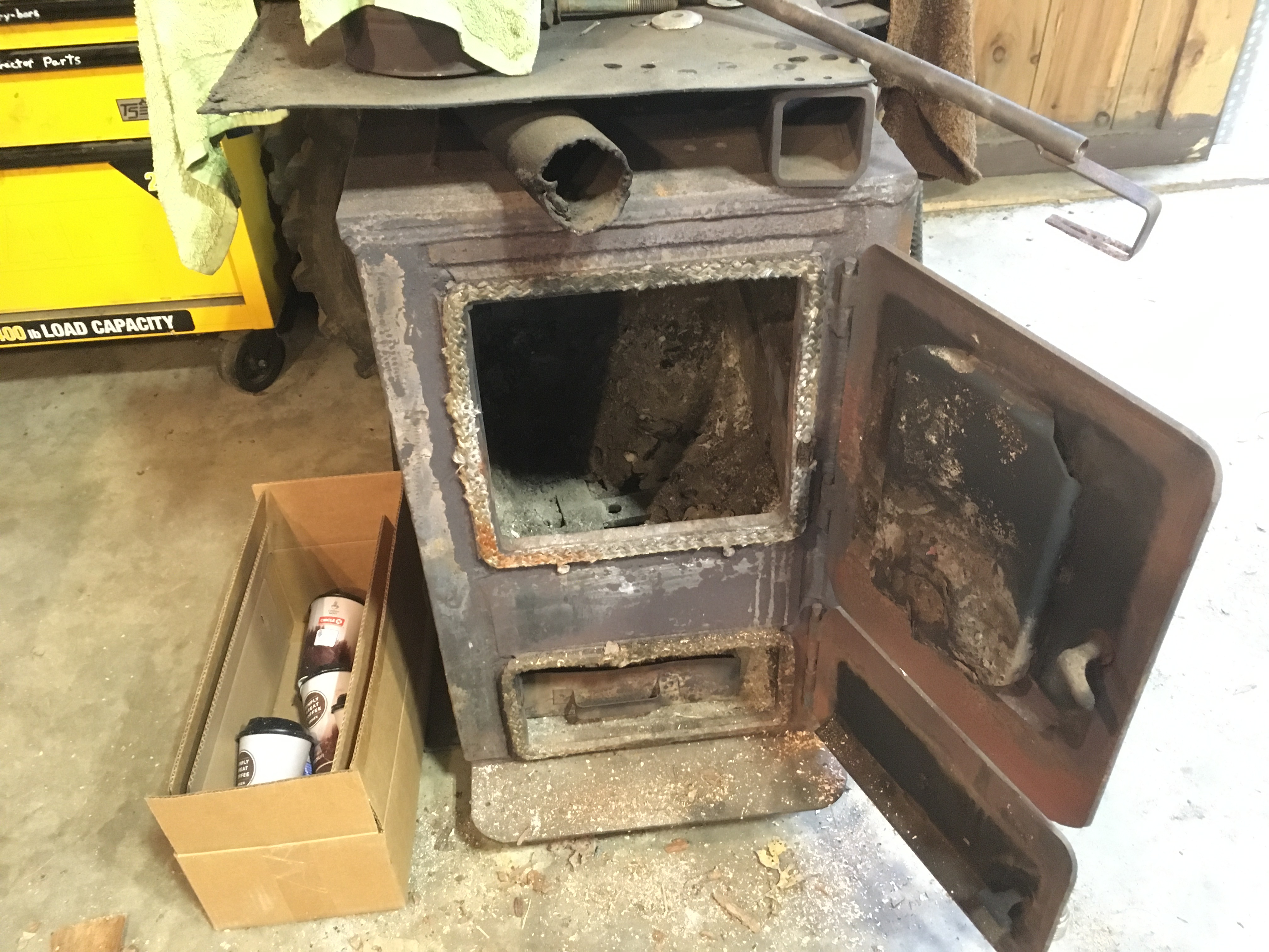

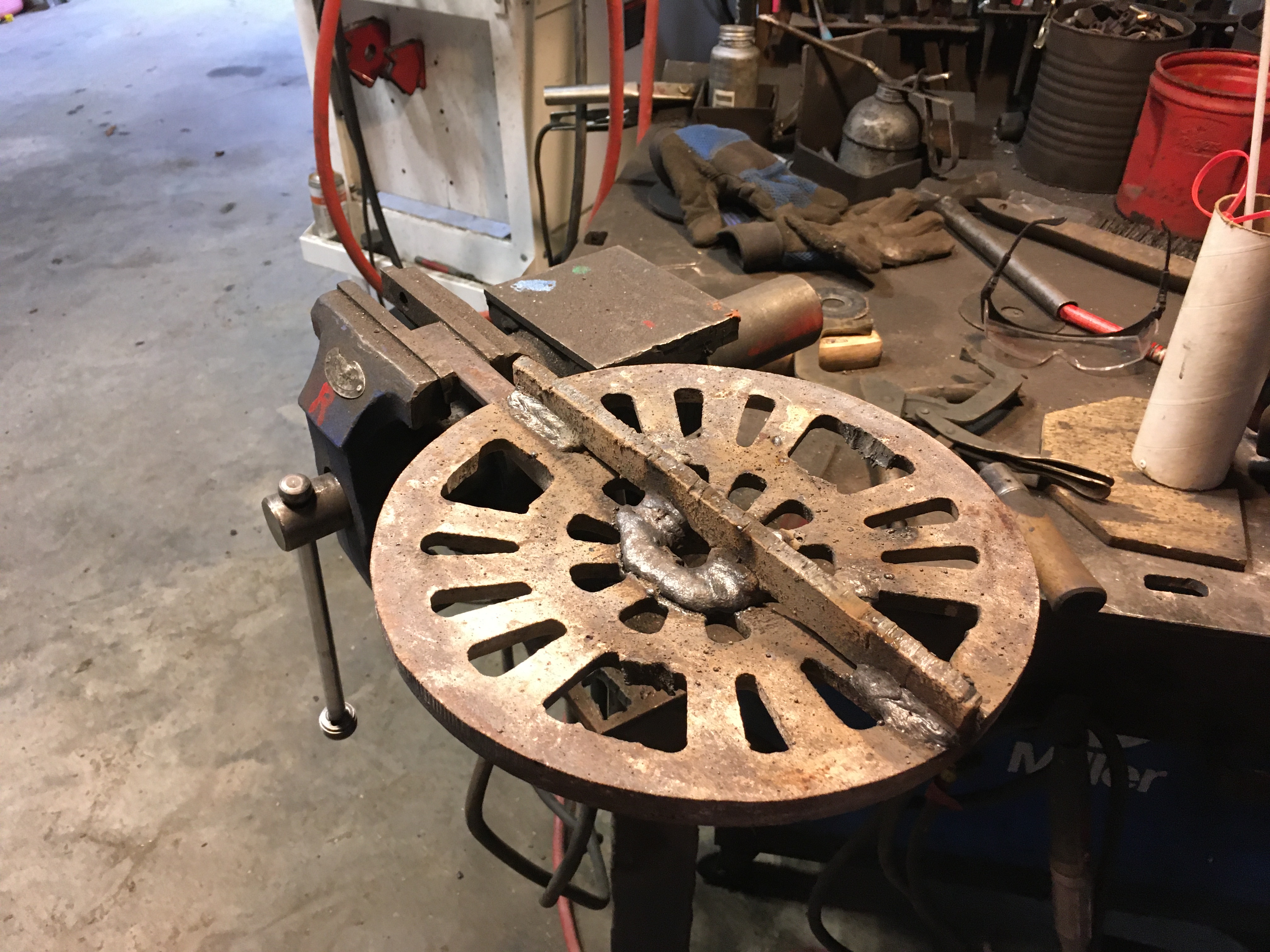

My wood stove grate in the house fell apart this afternoon so I took the one out of the stove in the garage, both stoves are the same, then added a middle brace on then put that one in the house stove, should get me by til the one I ordered shows up. Seem like every two years I have to get a stove grate, maybe 1" thick square stock would last longer.
Then the one that was in the house stove I bubble gummed it back together, the middle like the one in the garage welds terrible but the outer part welds ok for cast iron, I used some scrap steel with 10018 rods, then stuck it in the garage stove. I need to get some cast iron rods but last time I bought nickel rods they was like $2.00/rod
View attachment 675189 View attachment 675187 View attachment 675188
I like that there stuff, Oldpath.
