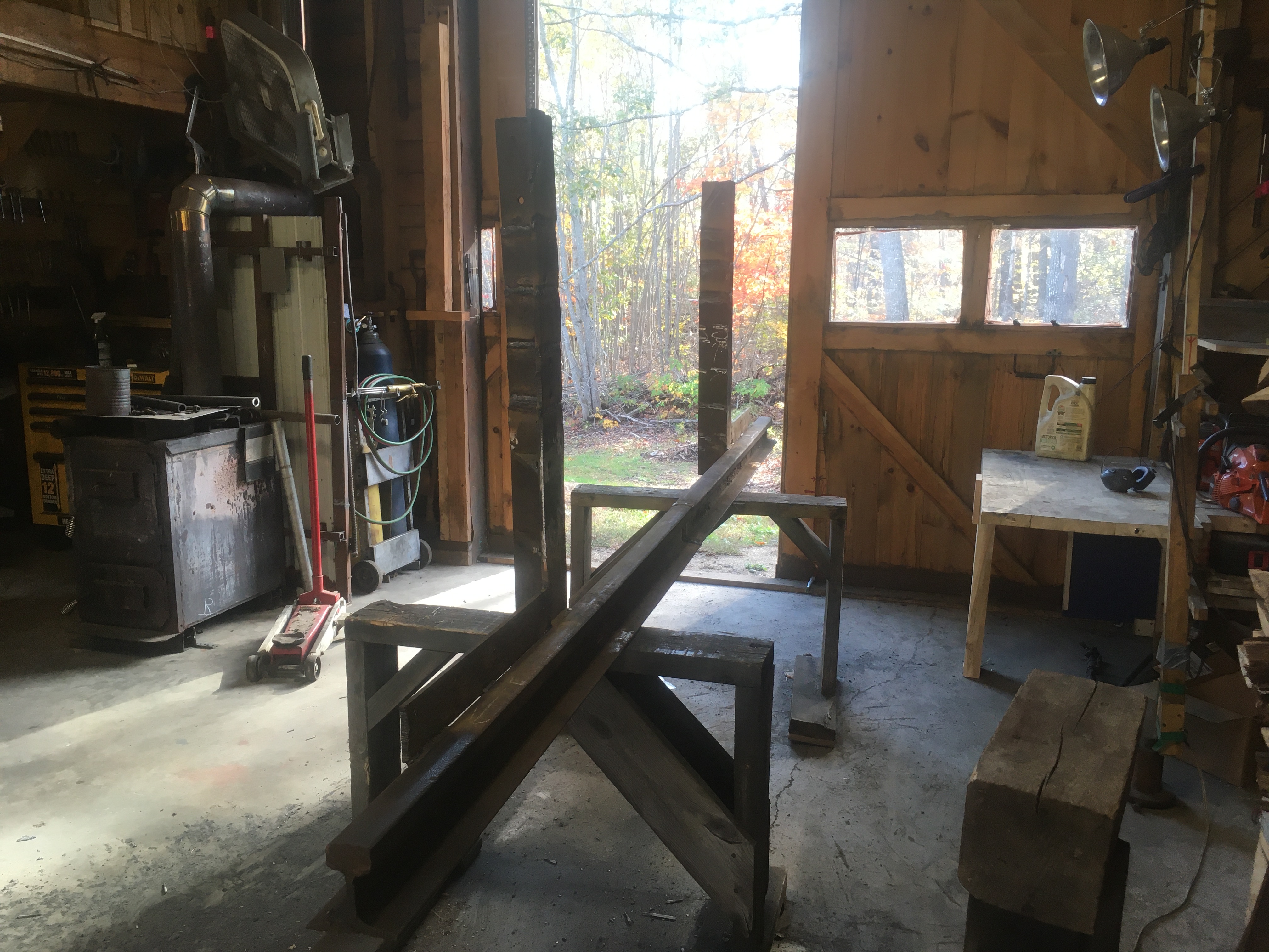

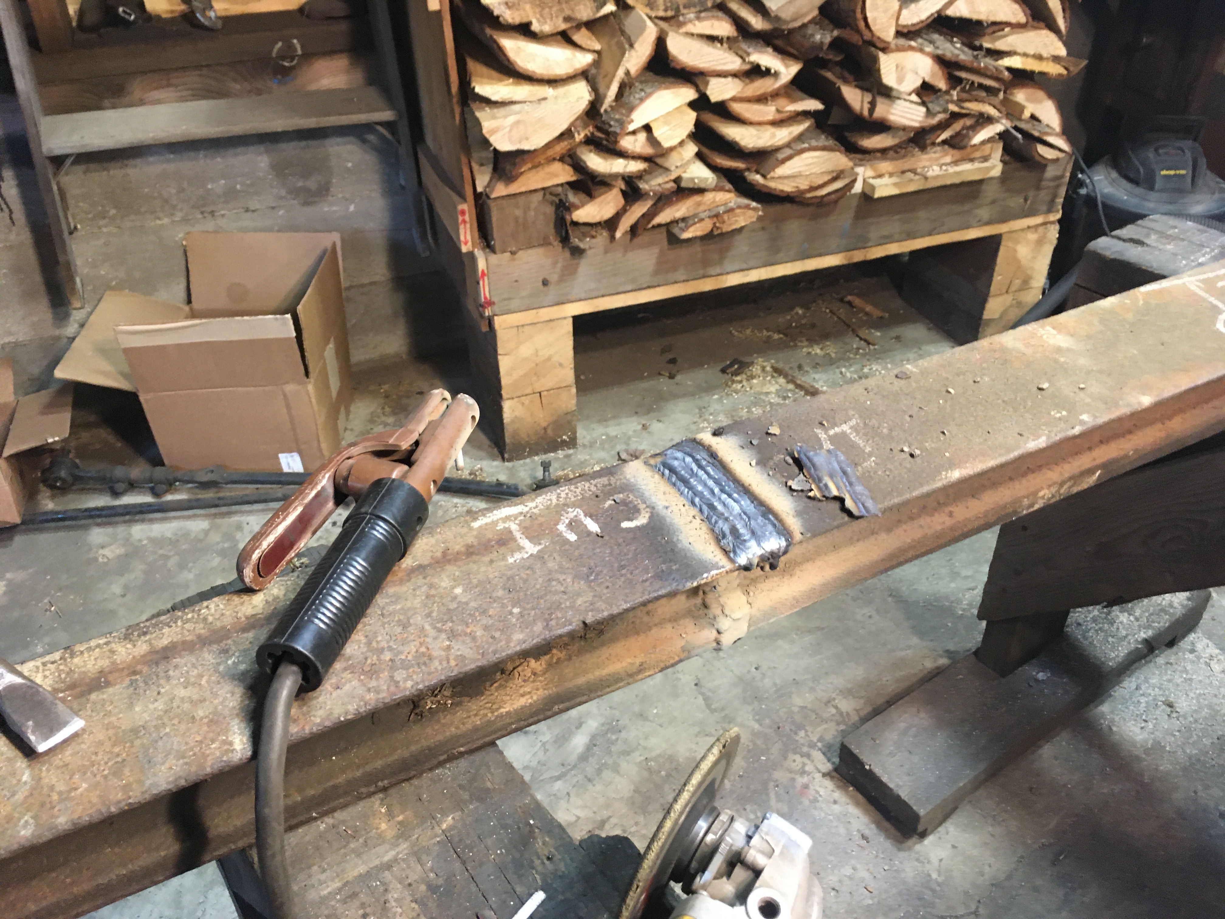

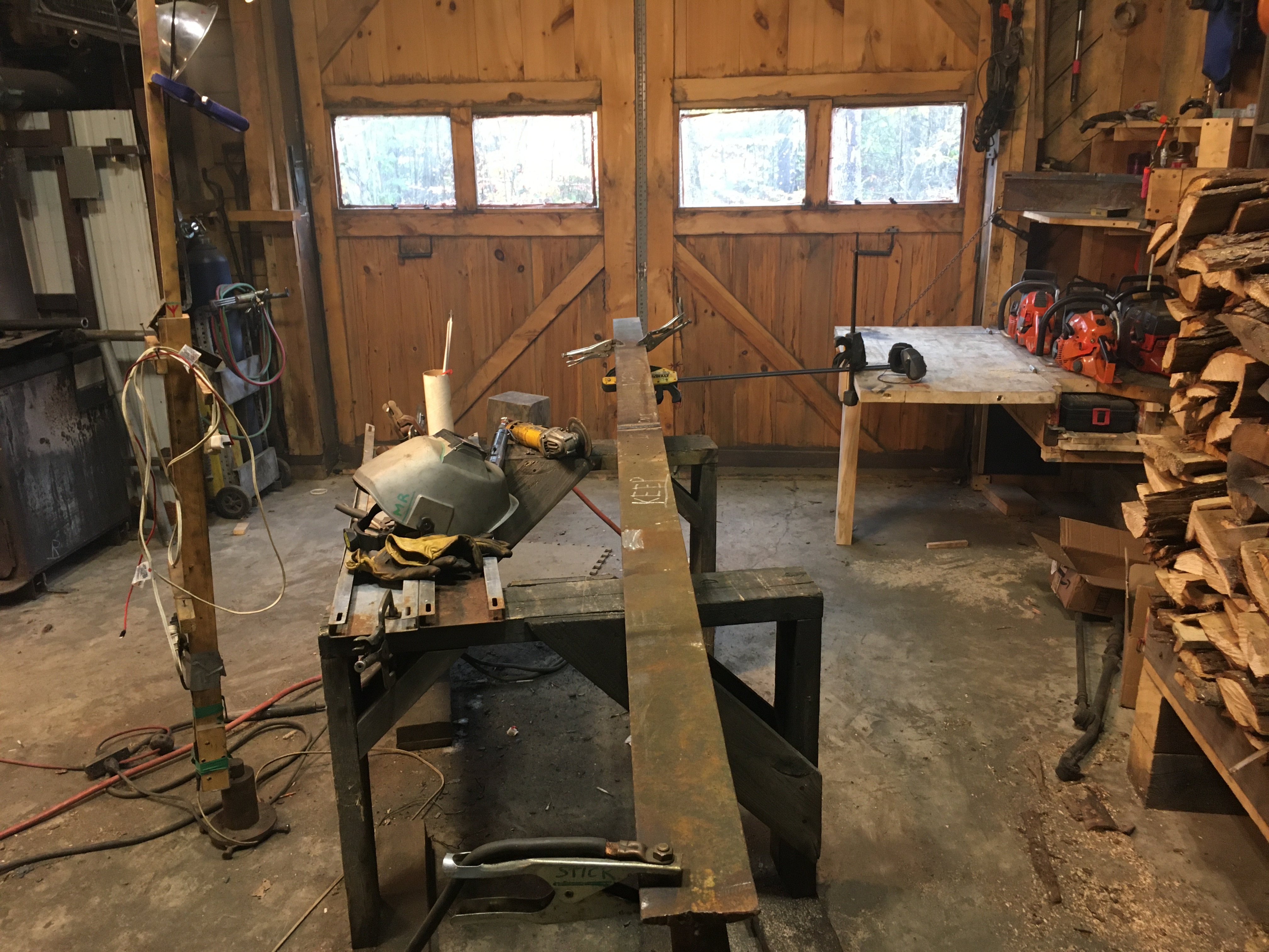

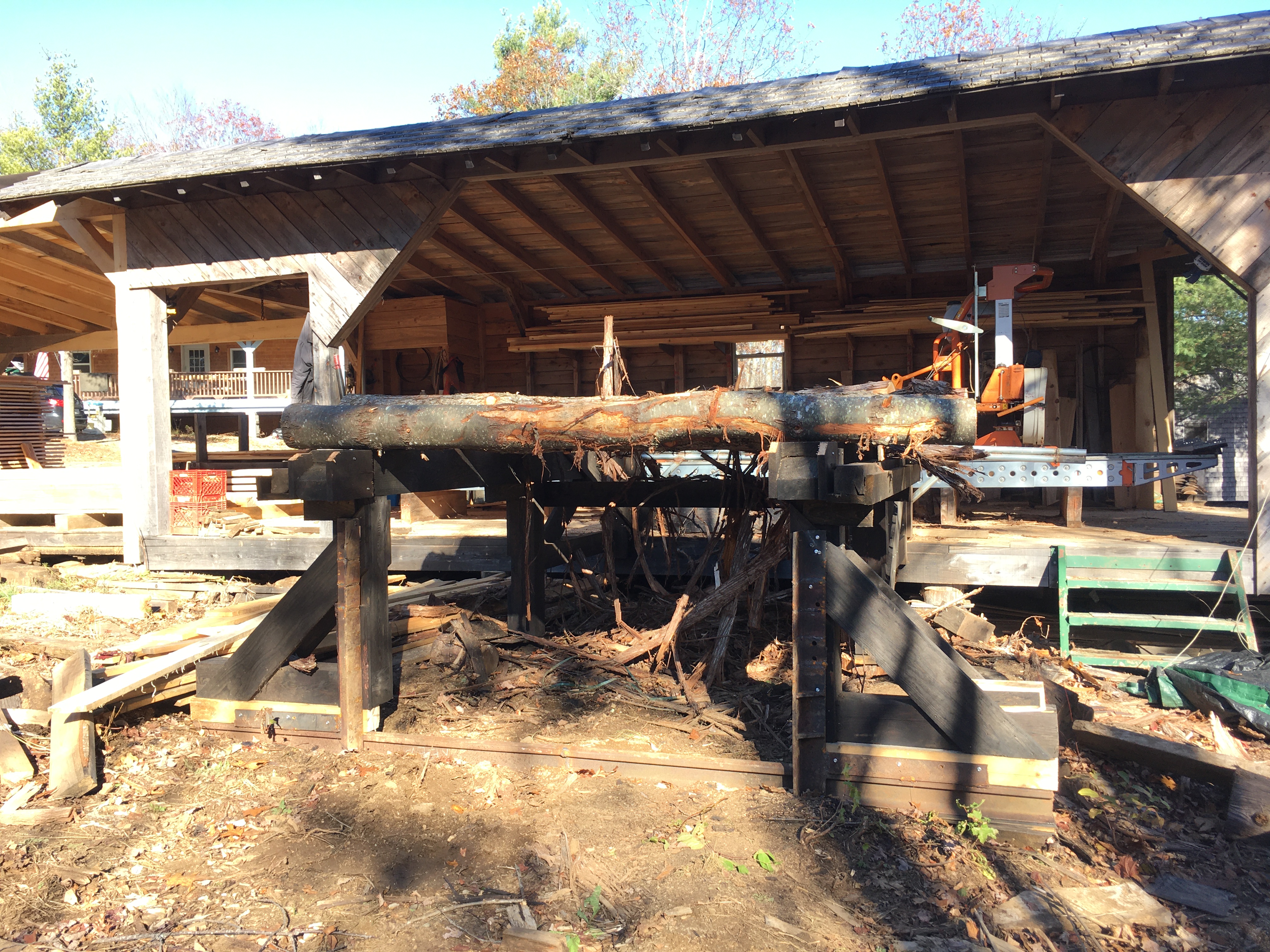

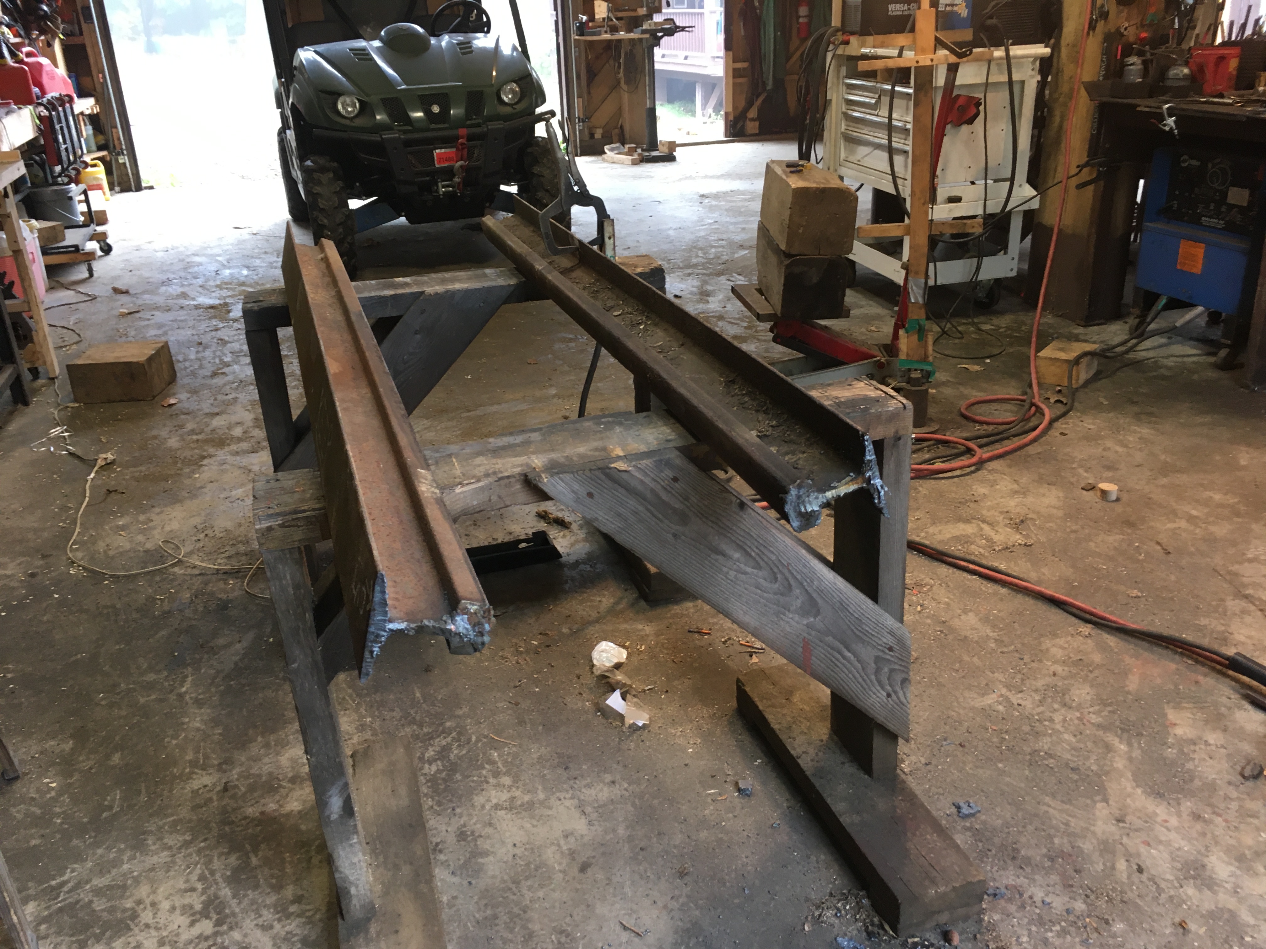

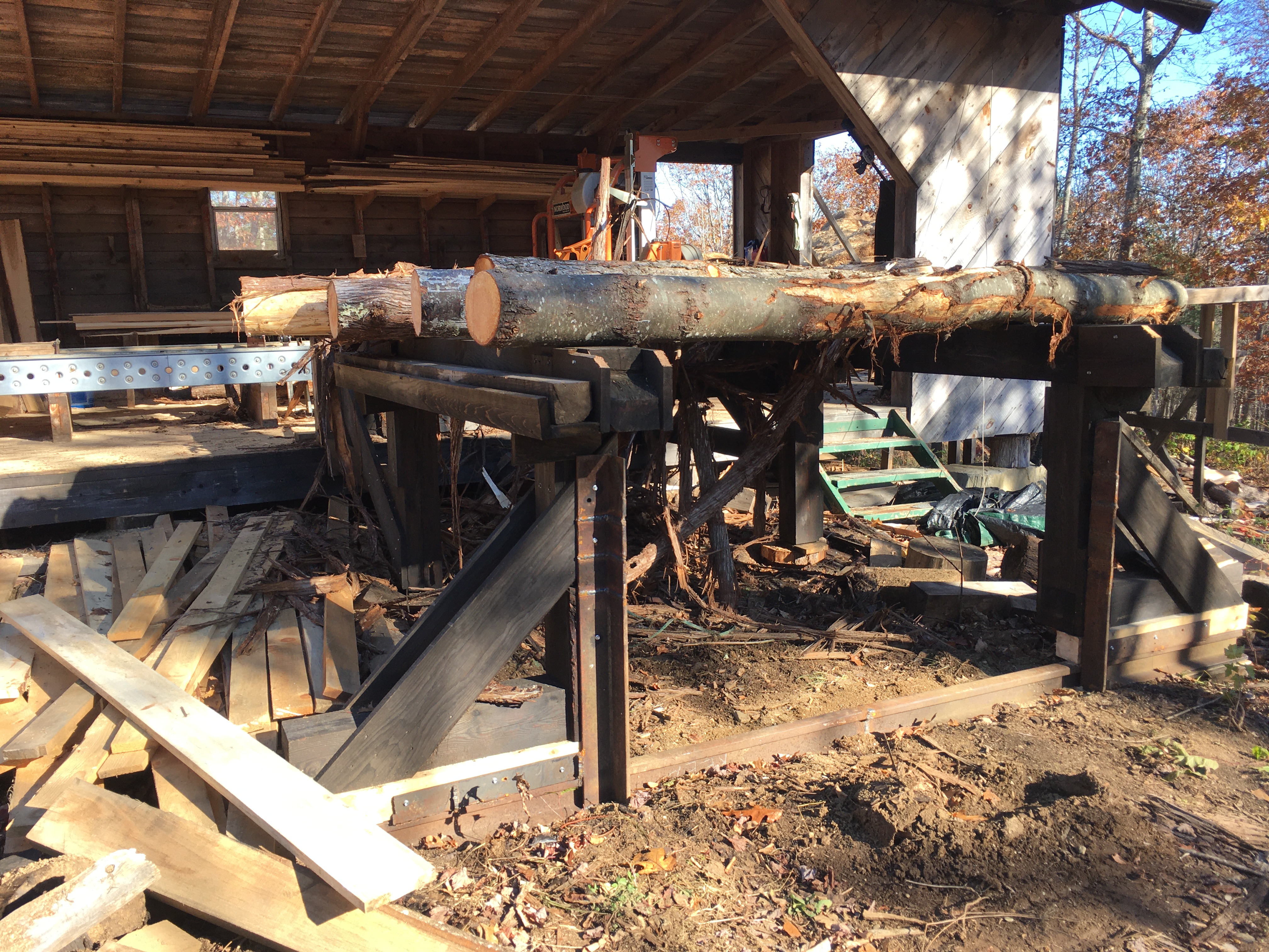

I forgot wear I posted this railroad iron brace welding job I did, but the brace was put in place two weeks ago and tested today.
Back gouging steel - YouTube
Gouging weld off - YouTube
L34OO moving big log - YouTube

Interesting. your welding area is right next to your wood pile.
It's not the welding it's the gouging, grinding and flame burning that I pay more attention to, all of that is pointed to center of shop, not towards the wood pile. Flame cutting outside at certain times of the year can be just as bad around here to, just have to a ware of hot work.
