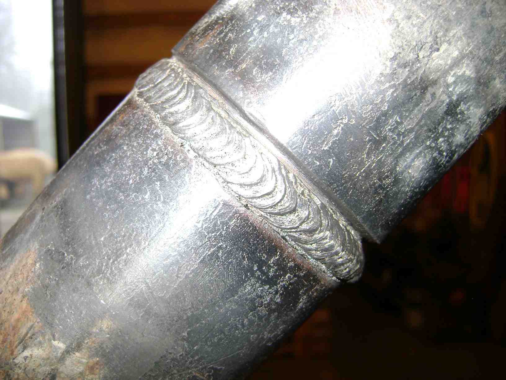

I've never run a PowerArc 160. Don't be surprised if you have to hold a very close arc length, to keep the arc from going out. You have to do this with the PowerArc 200.
   / 6011 help
#15
That's pretty much what I was experiencing.
   / 6011 help #16
It takes a little bit to get use to holding a close arc length. But once you get it, it works fine.
This 6-G pipe weld was done with the PowerArc 200.
