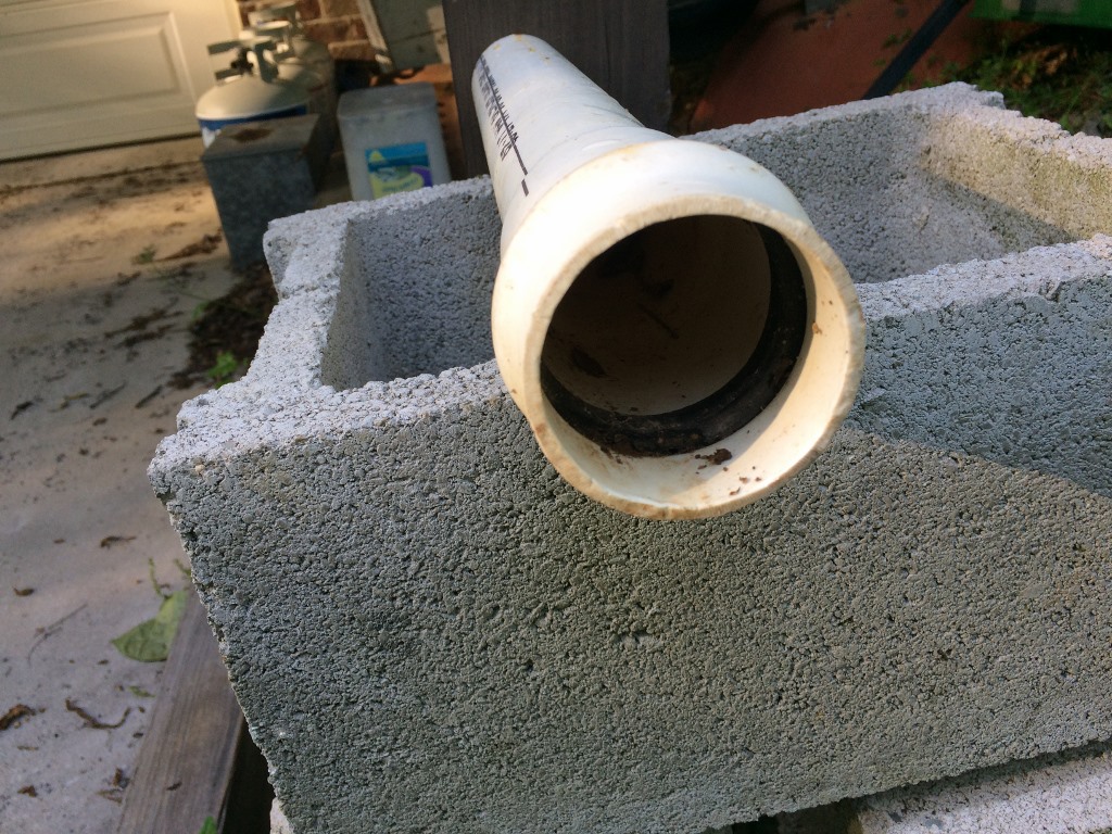

My contractor used the same stuff he runs miles of for the water utility district. SDR21. 20 ft lengths with o-ring joints. Water lines need to be able move just a little. They also put in 3 2" "sectionalizing" valves in little brick underground boxes so we can valve out a specific section for repair if it becomes damaged.
