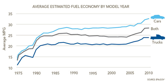

Data is an inconvenient thing. You can easily see that the actual CAFE performance averages are all up 30% - 50% over the last 20 years. This is data, this is fact.
Lol, so smug. You obviously don't realize how complex the CAFE calculations are. Its a system to be gamed by the manufacturers. Edit: sorry, I don't need to be this rude. Having a monday here at work, haha.
Here is the real world performance of mpg in the USA. Yes, it is ticking back up more recently with improved transmissions, reduced rolling losses, better aerodynamics, and increasing hybridization. But the truth is that the combustion efficiency inside the internal combustion engine is not improving much at all.

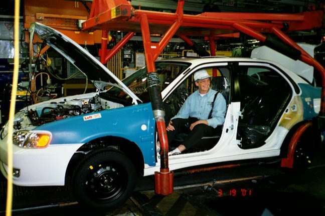

The plant manager was named Don Dees, and he was 100% American.
When mom ordered her one and only new car it was a Toyota Corolla… 2001 model S with factory sunroof.
I wrote a letter to the president of Toyota in Japan asking to see her car being made and received a response with build date inviting mom and me to come to the factory as it was being made.
A person identified as plant manager invited us to the company cafeteria and sat down with us for a few minutes saying he was from Japan and he gave mom a Toyota hat signed by himself and others…
We later received a copy of the company newsletter with a very nice write up of our visit…
Maybe he was the Toyota side of the joint venture?
Super car and many a time over 40 mpg.
The undercarriage is signed by many of the line workers with a sharpie... a true signature edition.
I couldn't believe the red carpet treatment and we witnessed the first start at the end of the line...

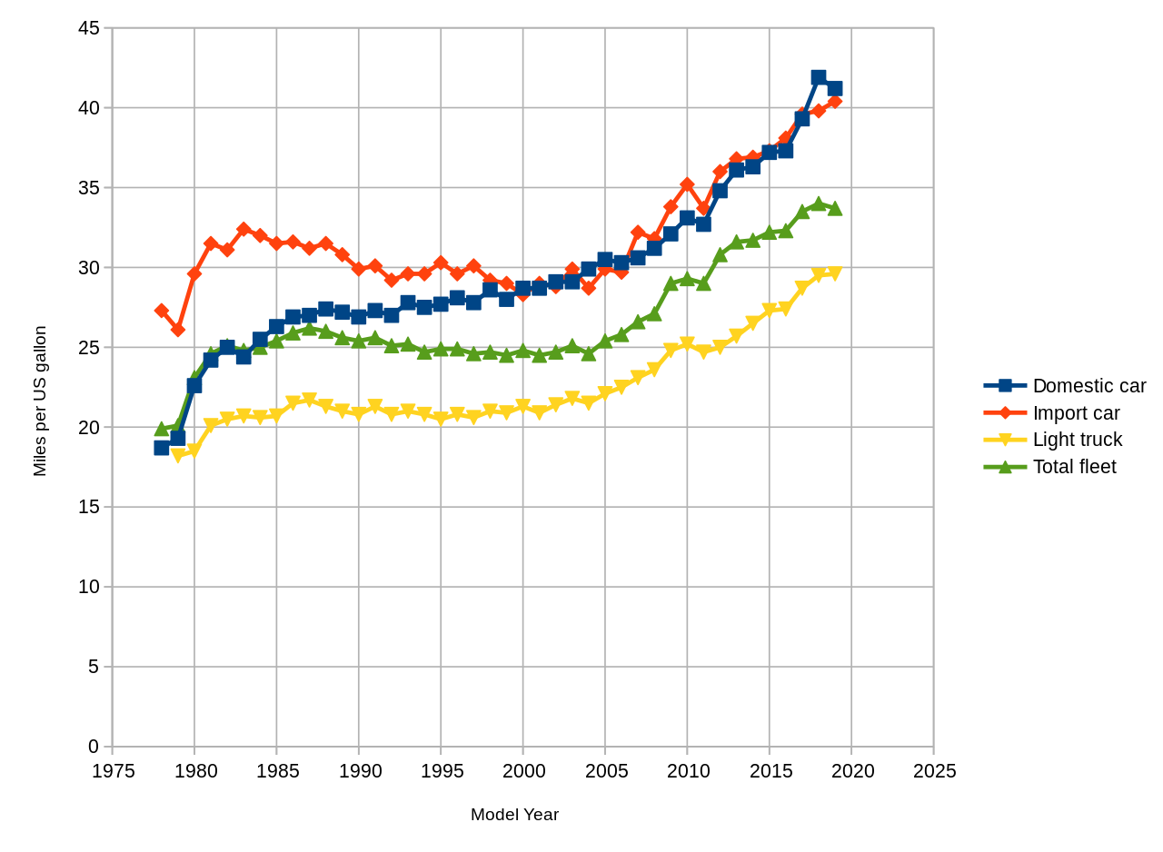

Yeah, sorry that sounded smug. But what's your source for this data? Mine came from NHTSA (link provided). Clearly they're using a different basis for calculating average MPG, assuming both are honest graphs.

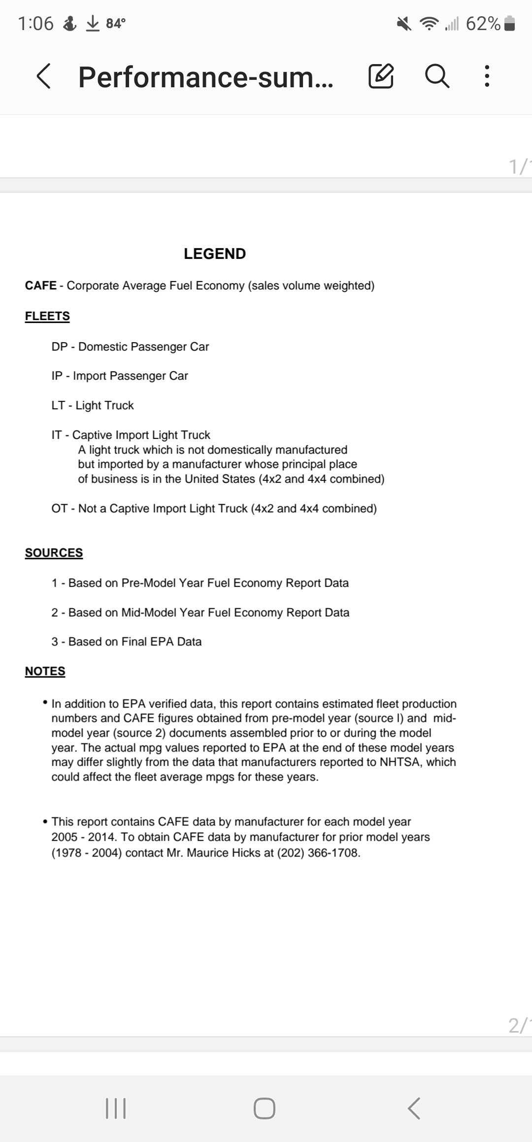

Here's part of the problem...excerpted from the report that goes with your graph.
This is just effectively an average of the mpg of those broad classes as reported by the mfg. The numbers will get better if the market (no necessarily sell) smaller, more fuel efficient vehicles. Want to sell more Tundras? Put some additional Prius models in the fleet.
The other data is actual engine performance.
So, they way I am seeing the data, yours is easy to manipulate just by selling more 4 cylinder or hybrid cars. Deezler is looking at the engines themselves and comparing if a given 4 cylinder get better mpg today than it did X years ago.

I said "20 years", not 60.
I said 1966 and you changed to fit your narrative.
But I should have more artfully articulated that actually, a major reason that overall american vehicle mpg is flat for decades now is because the vehicles themselves have gotten bigger and heavier, accounting for our consumer demand and safety requirements.
So you admit vehicles are getting more efficient in spite of emissions regulations. Not a question.
My 2018 4x4 F-150 is much bigger, faster, capable, and nicer than the 2001 Sonoma I had. MPG is better in the F-150. No doubt the F-150 meets more stringent emissions standards.
Edit: So not only is my F-150 more economical, it is much more efficient doing more work with less fuel.
