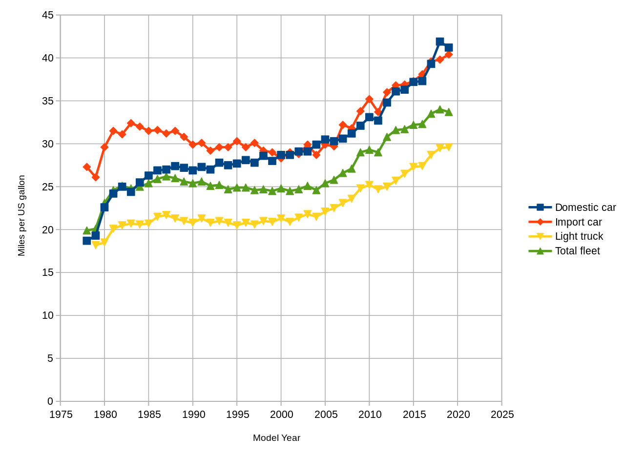

Eh, the efficiency part of your argument is debatable. Look at average vehicle mpg by year. Flat for 20 years now. There's no denying that emissions control has hampered internal combustion efficiency, especially for diesels. I still vote for the cleaner emissions and same efficiency, personally. Otherwise all our cities would be disgustingly smog choked, every day.
Ok, you placed the bet, I call, show your hand. How is there any doubt today's automobiles are not more efficient than in 1966 when there was no smog control?
1966 VW Beetle might get 30 MPG! My 2016 Subaru Outback's 26,338 mile average (26,338 miles divided by 908 gallons purchased, you can't average averages) is 29.06 MPG after a 550 mile 24 MPG hit driven by a lead foot brake/accelerator friend. My Subaru is a much nicer and larger vehicle than the Beetle.
OK, I decided to look it up. 1966 VW Beetle average 20.41 MPG: 1966 Volkswagen Beetle MPG - Actual MPG from 21 1966 Volkswagen Beetle owners
2016 Outback is 24.69 MPG at 2016 Subaru Outback MPG - Actual MPG from 561 2016 Subaru Outback owners
Outback is PZEV emissions rated.
   / 58 MPG by 2032 #529
I said "20 years", not 60.
But I should have more artfully articulated that actually, a major reason that overall american vehicle mpg is flat for decades now is because the vehicles themselves have gotten bigger and heavier, accounting for our consumer demand and safety requirements.
Nonetheless! Avoiding formation of NOx in combustion is a direct trade off for combustion efficiency - for both gasoline and diesel. We don't need to debate this basic fact, the tighter the emissions regulations get, the less efficient combustion can be in the cylinder given current and standard ICE technology. Measuring this trade-off in the dyno lab is my day job.
   / 58 MPG by 2032 #530
Data is an inconvenient thing. You can easily see that the actual CAFE performance averages are all up 30% - 50% over the last 20 years. This is data, this is fact.
