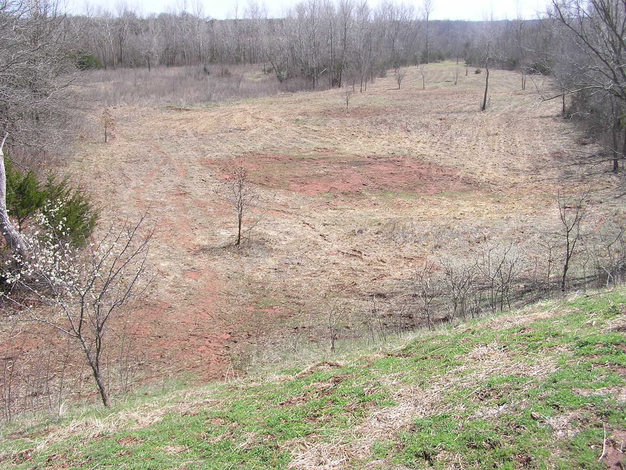

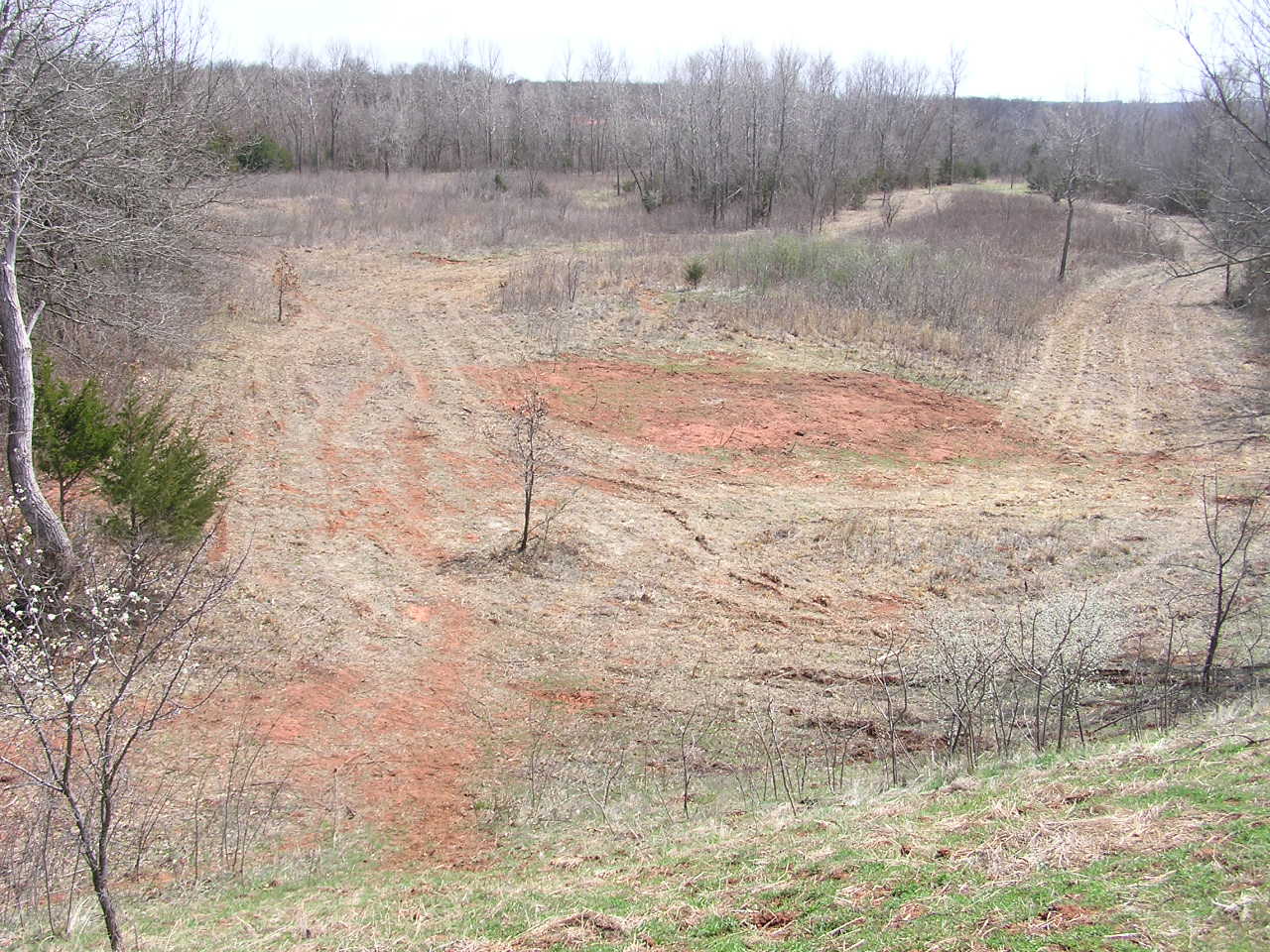

Hope the grass grows, horse pasture.
Well the grass, brush and weeds grew, but not good pasture grass. It would make good goat hay! :laughing:

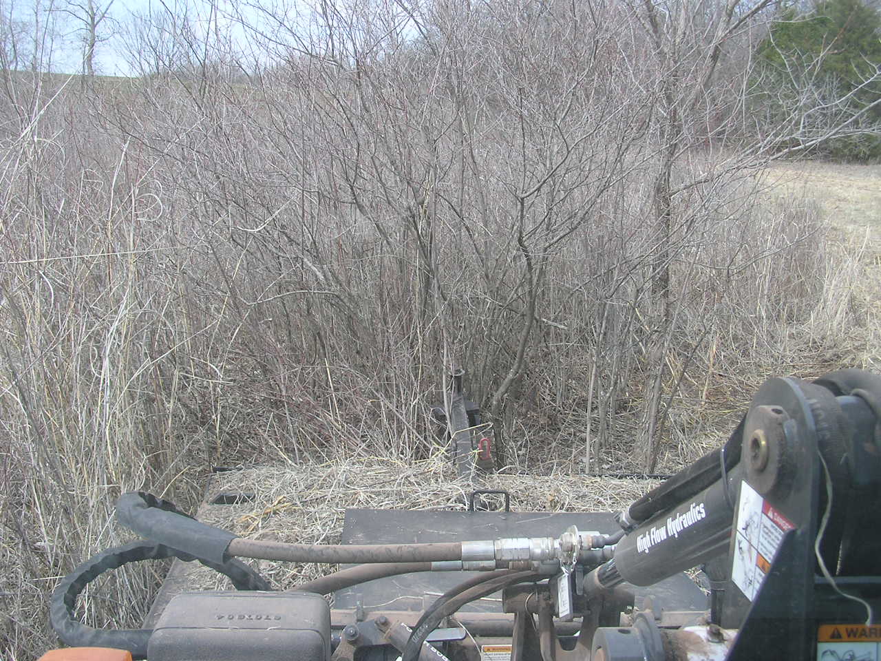

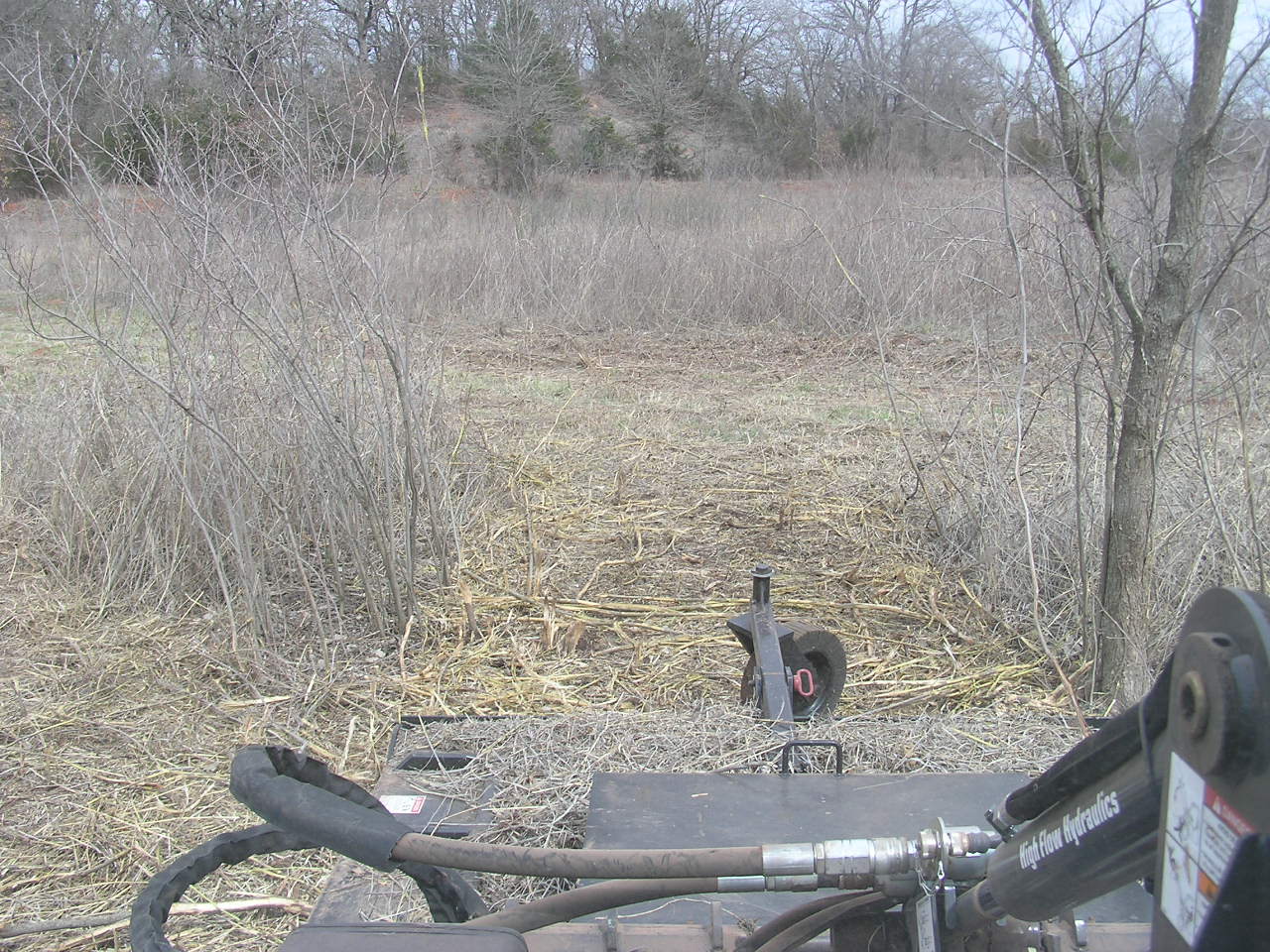

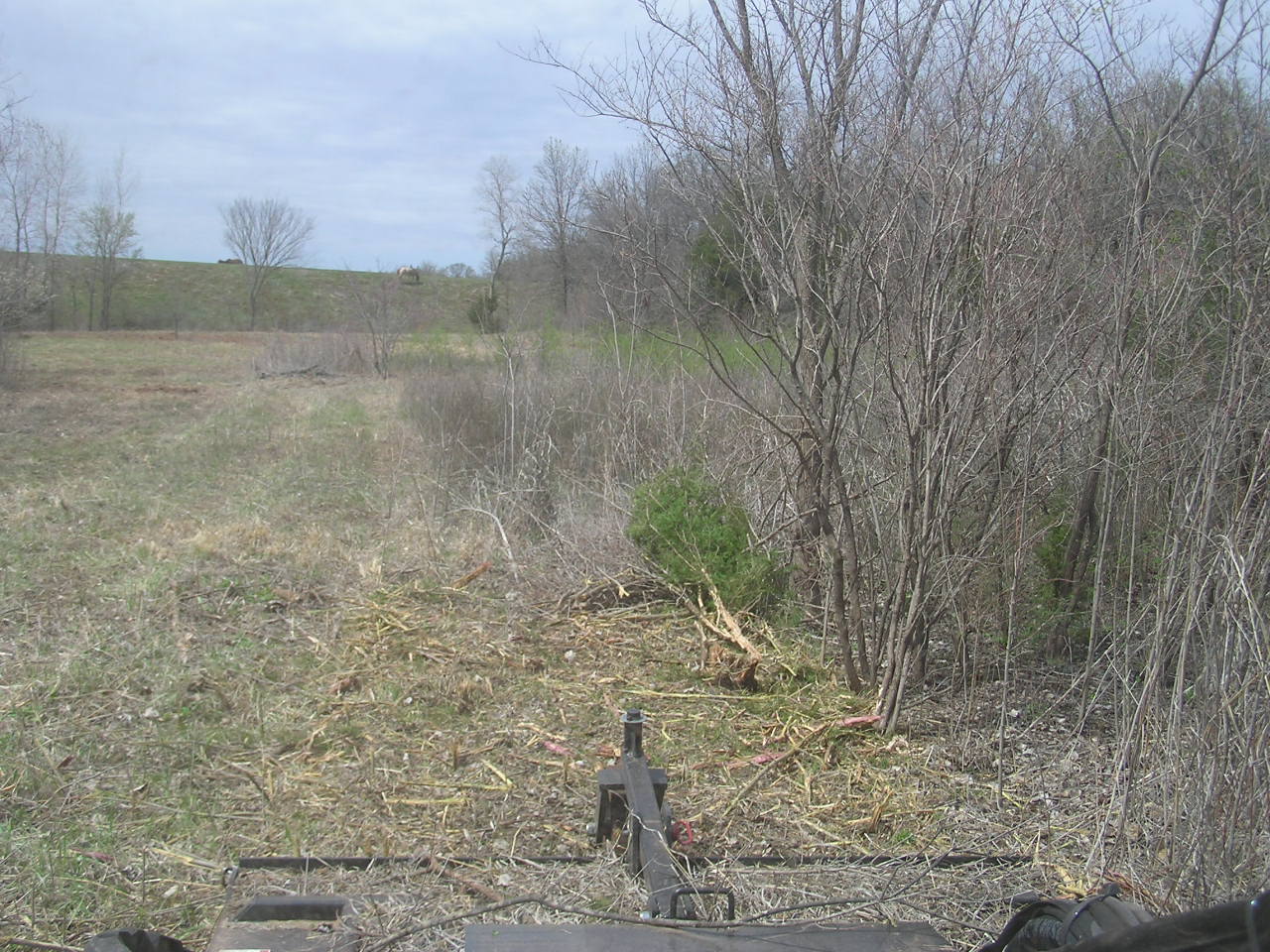

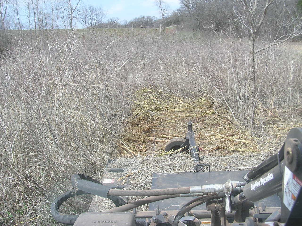

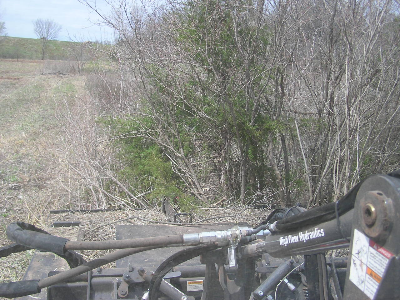

The view from the seat.
The A/C kept it cool inside. It was 95 outside! :thumbsup:

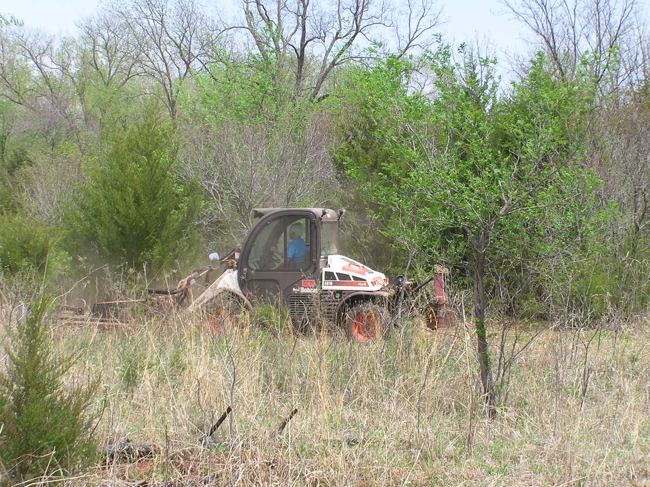

Some pictures of my wife cutting brush with the Toolcat. :thumbsup:

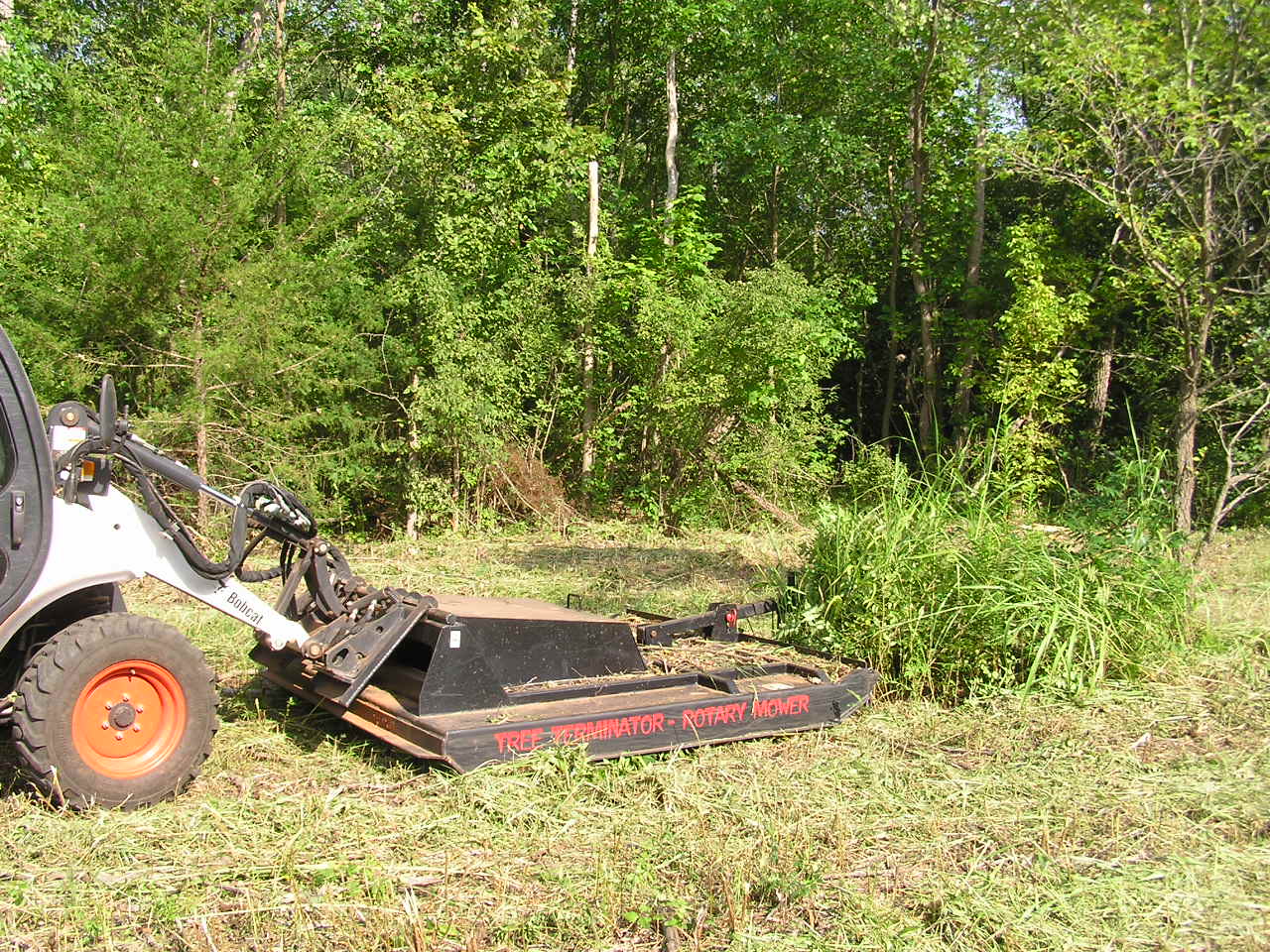

Got some better pictures of the brush hog.

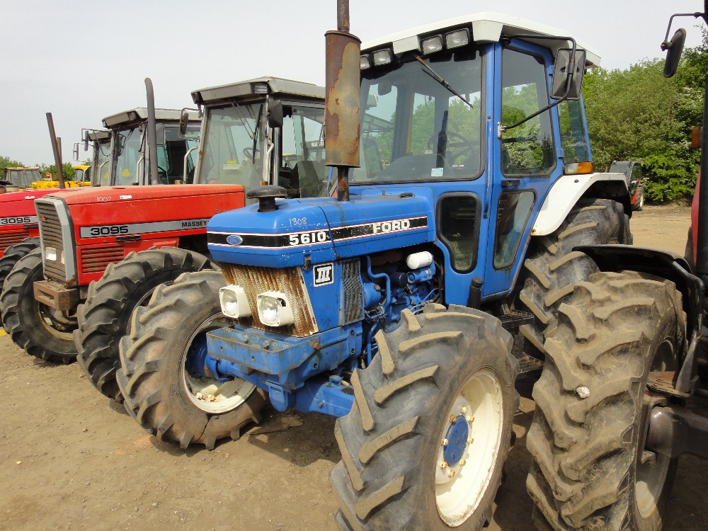

When I saw the title I was expecting to see a big blue tractor, lol
/ 5610 cutting brush. #39
Like this one? <img src="http://www.tractorbynet.com/forums/files/toolcat/405527-5610-cutting-brush-1308-jpg"/> Pictures from Google Image Search.
Yes sir

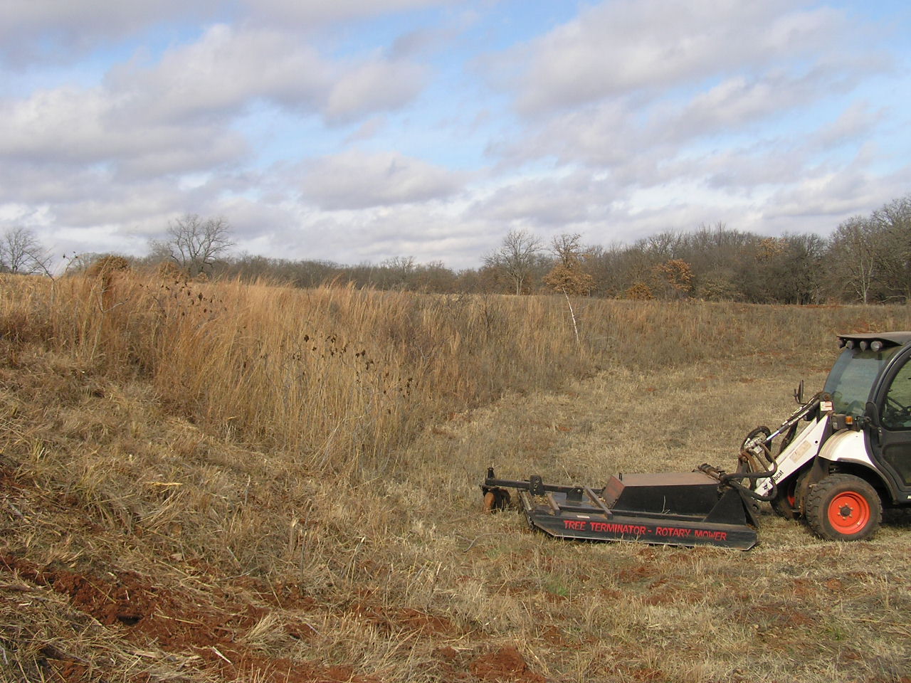

Found some old pictures of cutting brush in the spillway:
