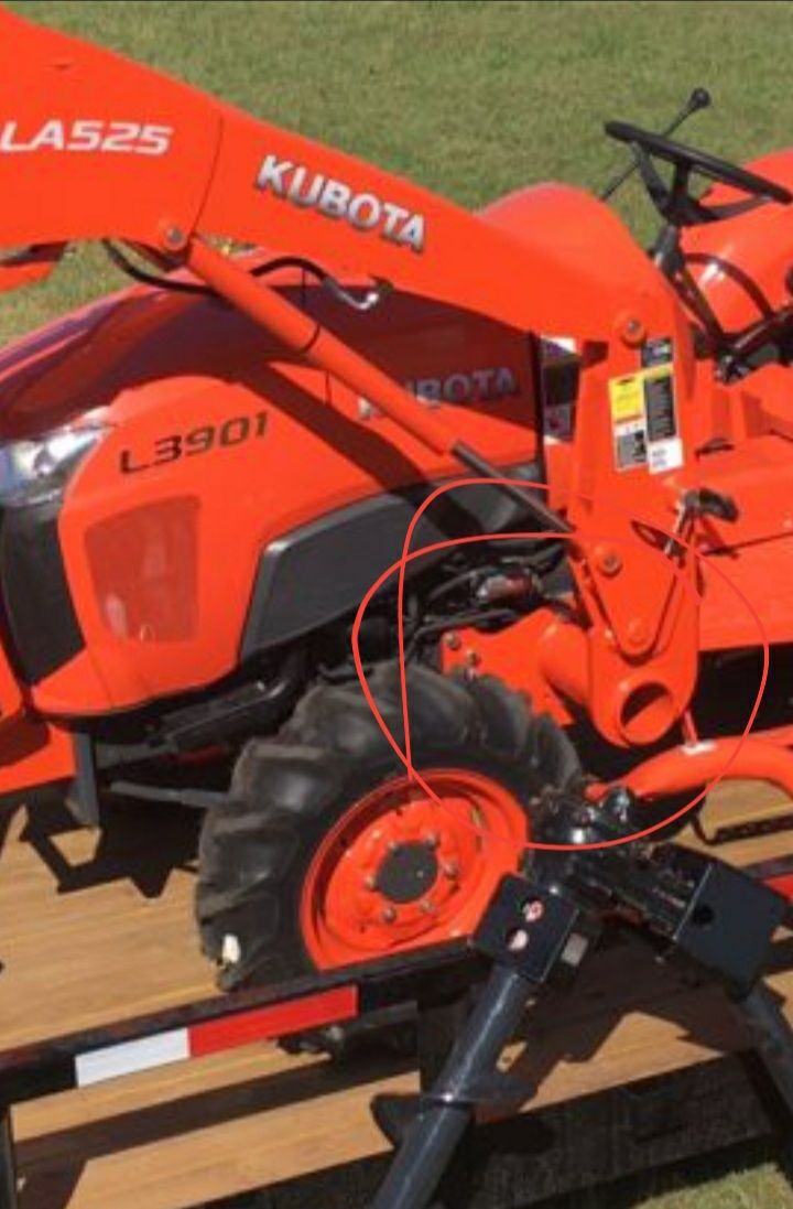

Not sure which specific part of the loader you were referring to comparing 1/4" tubing to 3/4" plate....but for what its worth....
2x4x1/4" tubing is stronger in every direction including torsion when compared to a slab of 3/4" x 4" plate of steel.

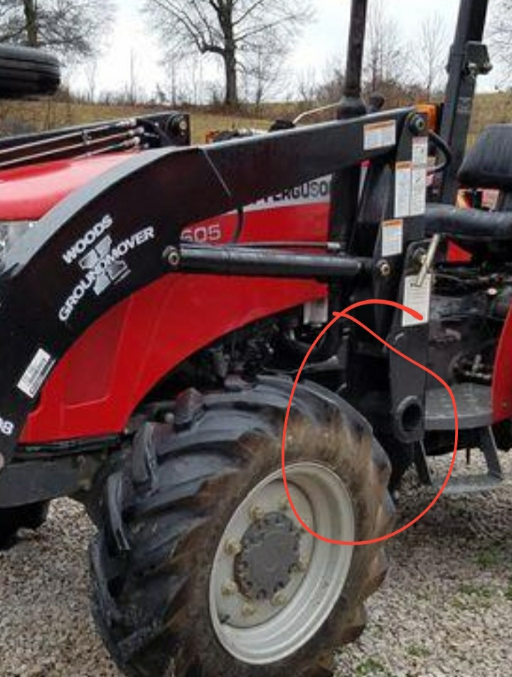

With the reference to 3/4" plate I was referring specifically to the interface between the loader and the tractor. It is hard to find good pictures of this on the internet but I did my best (hence why recommend looking in person).
I see what you are referring to. That said, that is an area that I seldom if ever see reports of failure. Loader arms, yes. Loader mounts, not so much. I would trust 3D CAD Modelling and Finite Element Analysis, before I would rely on a tape measure and intuition to determine strength under load.

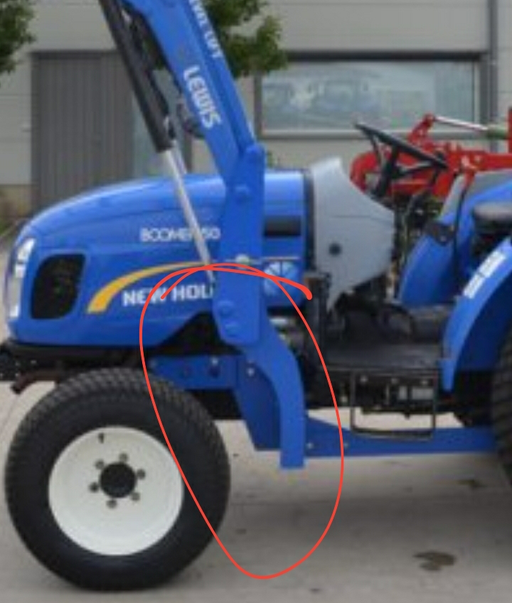

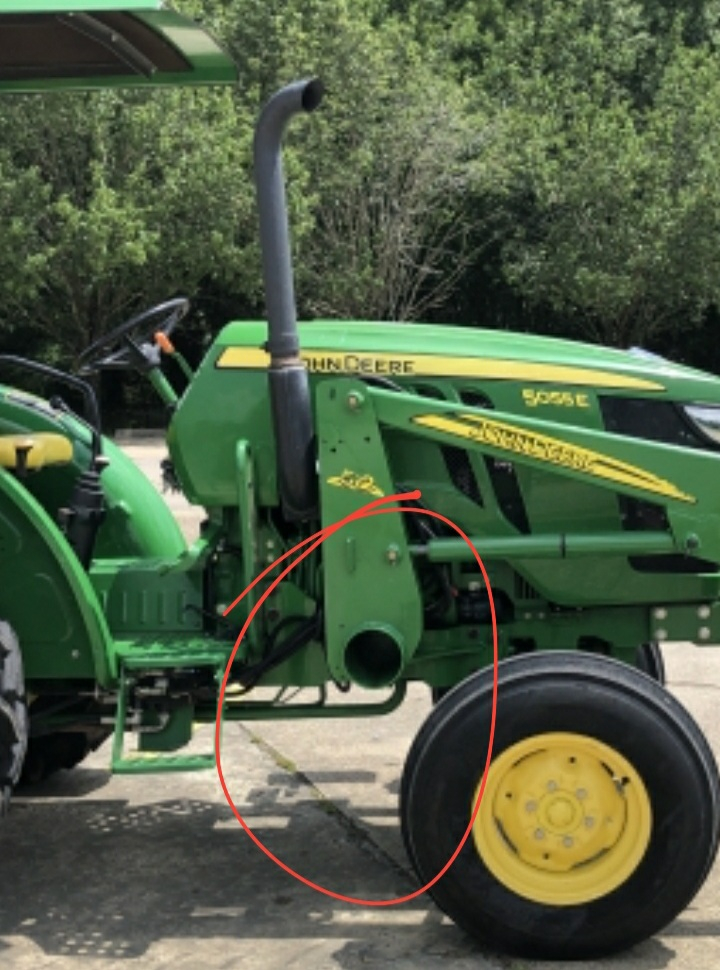

LS:
Deere:
MF:
Kubota:
New Holland:
But that's just one example. You really need to look at one and then the other (better yet side by side), look over the whole loader. Look at how the loader is tied in all the way to the back axle (or not), look the size of the cylinder rods and the pivot pins they use, look at the gussets (or lack of), the gauge of the metal used throughout, you'll see what I mean.
Glad you arent an engineer. Pound for pound a round tube is the strongest shape for torsion.
The pic you have of that kubota....the plate that bolts to the block is at least 1/2" plate. And the upright that connects to the loader is a hefty solid piece. They are connected by a round tube that is probably 6" in diameter and a good 3/8" wall thickness.
The LS only "looks" beefy. But isnt really any stronger. They had to overcompensate for not using a round section when trying to resist torsion.

The pictures here really do not give a good comparison of the mounting brackets. One, these tractors are not all the same size. The NH Boomer 50 and LS XR4140H are the same size (large frame compact), the Kubota L3901 is a medium frame compact, the MF 2605 is a little larger at about the same size as a Kubota MX, and the Deere 5055E is a full sized utility tractor (and a 2014-2017 model with the hood several inches higher than the current version of this model.) This pretty significantly affects the relative scale of the parts being looked at. Two, only two of those tractors have a factory loader, the MF and the Boomer have aftermarket loaders, which is really not germane to a discussion about OEM loaders. Three, at least on the Deere, there are two OEM loaders available and they look a lot different, the 512 is the smaller loader and the 520M loader is much larger than any of the loaders seen in pictures here. Four, the pictures here do not show the mounting brackets very well at all, quite a bit of them are not visible, nor do they show how well the loader is attached to those brackets.
I have seen all of these tractors in person except the Massey-Ferguson. The Boomer 50s I have seen have had New Holland (Quicke/ALO) loaders on them rather than an aftermarket Lewis loader. The LS loaders on the XR4 series are smaller loaders than the 260TL/260TLA on the identical Boomers, and the NH loaders have about an extra foot and a half of lift height. The brackets did not look particularly cheesy to me on them. The Deere 512 loader has more capacity and lift height than any of the others, but then again it is on a full sized utility tractor rather than a compact and compared to the LS and NH loaders, it is not a quick release loader and parts in it that are welded and boxed are plates and pins on the LS and NH loaders. Its mounting brackets are also larger than the others, but again, it is a loader for a full sized utility tractor. It only looks small because the tractor it's mounted on is significantly taller than the compacts shown here.
