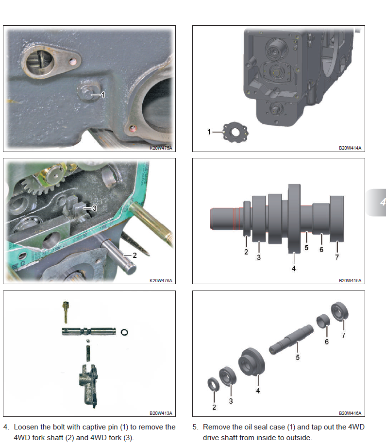

I have a 2022 5520ch, after lubing everything, my 4WD lever will fall into 4WD with only a little bit of movement. Apparently, the dirt I pushed out of the levers when greasing them was saving me from this.
There's an obvious detent while in 4WD, but what only feels like a very weak one when disengaged. Looking at the lever and linkage, the detent I feel in 4WD is obviously internal to the transmission. Is there usually a firm detent also while disengaged?
I'm about to put a fat rubber band between the lever and seat to keep this from happening.
Anyone have a real solution?

The detent should have the same pressure on both positions (engaged and disengaged).
Are you sure the 4WD Lever is moving the full travel in the disengage position?
I have a vague idea of someone mentioning that the rubber boot would prevent it from moving all the way in the Cab models.
EDIT: The detent is built within the fork that moves the 4WD gear back and forth. So no good way to access it and I can't see why it would the issue, instead of with the linkage.

I was wondering the same thing. The rubber is stressed when disengaged, but it appears the transmission limits the movement. I loosened the rubber to confirm.
The seat moved forward will cause interference with the levers and push it down. I encountered this the first time my wife drove the tractor.
Very helpful.
For my next step, I think I will disconnect the linking from the transmission and see if something else limits the movement, and confirm the transmission has a detent working while disengaged.
Very helpful.
That's a good move to troubleshoot this one out.
I don't think the linkage has any adjustment but it would be nice if it did.
