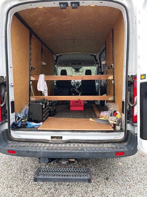

I toted my clean 55 gal drum to town and brought 55 gallons of farm diesel home. Saved $1 per gal in road tax (y)

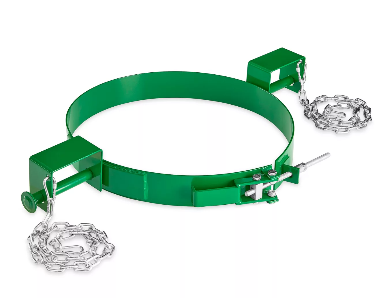

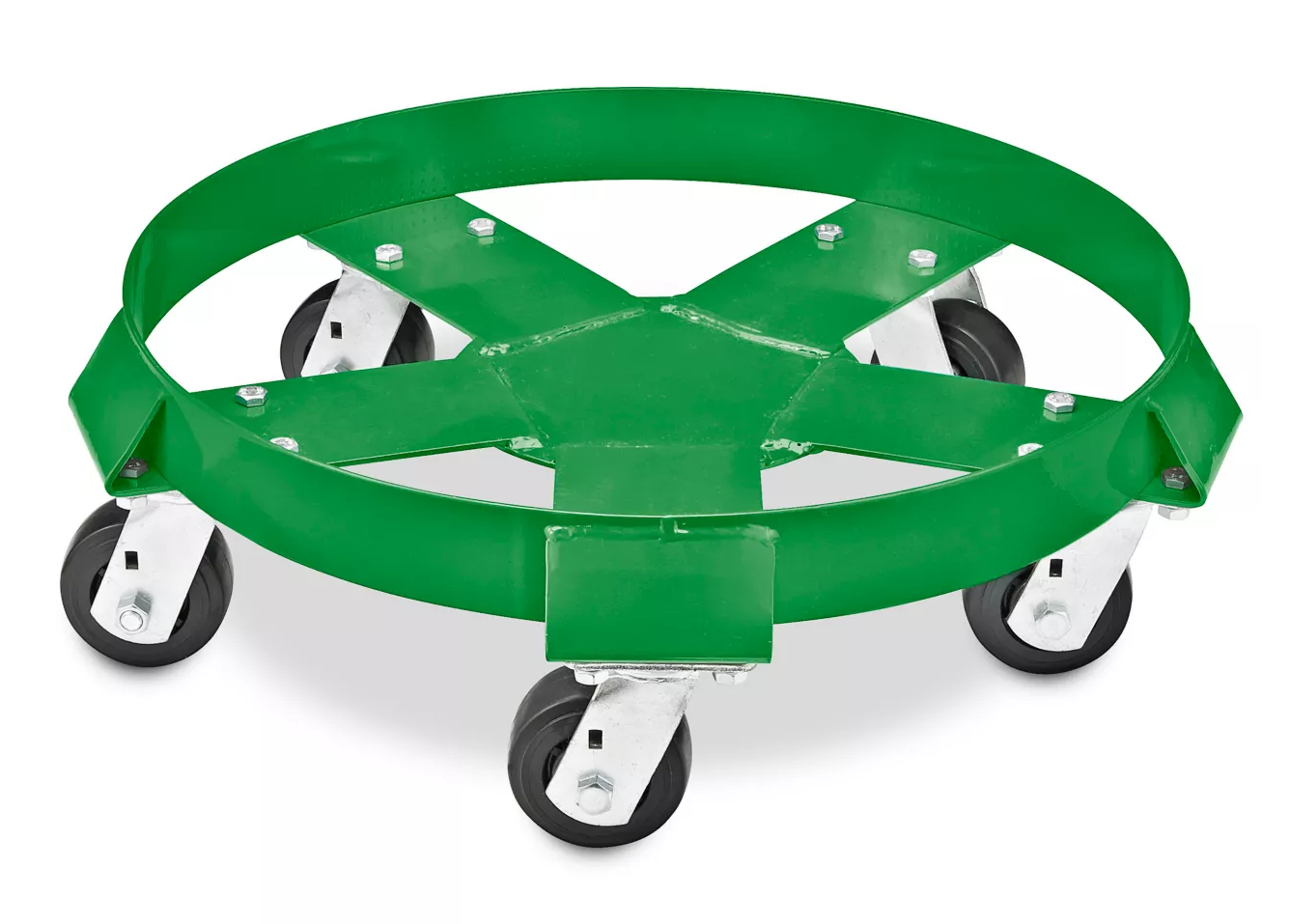

The attendent said 300 gal is the min home delivery :oops: so yeah - I better get used to this routine forking the barrel in and out of the van and here and there etc. Thank God for the forklift. I'm sure the tractor would do it but the forklift is the best tool for the job. Sure beats a mess of 5 gal jugs though. Will add another picture later. This strap is attached below the rim at the top of the barrel. The fork pocket swings 360 so the barrel can be laid down or pour. I'll just pump out of it upright. I don't have the safty chains on it yet but I do have a dolly for rolling around the shop.

And that clamp will hold onto a plastic drum full of fuel while you lift it with the forks? Doesn't slip?

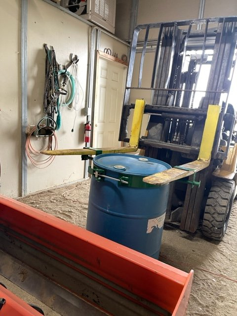

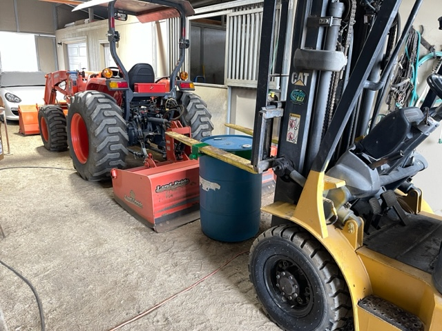

It work good. The barrel has a stout little lip at the top. The clamp has a tension bolt so you can adjust how hard you want to grip. I adjusted it as tight as I dared without distorting the barrel relying on the lip to hold it. I calculate the drum to be around 400 pounds full. I just now raised it out of the van and set it in the barn.
In a little bit I will fill everything up and put it on the dolly on the concrete floor section of the barn to the left of these pics

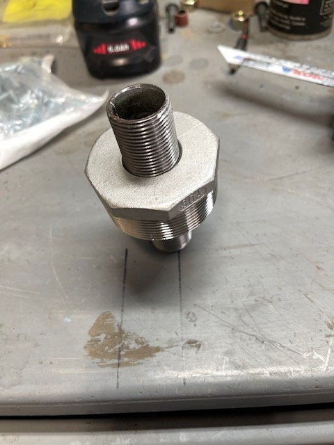

Been gathering parts to use a filter https://www.amazon.com/gp/product/B0B1HSQ33F/ref=ppx_yo_dt_b_asin_title_o03_s02?ie=UTF8&psc=1 and 12v pump with the barrel. Found plenty of 2" taps for a 55 gal rain barrel on amazon. Grabbed one with a 3/4 pipe threaded hole in the center. 3/4 is overkill but it fits my pump hose. At Lowes I got some pipe and fittings. Lowes has a powerized threading machine. Clerk there cut 4inches of thread on the end of a 4ft galv pipe and cut it off for me. This 4 in threaded nipple will go through the plug and allow me to attach a pipe going to the bottom of the barrel. In hind sight (20/20) this pipe coulda been 1/2 inch material and the 4 inches of threaded end coulda been 3" and not cut off. Simply cut teh pipe to be an inch off the bottom.
Anyway heres what I got so far.
