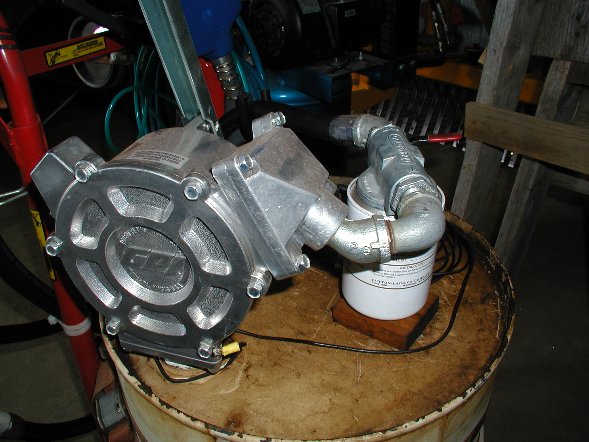

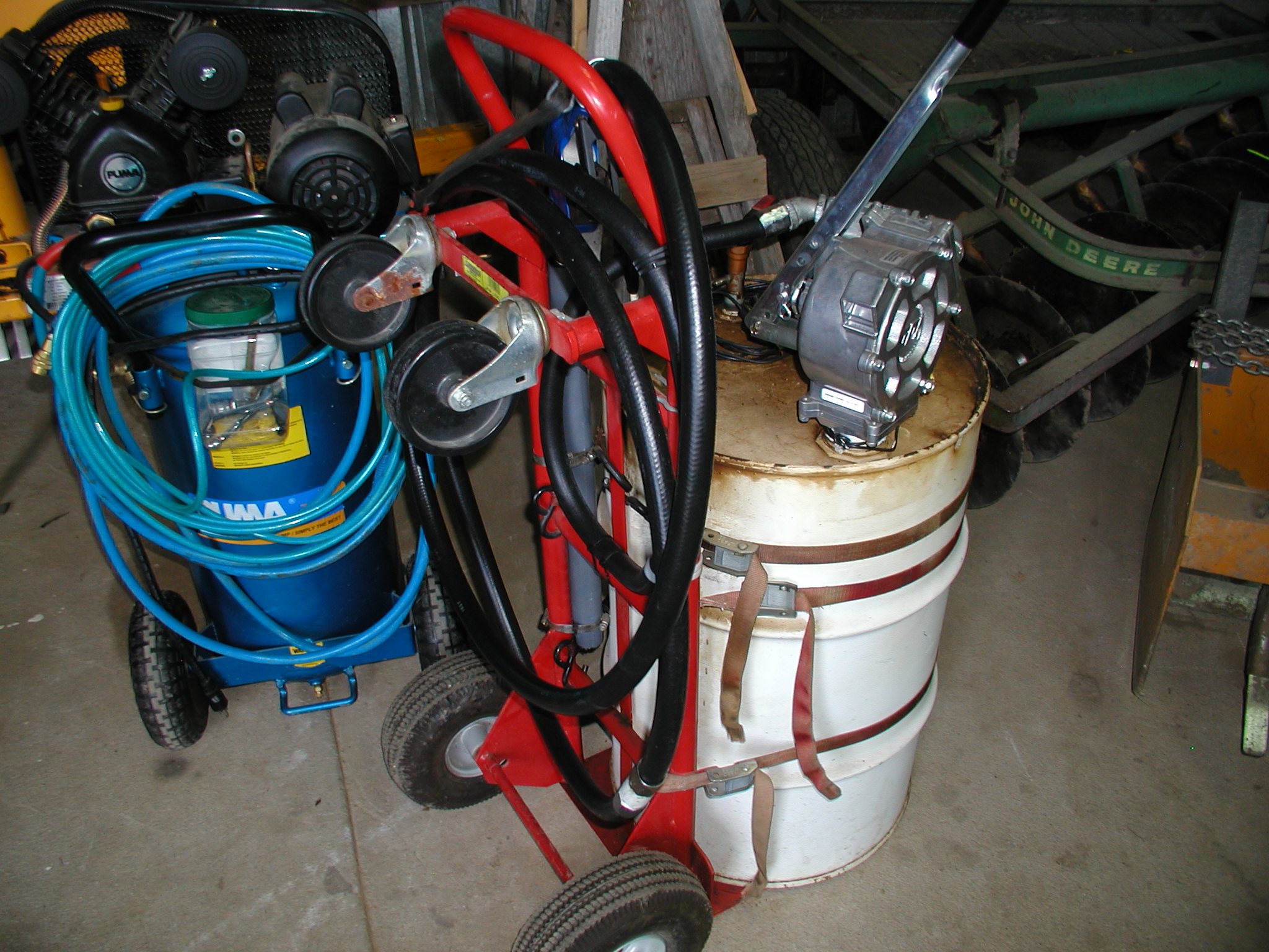

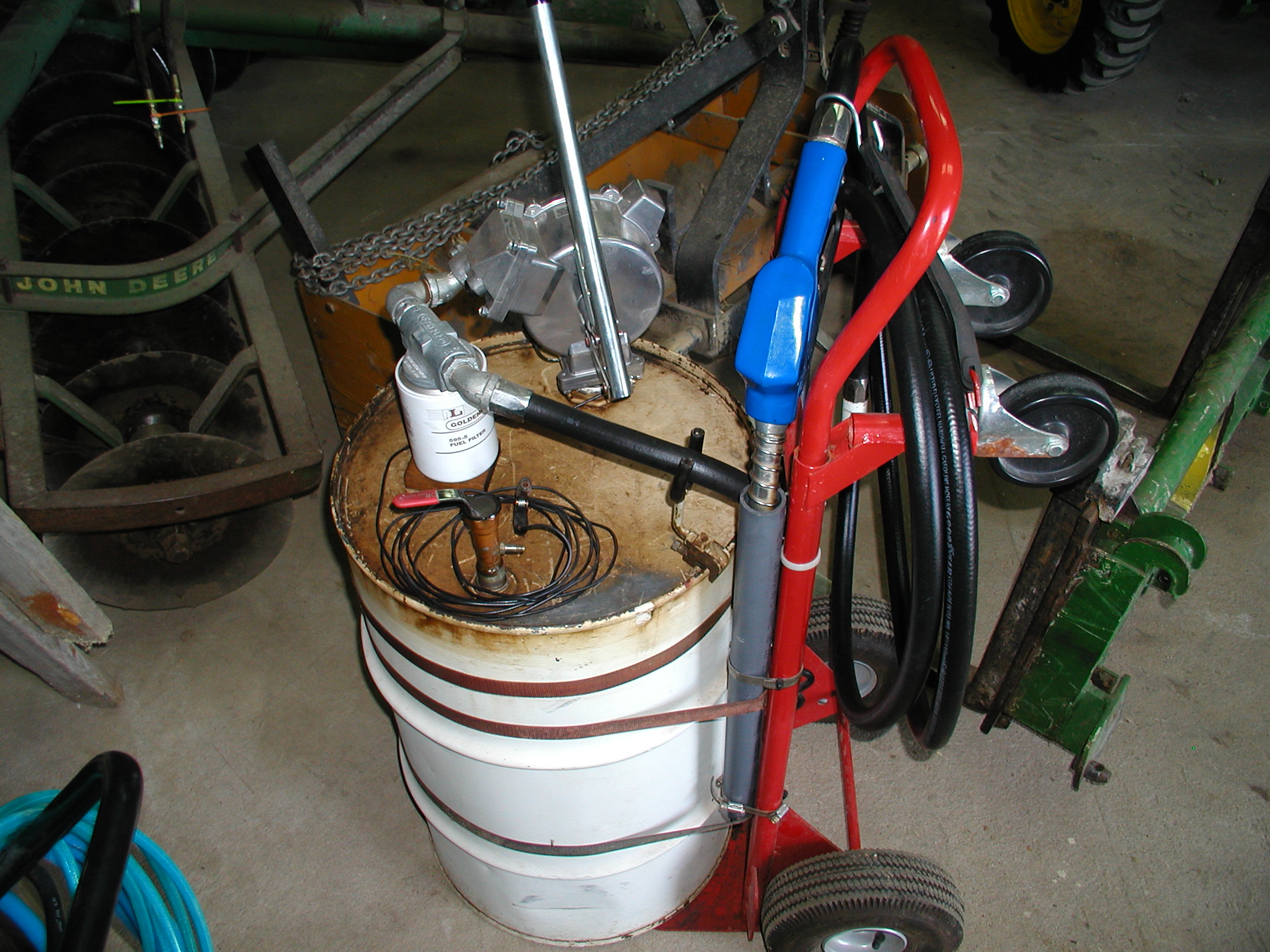

I built something similar to what was already suggested. I was also sick of five gallon cans, especially due to higher useage needs as I am doing some actual small scale farming, sometimes with borrowed tractor, and wish to return their equipment with fuel added. So I used a 30 gallon barrel, which I bought almost new after it had crop oil in it once. Rinsed it with diesel, painted outside, added a stroke pump and filter with 10 feet of hose, and topped it off with an automatic-off nozzle like the gas stations have. I strapped it all to a 2-wheel box moving cart. To fill it I place it on my trailer and tie it down and drive to the local station, four miles away. For unloading, I back trailer up to dirt ramp in yard and roll it off. Works great. No more lifting, has way more capacity than a couple cans, auto nozzle is mint, even the wife can do it. Pics...

I've got one similar to JimGerken's. Mine has a crank pump instead of a stroke pump. I took off the crank handle and made an adapter to replace it so to hook my cordless drill up to it and get with it. No pics here on the computer though.

Jim, I have been considering doing the same thing. I have heard the fuel companies switch their diesel before winter to a treated diesel. Do you have to treat your diesel for winter use? If you do treat it, what do you use? I don't want to make the investment in a large quantity of diesel then have it go to waste come winter if I have any left over. Also it looked like you have a static discharge line on yours. What does it connect to on the tank and tractor? Thanks for any help.

1st of all you can hook an inline filter on a gravity feed with no problem, other than it may slow the flow down some. But then, he ain"t talking about fueling a Nascar race car. MF1652 the static line on most fueling systems like that is when you are pumping fuel that have highly flammable fumes such as gas. The line attaches to the pumping system and then the other end attaches to a good ground on the vehicle you are fueling such as the frame, not to the battery tho as you would already have a ground cable going to the battery if it had an electric pump of some kind. This helps to eliminate static electricity, aka sparks. zman :cool:
