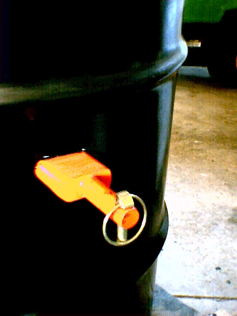

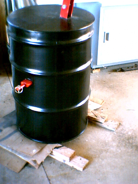

Anyone know what a 55 gal drum weighs when loaded with concrete? I need to build a ballast for my TC29 and wonder how much weight would be correct for it.
I recently built a rear ballast for my tractor. I used a plastic 55 gallon drum, Scrap steel I had laying around, and ready mix from the box store. I estimated my weight as follows:
Plastic drum about 10 lb.
Steel welded together for internal framework about 50 lb.
Cement - 12-60lb bags hand mixed and filled barrel about 3/4 full 720 lb.
For a total of 780 lb.
I didn't fill it because I wanted space for some chains, straps, and tools in the barrel. I am going to install some hooks to carry shovels.
If I had filled it I would guess it would have taken another 4-5 bags or another 300 lb.
For the steel I used 1" round bar, 1 1/2 x 2 1/2 x 3/16 thick tubing, and made provisions for a lifting point and for a rear tow hook. Then added reflectors and reflective tape.

Hey, don't forget to put some PVC pipe in so you can carry tools. I think that's one of the coolest features of the concrete-filled ballast...
Love that idea. I need ballast but mostly, like most CUT drivers, I need places to put stuff. I don't plan on a dedicated tub of concrete like this but I like the concept. Mine will be a large metal box with a tailgate that dumps with my hydraulic TL and has a 4 or 5" concrete bottom for weight. Keep it low.

I know this is an ancient thread, but ****, this is nice
Thank you. It was an easy build for me, using off the shelf supplies for the 3PH attachment points. I still use it every winter for ballast while snow plowing. Occasionally I use it in the summer for heavy loader work too.
