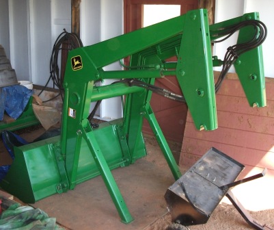

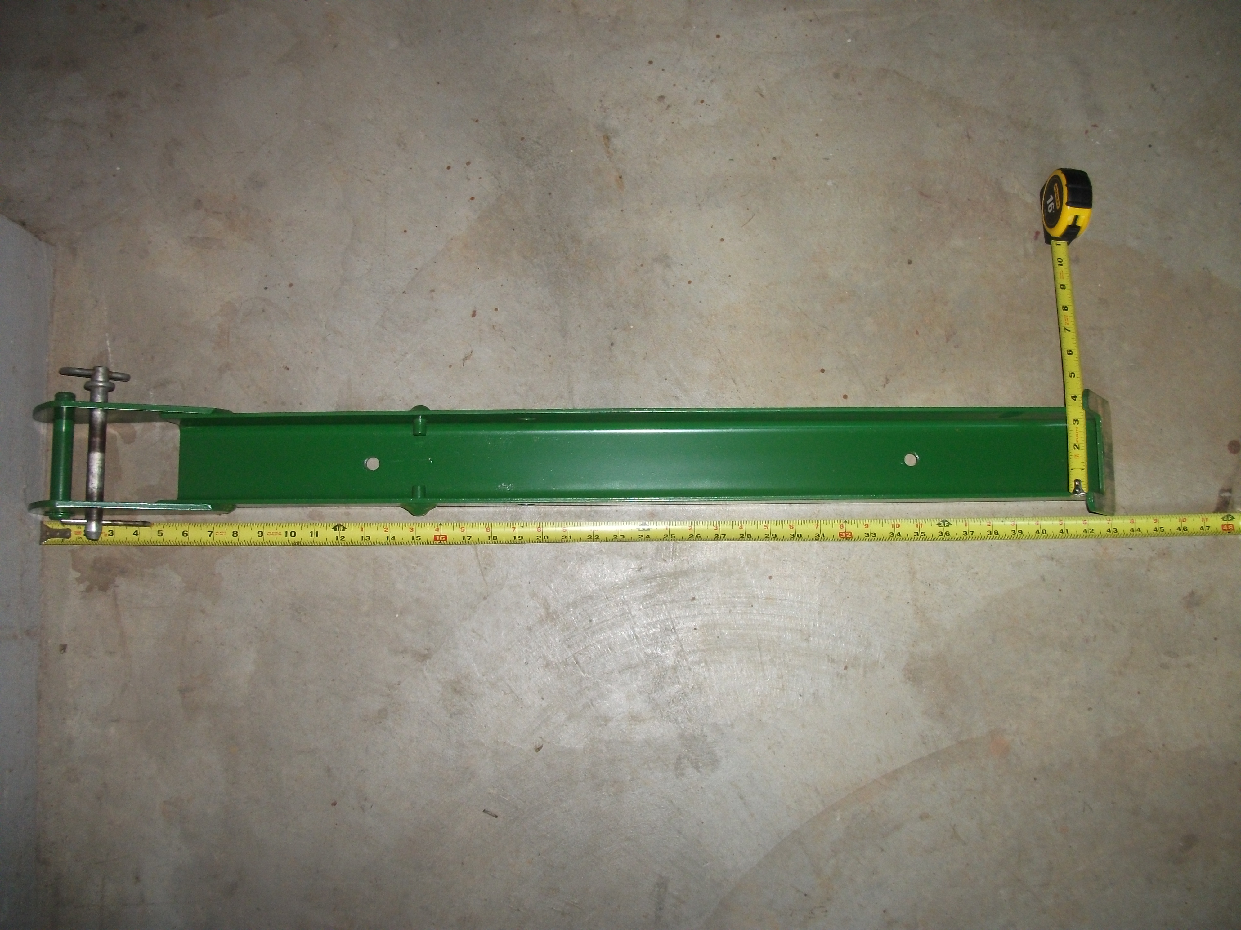

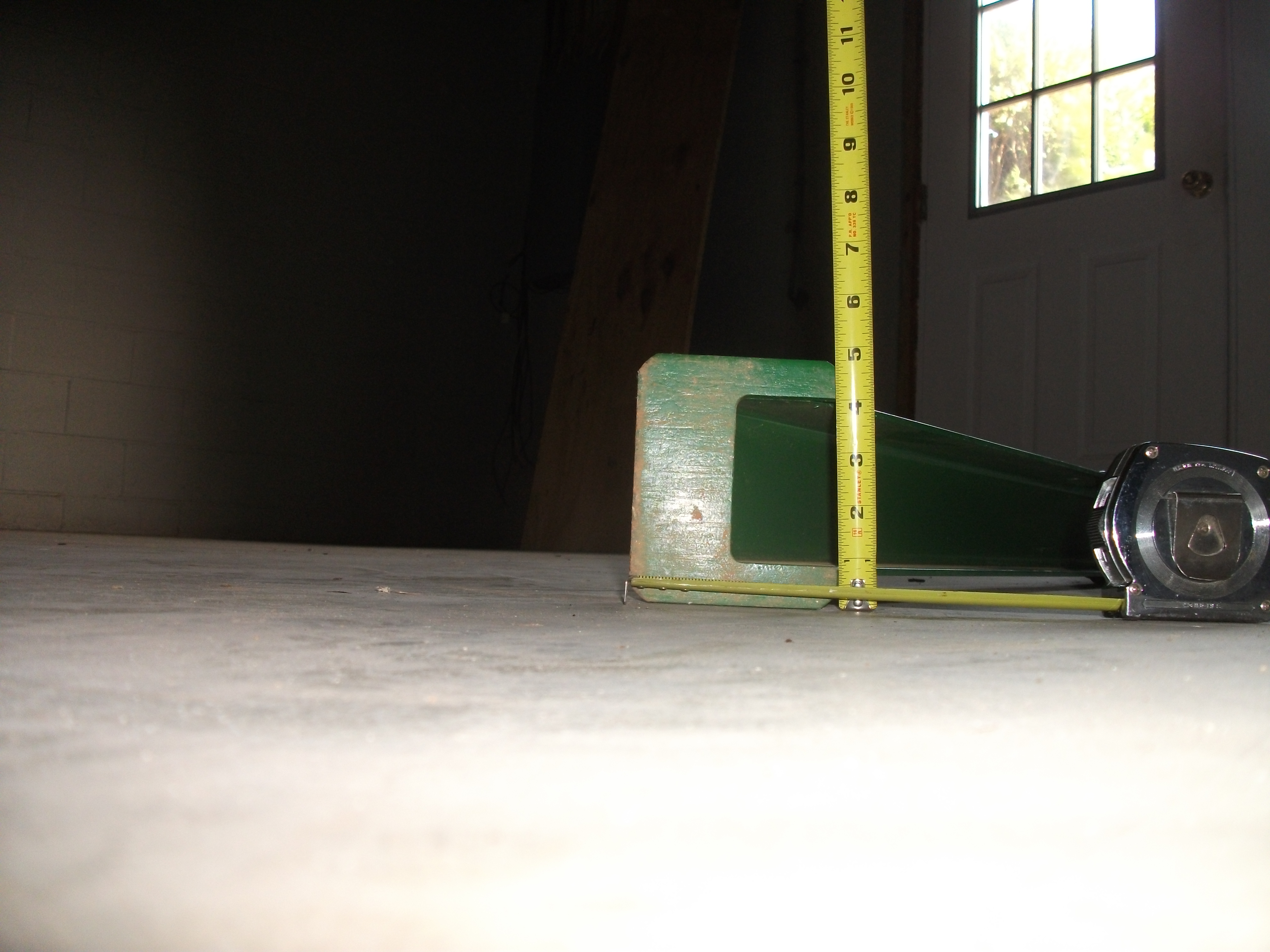

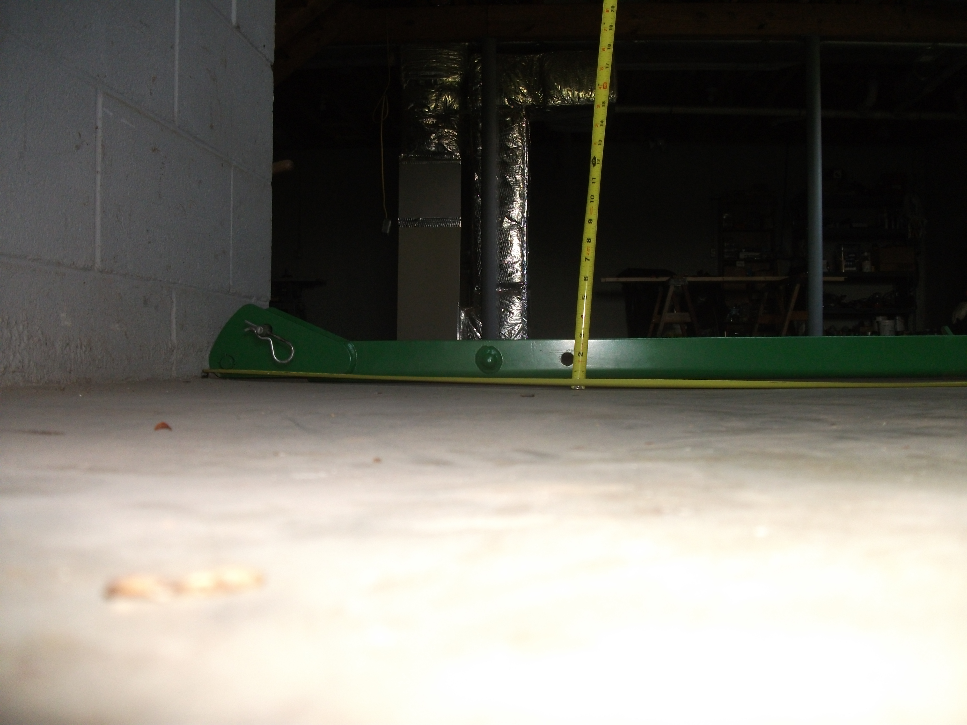

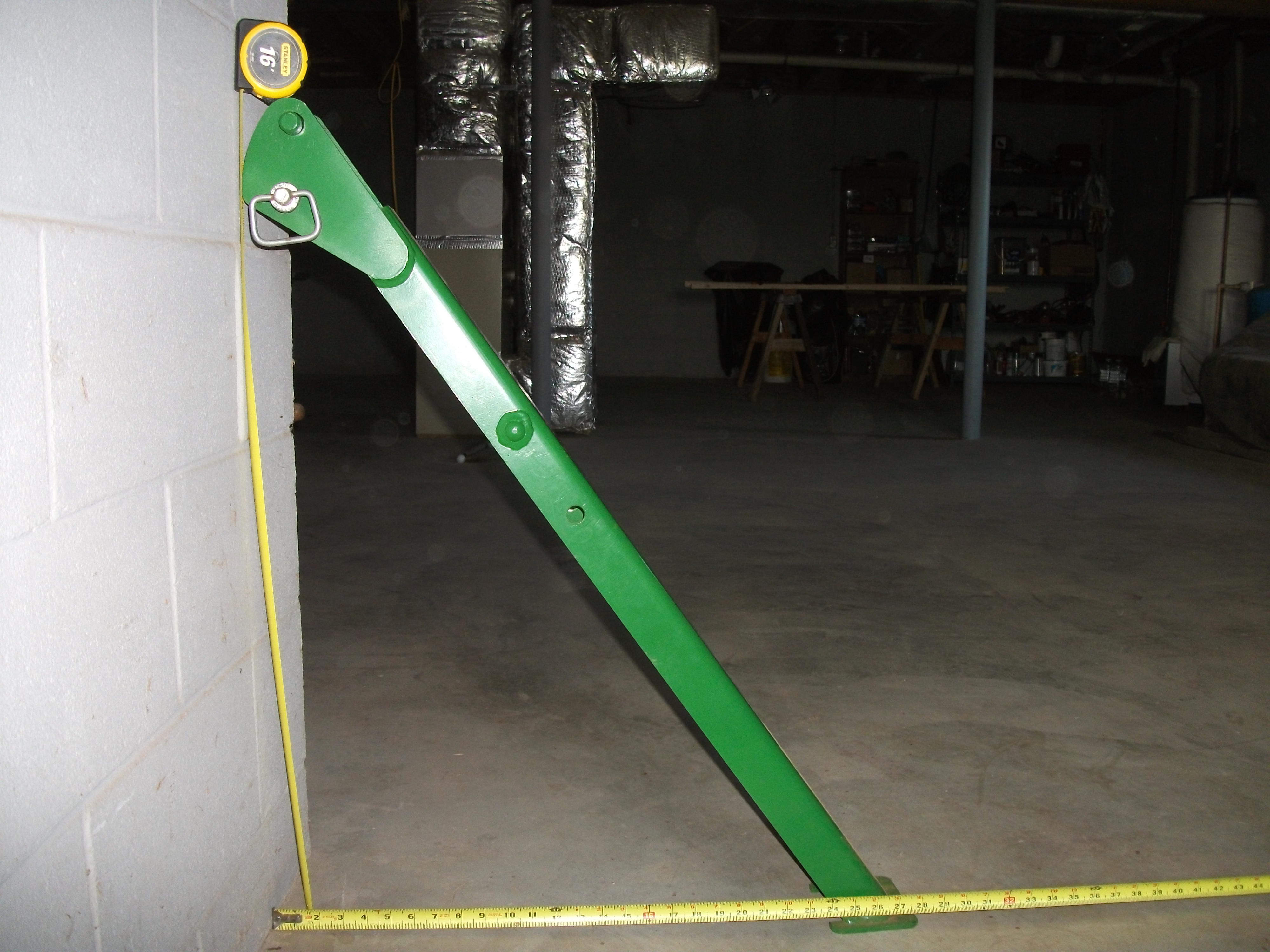

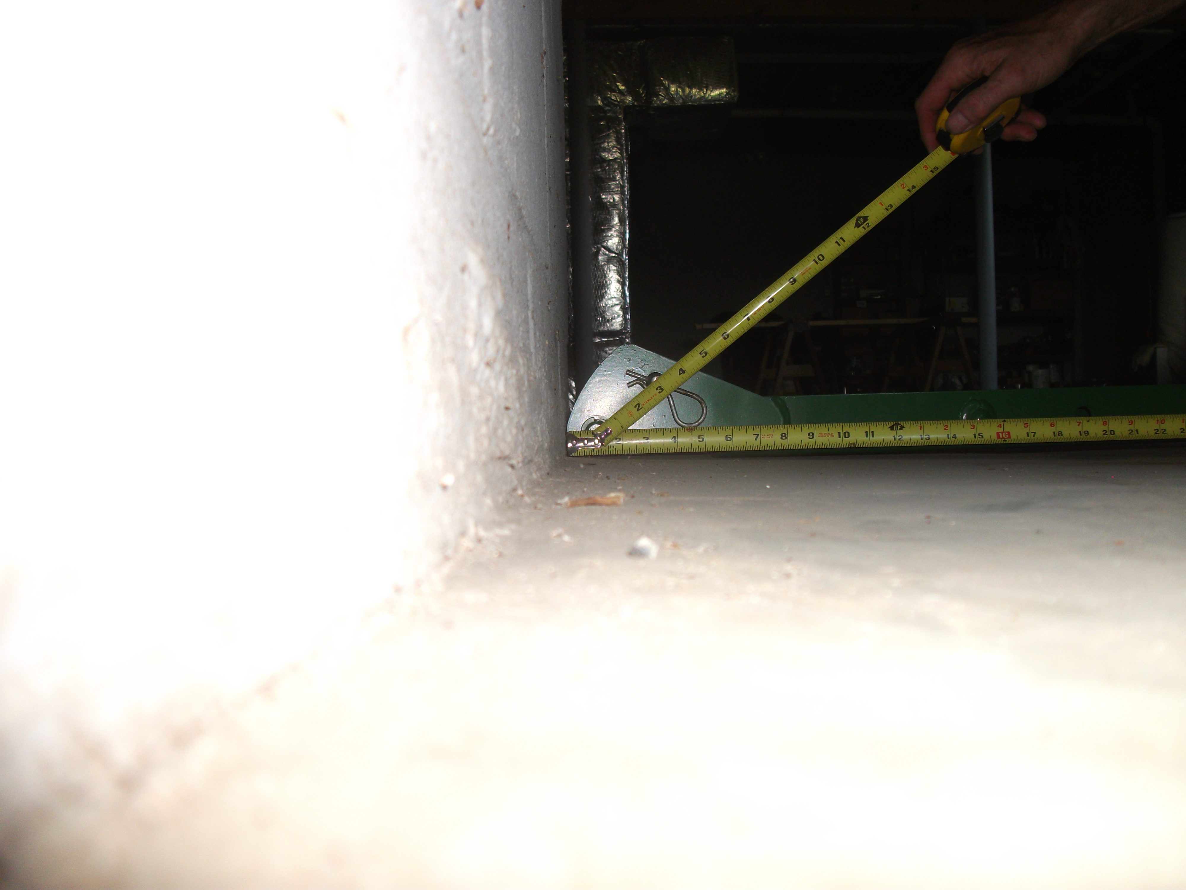

I recently bought a JD 5510 MFWD w/ a 540 FEL. It's missing both parking stands. Anyone have the angles and/or dimensions. I was thinking of building my own. Can't be to difficult can it?
/ 540 loader parking stands #2
If you would send me a PM with your e-mail address, when I go out in the morning I will take some pictures with measurements. By e-mailing them to you I will not have to reduce the size as that I would need to do inorder to post them. If you do not already have it here is the manual for the 540 loader. If you have not already been to JD parts catalog you may want to see what other parts you will need. Do you have the guide? I posted a small picture I have it is the piece above the stand. If not let me know and I can get a picture of that as well.
It take it you want the stands to take the loader off, just so you do not miss it as I almost did, the tractor needs to be in neutral, because the loader pushes the tractor off of it.

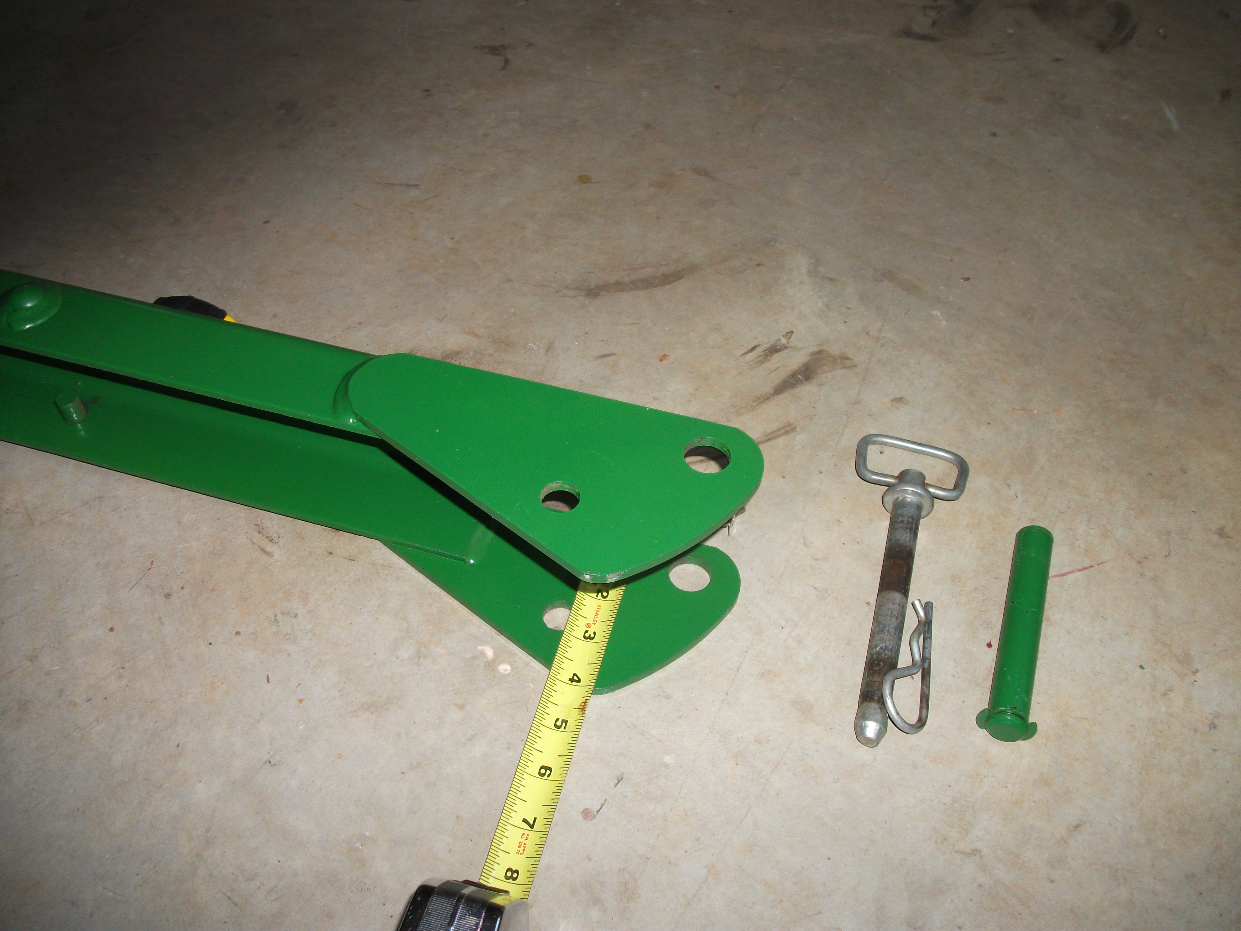

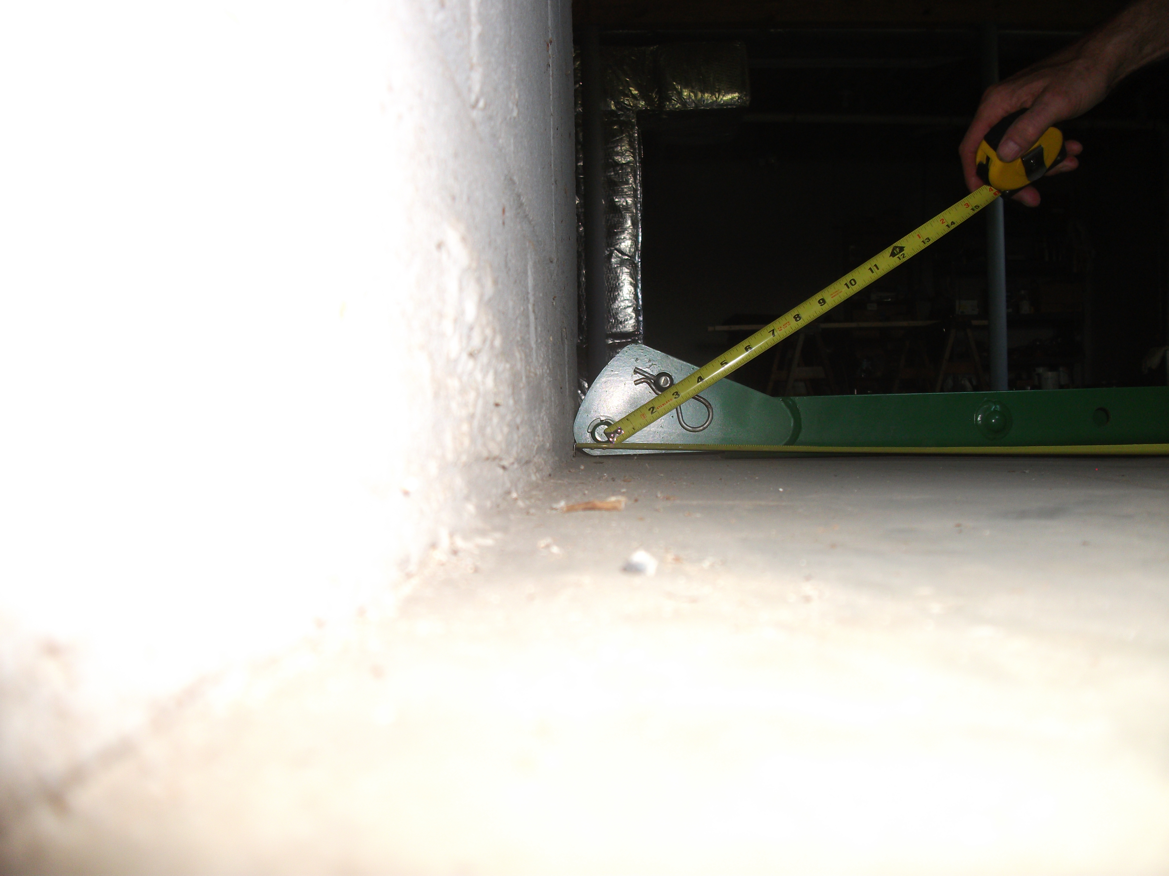

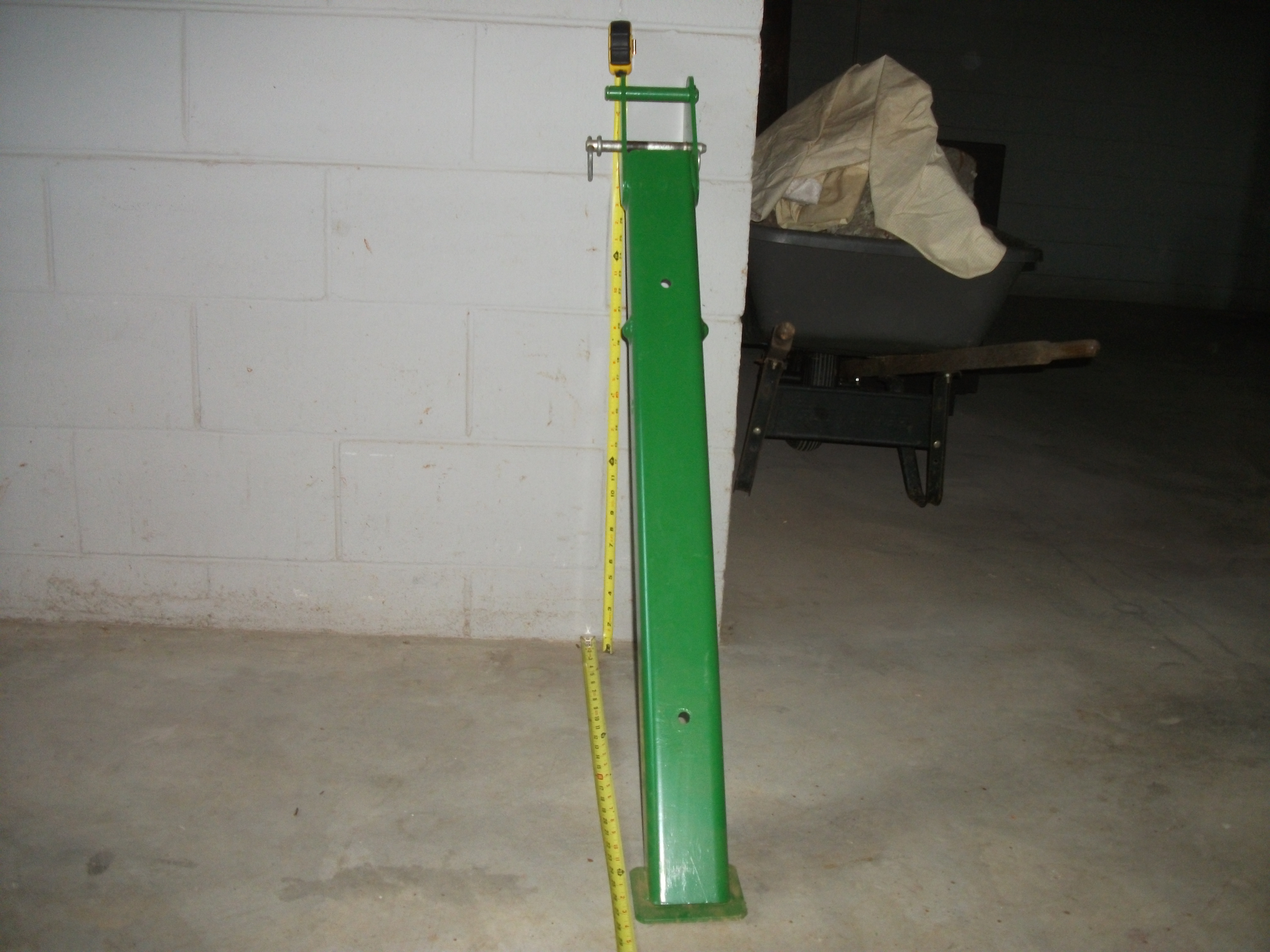

I have pictures of mine and placed a ruler along side for measurement. If you think there is value in having them PM (private message) me your e-mail address and I will e-mail them to you.
Would you mind sharing why you split your 5210 and what you learned it. If it was to replace the clutch I am sure others would be interested in learning from your experience.
/ 540 loader parking stands #5
You should be getting 3 e-mails shortly hope they help.

540 Stand Pics 1

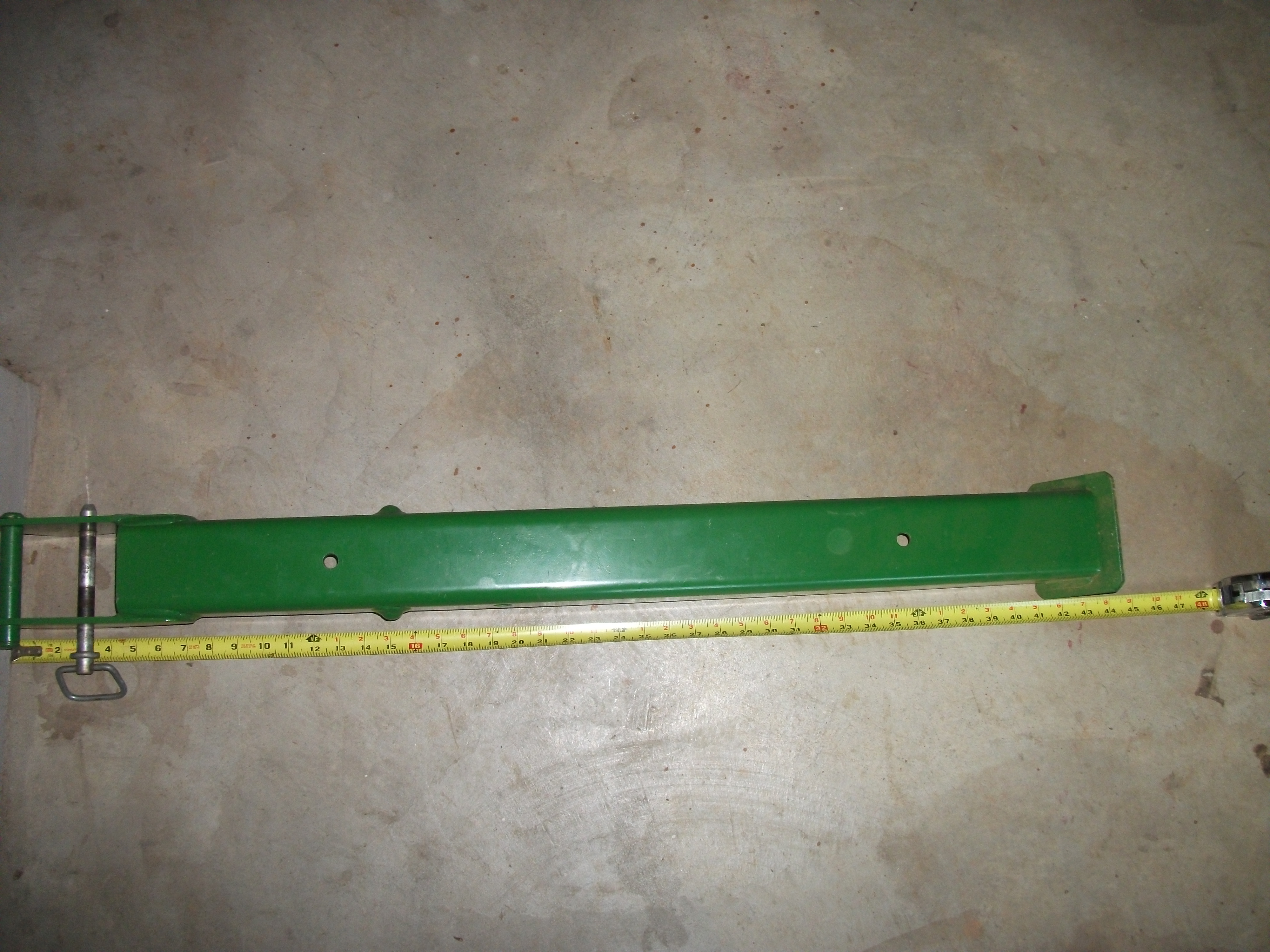

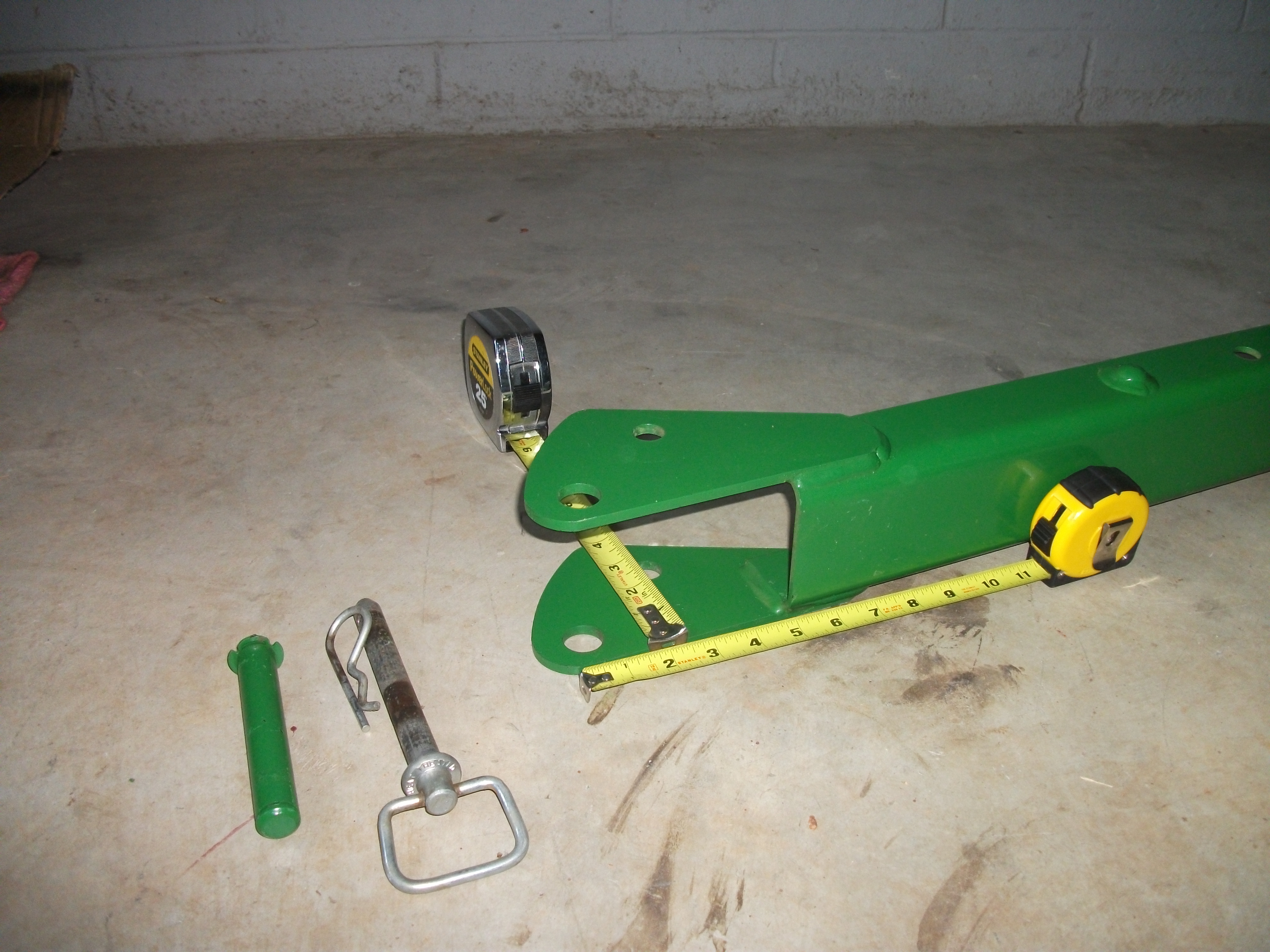

540 stand pics 2
  • jdpartsparkingstands.pdf
