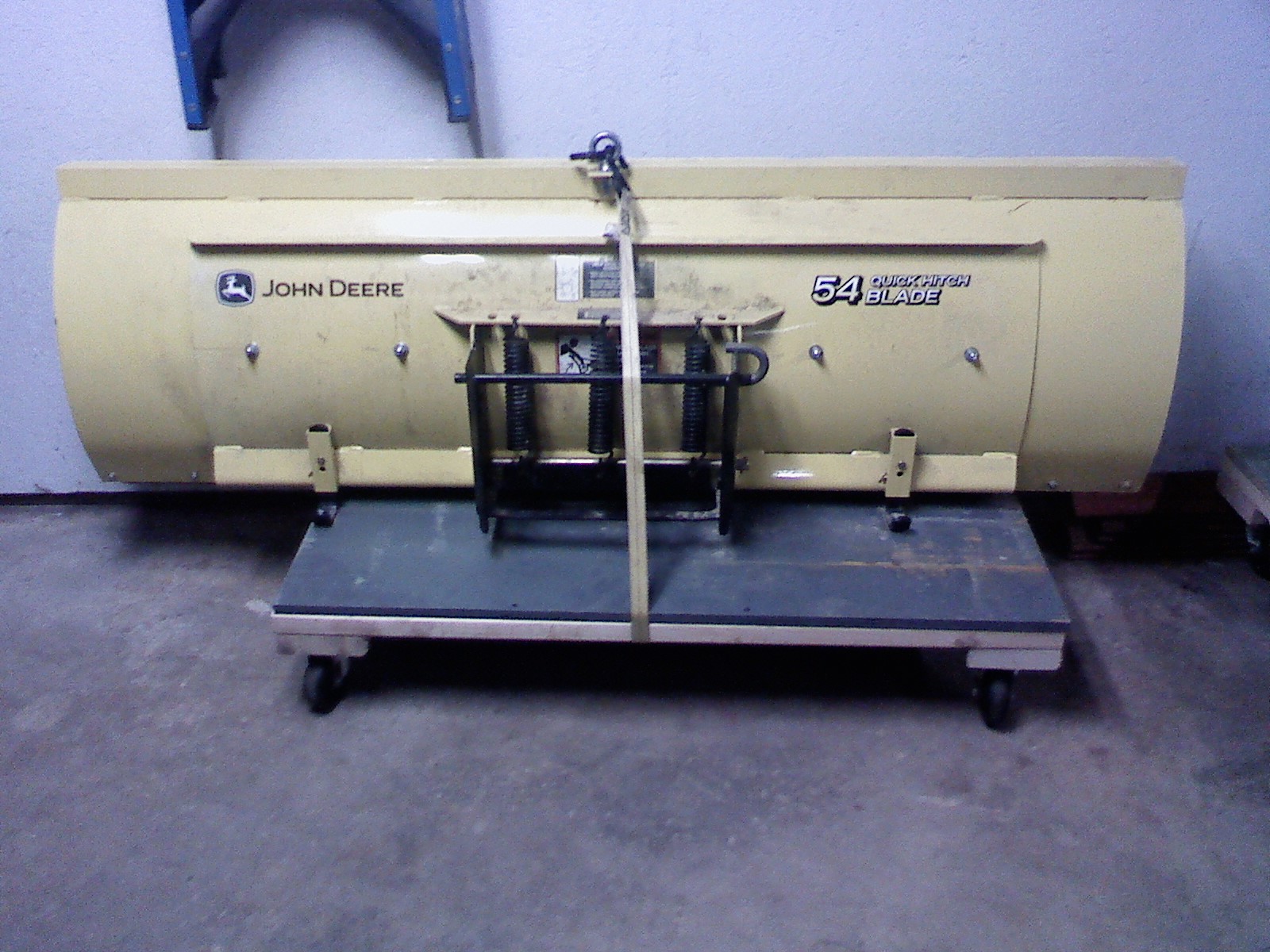

i just bought a john deere 54'' snowplow blade.i have a 2305 and i would like to know if anyone can tell me why they think deere doesn't offer a wider one. I'm thinking on making 72" I'm sure the tractor will handle it. help please.

i just bought a john deere 54'' snowplow blade.i have a 2305 and i would like to know if anyone can tell me why they think deere doesn't offer a wider one. I'm thinking on widening it to 72'', I'm sure the tractor can handle it. does anyone have the 54'' blade on a 2305 or bigger tractor and let me know how it works out. my driveway is 200 feet long and i also have the front mounted 47'' blower it just won't handle the heavy wet snow to good, so really I'm only going to plow when the blower won't handle it.

Don't know why JD does not make a bigger blade. But I made my 54'' blade
bigger by having a piece of 3/16'' X72'' X24'' rolled to fit the front of the little
blade. Then bolted it to the front. Put a 3'' strip on the bottom for wear. Been using it
for 4 winters with no problems at all. Also put 1 1/2'' piece of angle acrossed the top.
My 2004 JD 4110 handles the larger blade quite well. Go for it.

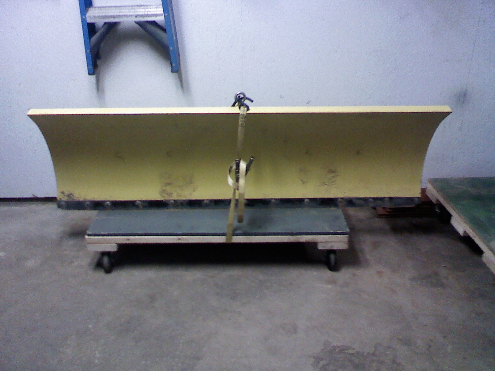

i like the idea on how you added to your blade, do you have pics if not can you describe how it was rolled to the contour of your blade. you said it's 24'' high i know my jd blade is only 17'' high. i'm wondering how the extra height fits that contour or if there's another break in the roll or if it just extends outwards on the same radius.

I cut a piece of cardboard to the contour of the 54''' blade and took it
to the steel supplier and ask him to roll it to that contour. He did really great.
The blade extends above the shorter blade. I put a piece of angle iron
acrossed the top of the 24''blade. Don't think I need it, but it looks
more finished. The steel and rolling was $125.00. That is all I have
in it. Angle iron and wear strip material, I had on hand.
Wish I could be more help. I'm sorry about no pictures on computer.
The effort and expense was well worth it. It works really well.

thanks for the help i'm going to get a price and duplicate your idea really better than what i had in mind i was going to add 9'' on both ends. Not only will this be higher also much stronger and i won't have to weld on a new 500.00 dollar plow. thanks again.

here's my blow all finished i used 1/4 inch thick plate 24" by 6' wide. tractor handles the snow without a problem
