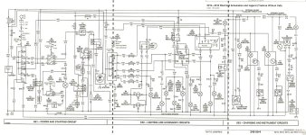

Has anybody had the entire gauge console stop working on a JD 5300 tractor? I removed the cover and cleaned evrything and it still worked. When I put all the covers back on none of the console would work. I have traced wires with no success. Any help would be great.
/ 5300 Gauge console wont work #2

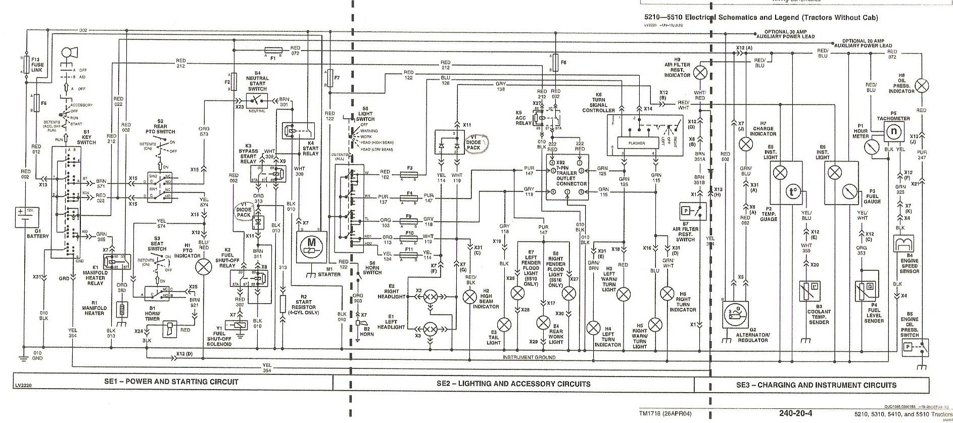

Did you check the fuse? On my 5210 it is a red 10 amp fuse. I do not know how close they are, but I have attached a wiring diagram for the 5x10 tractors.
Also check the black wires on the 5x10 those are the ground wires.
If the wiring diagram does not match consider getting the tech manual from selectmanuals.com downloadable for $29.95.
