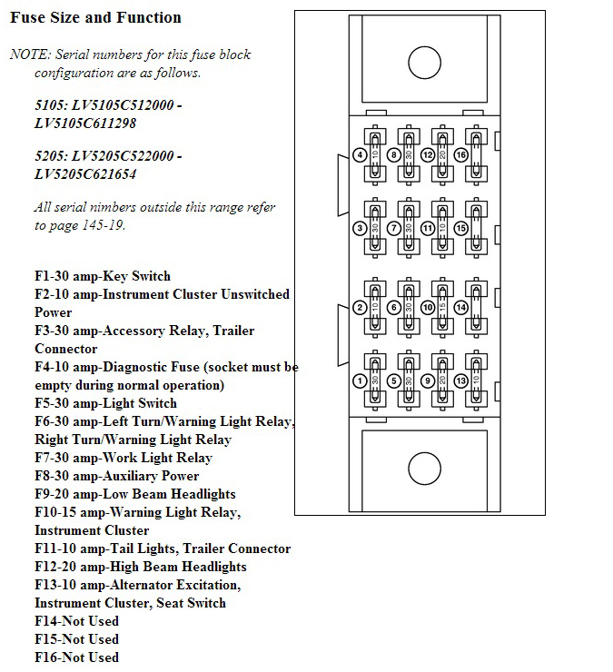

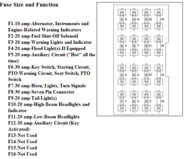

Ed, if you have 00 00 on your display, that means you hae a fuse inserted in the "DIAG" position. There should be no fuse in that position unless you are running diagnostic tests or calibrations. Remove that fuse and your gauges may all work.
/ 5150 smoke problem
#20
jd110...Will check...on my online operator's manual for a 2005 5105, (have a 2004 5105), I have two fuse schematics. Fuse size and Function.jpgFuse size and function(2).jpg...which one applies?
