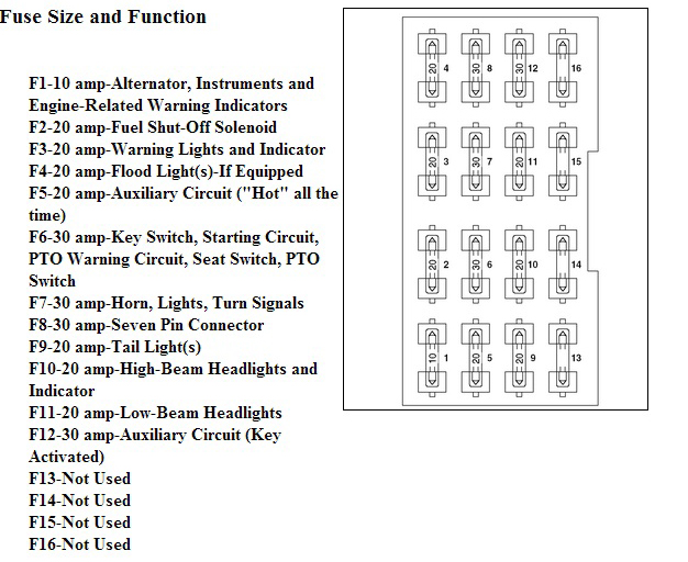

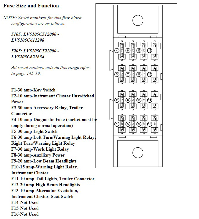

I'm not jd110 but I'll state the first wiring schematic and F4

Tx...The schematic you chose was correct. I removed the front panel, and removed the fuse. I did remove the side panels, but didn't have to. I now have dash lights working for the tachometer, hour gauge, battery, oil pressure, and quite possibly the temperature. The fuel gauge, brake lights, and turn signals do not. The wires attached to the ignition show no damage, so that's a BIG relief. It was snow as I suspected. Thanks, everyone for your help.
