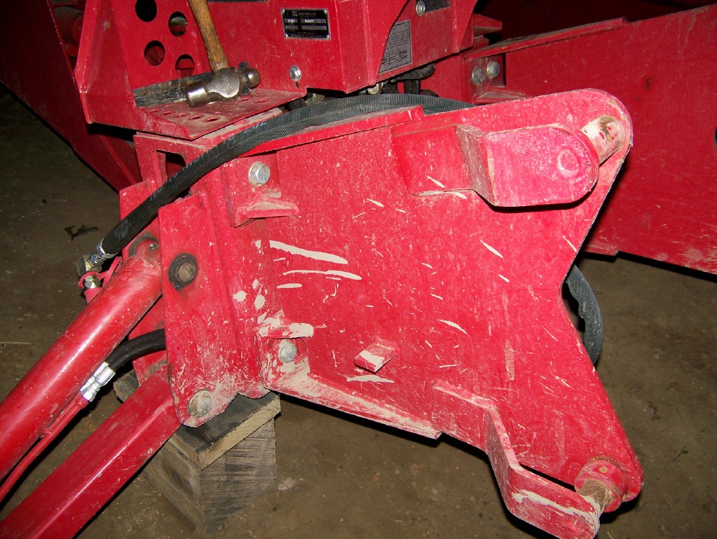

What I'm considering is the purchase of a 511/611 backhoe subframe from my local Mahindra dealer. The cost is $1,2000 for the tractor half plus the BH half. What I want to be sure about is that I can mount the BH half of the 511 subframe to a Bobcat 811. The Bobcat 811 has a quick attach plate plus two arms similar to the upper arms on your BH subframe (the 2 pieces with the 8 bolts). I would need to strip off the Bobcat mountings from the BH and bolt and/or weld the the two 511 BH subframe pieces to the Bobcat mounting plate. I just want to make sure that the outside dimensions (horizontal & vertical) of your attached BH subrame will fit on the Bobcat mounting plate.
Bob
/ 511 backhoe subframe #23
Bobvt said:
Brandi,
Bob
Bob,
Okay, I understand now. I wouldn't weld the brackets to the 811. If you ever have a need to sale it, you will have to restore it to original.
hugs, Brandi

Bob, Okay, I understand now. I wouldn't weld the brackets to the 811. If you ever have a need to sale it, you will have to restore it to original.
hugs, Brandi
Unless those bolt holes just happen to line up perfectly (not necessarily all, but most)... this project is begging for a massive (read: thick steel) custom drilled adapter plate. :)
Dougster
/ 511 backhoe subframe #26
Dougster
I think I know where I could get some.
/ 511 backhoe subframe #27
Now GEEEEE Ed... where on earth would you find some of that stuff??? :confused: :D
Dougster
/ 511 backhoe subframe #28
Dougster
Dougster,
I am wondering with all the 11s in the model number...511, 811, 611, if indeed, they are all made by Bradco (like someone mentioned earlier) and may line up. My guess is 4 holes will be close. :D An apdaper plate will might need cutting and welding new flanges, as there are cutouts on mine for some of the bolts. If he can get a part number for the 811's mainframe, we can at least compare part numbers. ;)
hugs, Brandi
