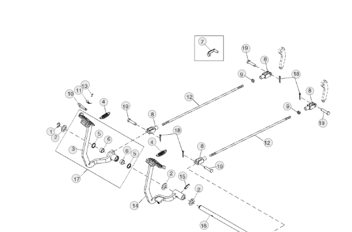

Good morning Joe I just got a 2005 5105 and the brake pedal goes all the way down with no braking effect. Any idea where I should start, the tractor only has 1027 hrs. Any help would greatly be appreciated.
Keith
/ 5105 wet brake replacement #8
Keith
Welcome to TBN
A good place to start on brakes is turn yoke on rod so as to shorten distances between yokes on each brake operating linkages.
