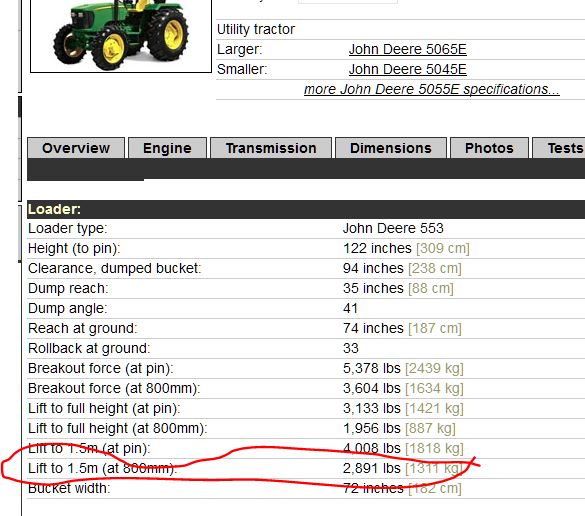

I wish I could post what I have from the dealer. He has a spec sheet that he got on his dealer website, and the heading titled "John Deere 553 NSL on 5E Series Tractor" and down that column at the "Lift Capacity at Pivot" is 4,008 pounds. Now, I'm not sure if that's the max and specified for the 65HP model but he told me he thought the 5055 could do over 3,000 with a heavy duty pallet fork. I should just buy a skid steer and call it a day :)

lifting 4000#s at the bucket attaching pins is one thing and lifting 4000#s sticking out 4 ft in front of the pins is totally different
Sure, but it will lift 2,900lbs to 1.5m at 800mm, so it would lift a lot more to a lower height. If he only had to lift it a foot or so, it might be as high as 4K.

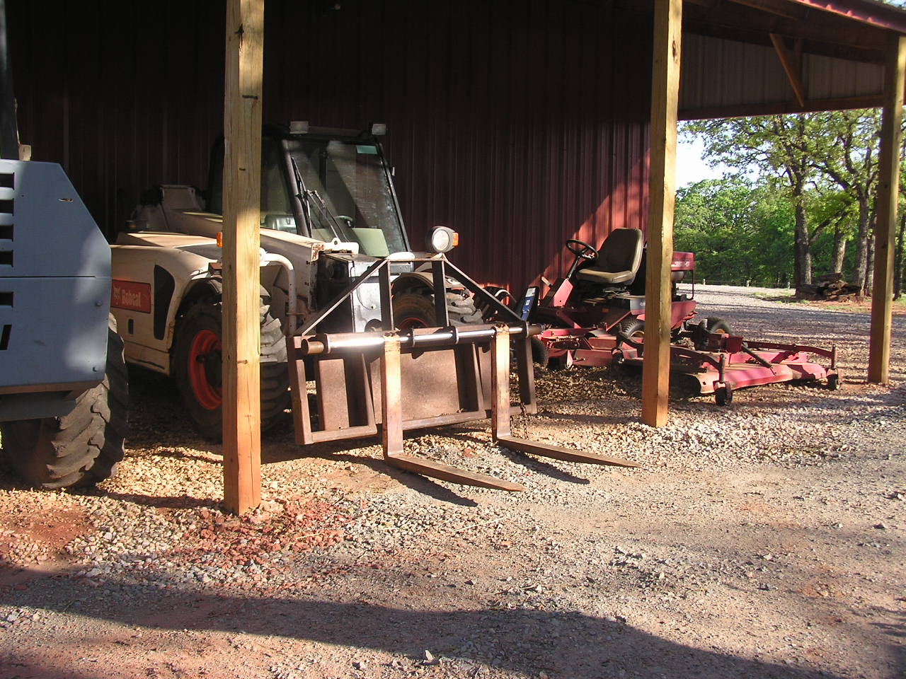

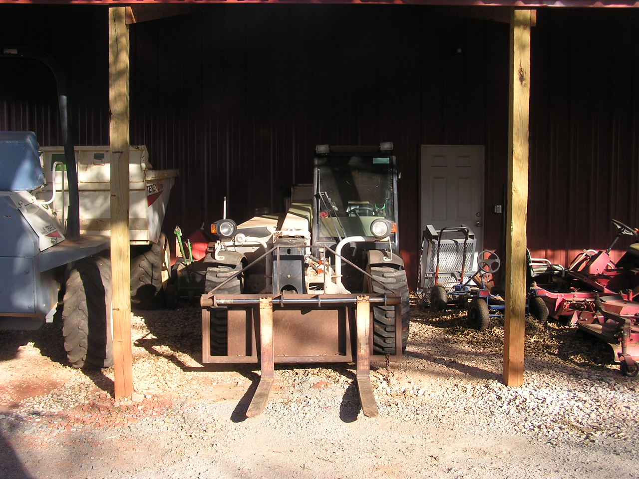

No not a skid steer, you need a compact telehandler! :thumbsup:
With the pallet forks, rated to lift 4,400 17' high.

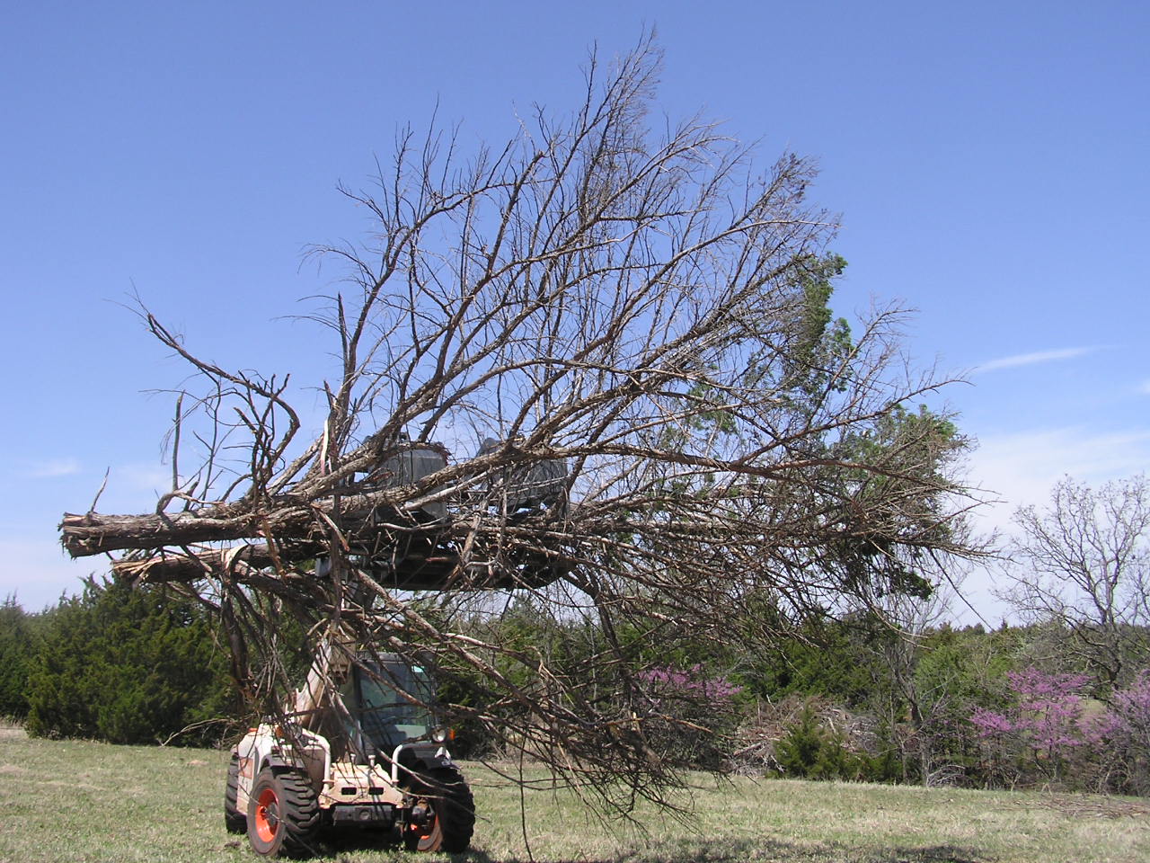

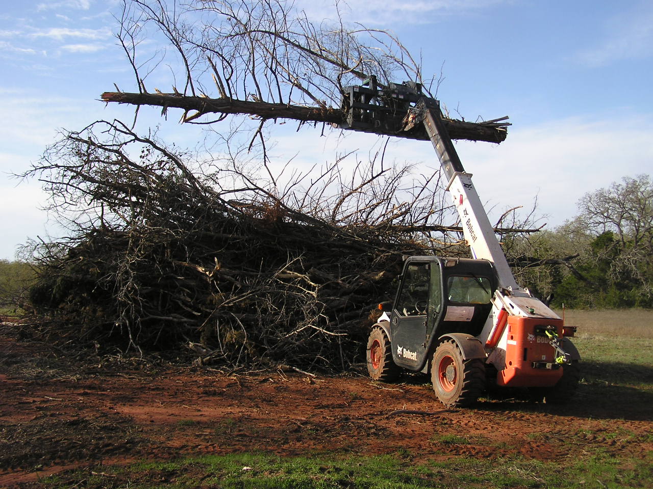

Use the grapple the most.

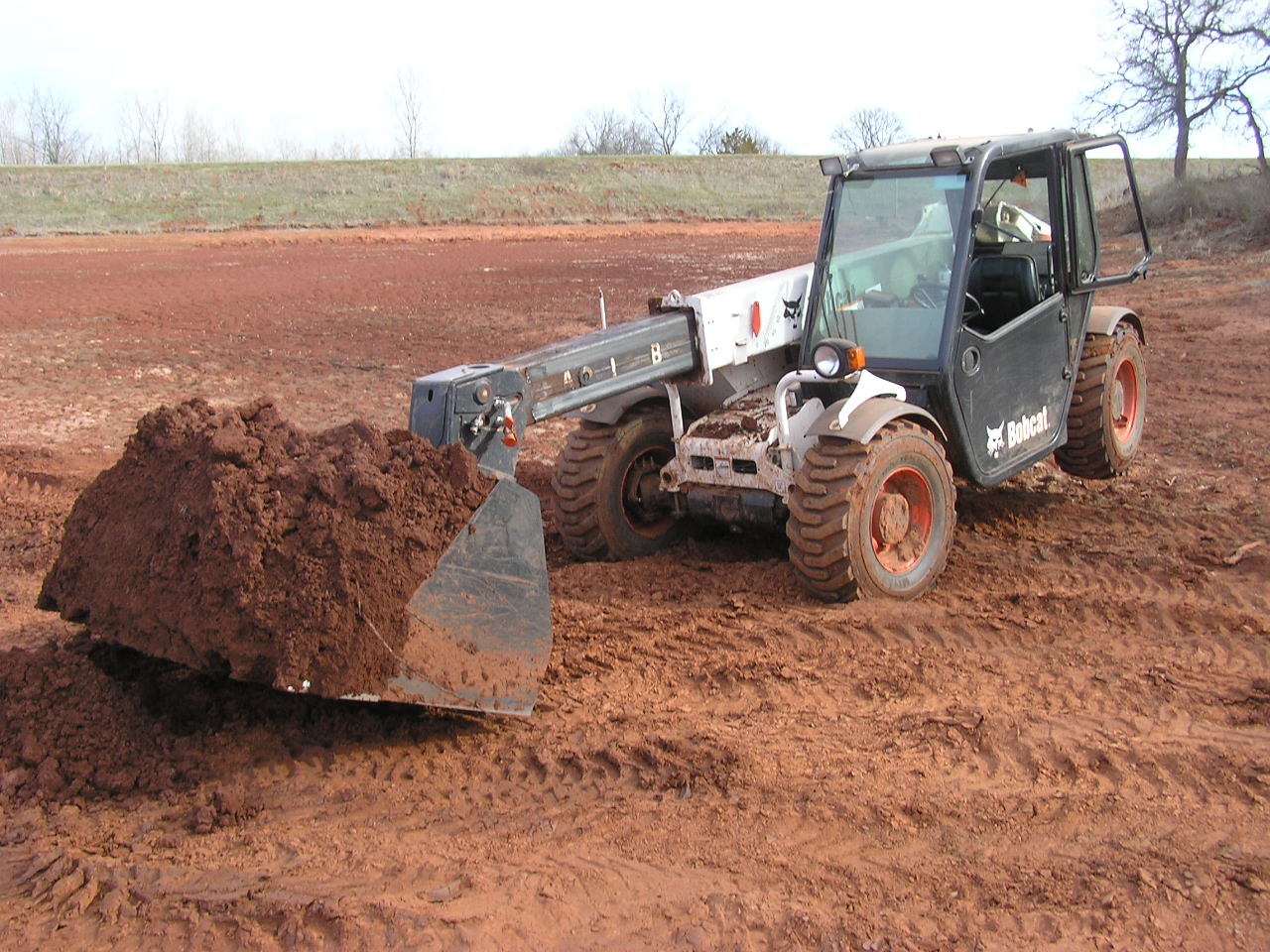

The 1 cubic yard, 6' dirt bucket, heaped, retracted the boom and raised it.

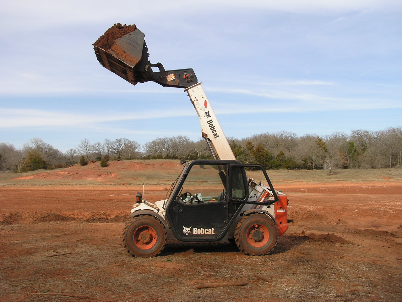

It will go 5.5 feet higher if I extend the boom :eek:

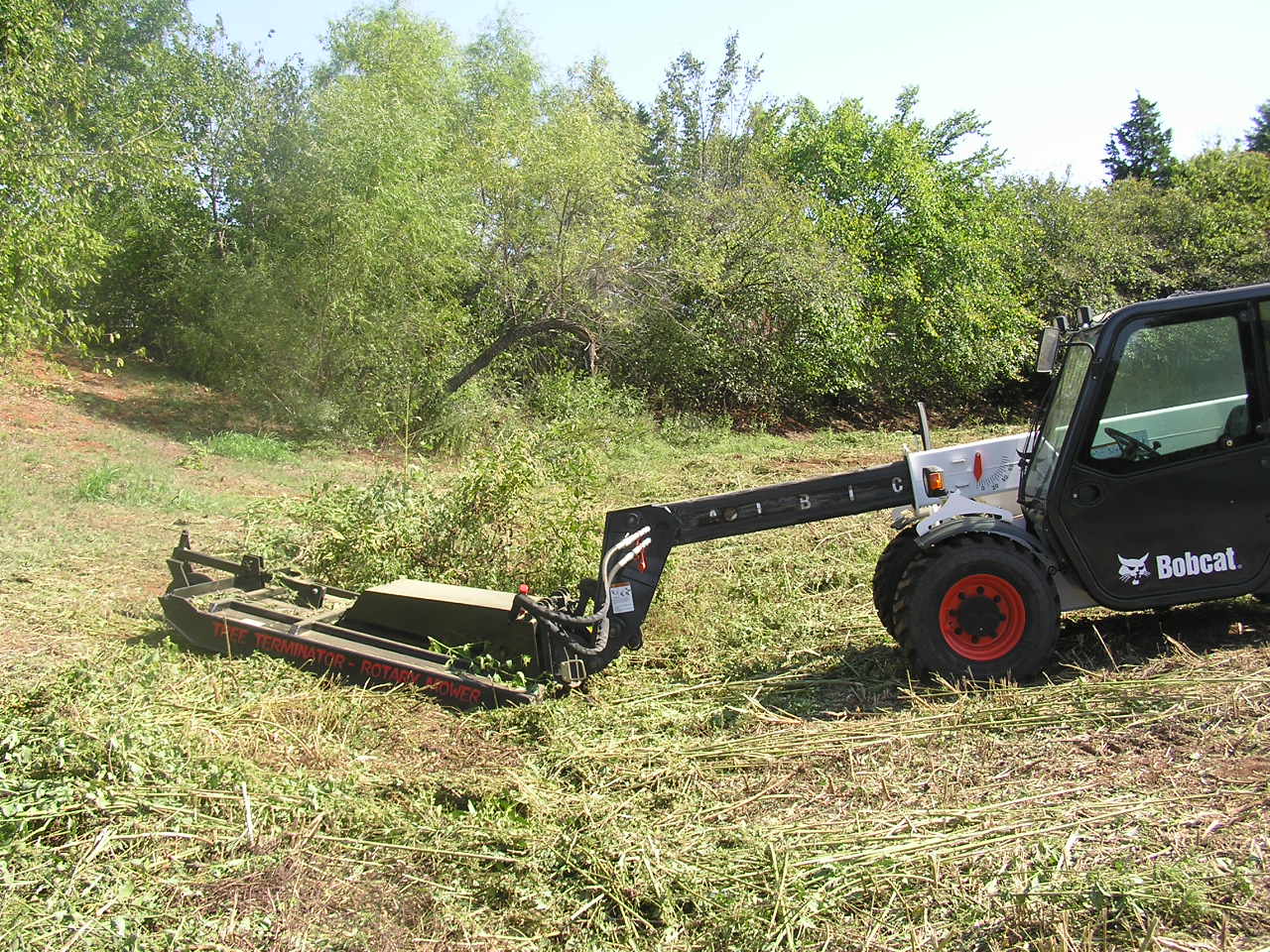

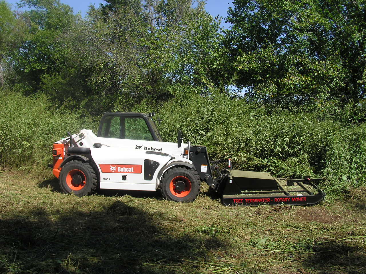

The 7' brush hog.
The V417 is 6' wide, 6.5' high and 13' long. Tire size is 14x17.5. Top speed is 15.5 mph, drawbar pull is 7,000 pounds, boom breakout force is 6700 lbf, bucket breakout force is 4700 lbf and it will lift over 5,000 pounds, 17 feet high.
