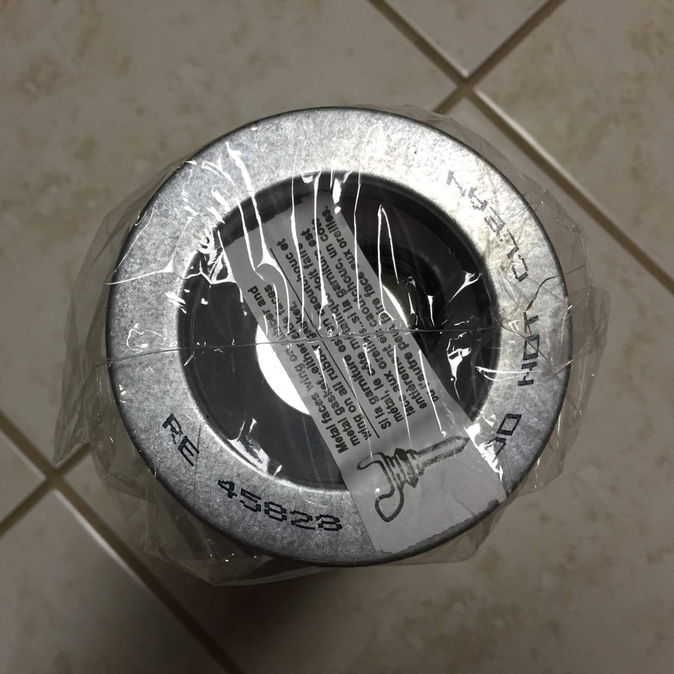

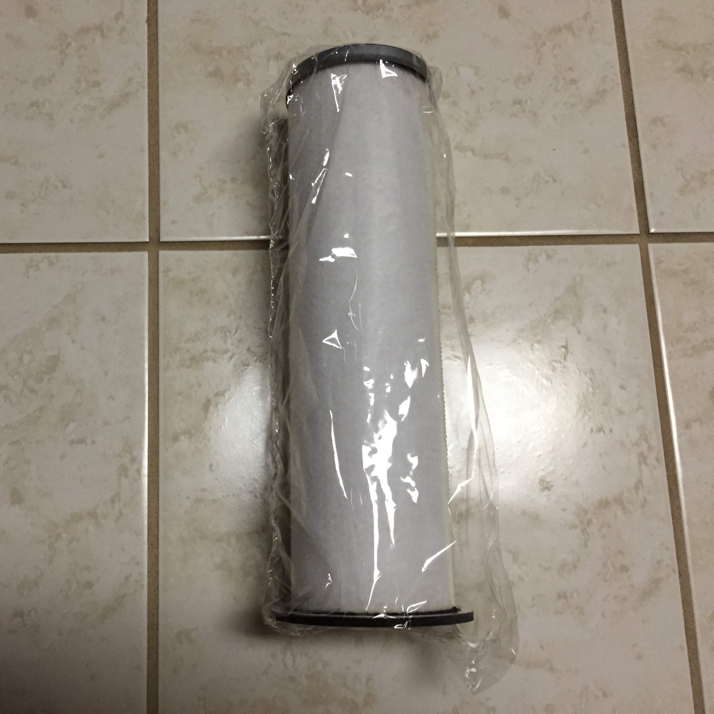

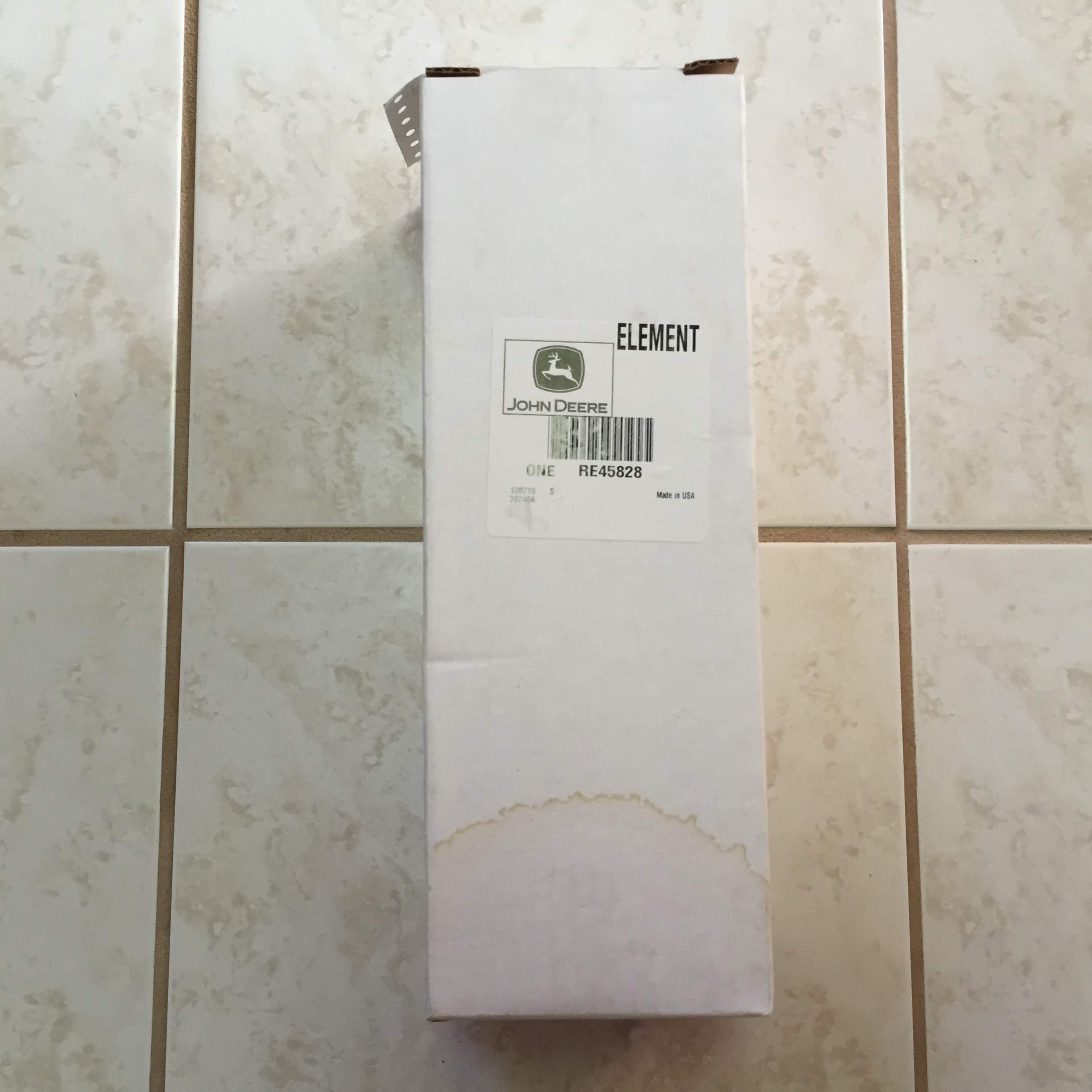

The inner filter was sealed in a clear plastic bag and was in a heavy white cardboard box with a white label affixed showing the John Deere logo, part description, part number, and also "Made in USA".

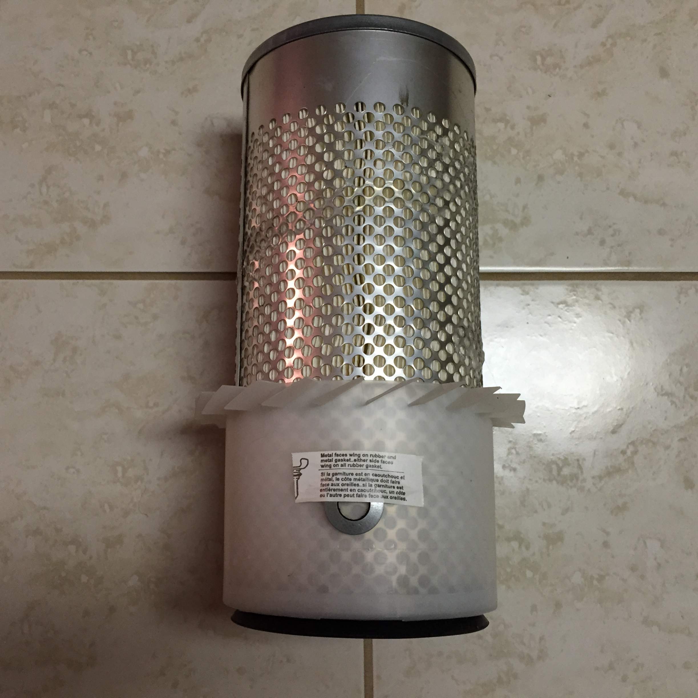

For ease of shipping to my eBay buyer, I removed the inner filter from its box and inserted it, plastic and all, inside the outer filter. The inner fit in the outer like a hand in a glove. Perfect fit.

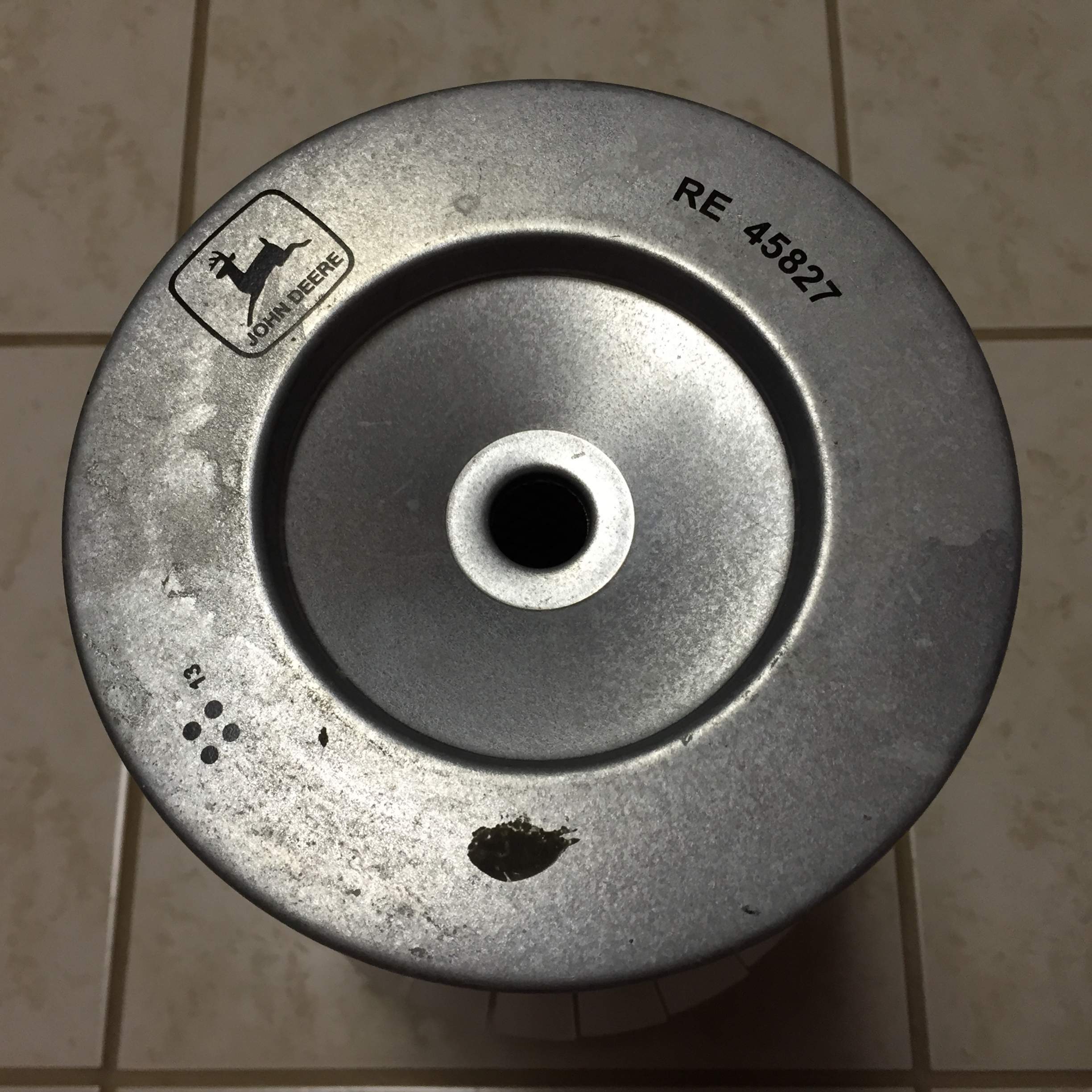

The outer filter appeared to be of a very good quality.
The outer filter had the John Deere logo and part number stamped right on the filter.
The inner filter lacked the John Deere logo, but it had the part number printed right on the filter, in a dot matrix fashion, along with the words "DO NOT CLEAN".
See my photos of the "wrong size" filters I sold on eBay.
