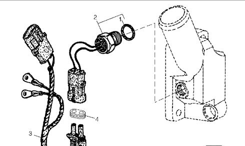

Have you cleaned both battery ground cable connections paying special attention to tractor frame connection? Also disconnect the cold start sensor on cyl head radiator hose connection. This cold starter sensor(RE503242) has a long history of failure & shorting out.
I have experienced this issue but it was blowing a fuse. Disconnected sensor and no more problems. Still have yet to replace sensor.

Already bypassed the cold start earlier last month. - thank ya'll for the input here for that fix
