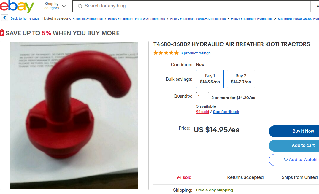

I'm thinking something like this:
I expect there is one or two ports on the hydraulic system that vent to outside air.
/ 50 hr Service #10
Once removed, that would be the location to insert the vacuum nozzle…. Also the breather pictured has no filter of any kind attached.
