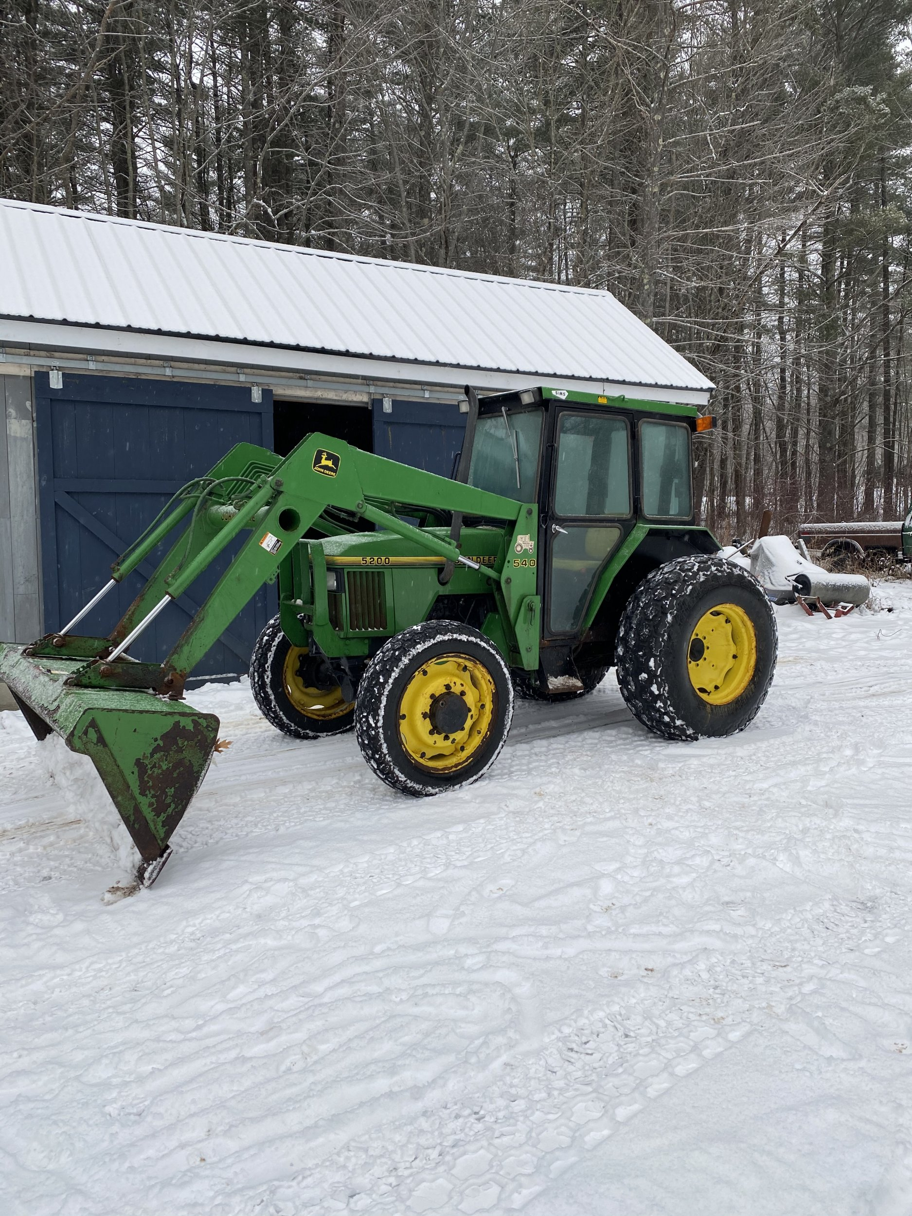

Just to follow up. I ended up buying a 96’ Deere 5200, 1500hrs, 12x hydro shuttle trans and a cab. Looking forward to getting it home and playing with it. I’ll need to rig up a 3rd function for the grapples, switch it over to skid steer style quick attach and start the hunt for some tires as it’s equipped with turfs. Thanks again for the help with different models, it worked!

I got the 5200 home, pretty much go through the tractor, front to back, top to bottom, learning how it works etc. overall it’s been well maintained, does have a little rust here and there from loading salt, nothing is too far gone that a little grinding, wire wheel and rust treatment and paint won’t fix. The cab heater was rotted pretty bad and mounted on the floor, I didn’t care for the location so a new is mounted out of the way on the ceiling, will blow warm air on your neck and the windshield. Got the wiper and all the lights working with a a couple fuses and some new wires. I’ve only put a little over an hour on it. So far I really like it. I plan to finish cleaning it up and running it the rest of the winter. If I still like it I’ll find some ag tires for it for the woods. I will say the turfs are much better in snow the r4s.
