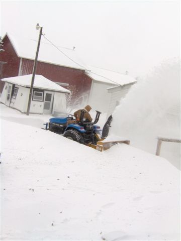

I have a Kubota 50 inch rear mounted blower on my BX (snowblower model B2789). Just checked the clearance impeller gap and it averages about 3/16 inch. The blower quit blowing just once and that was in very heavy and wet snow. (But I have had pto shear pin break a couple of times). This video (was posted on TBN earlier) gives some idea about its performance with deep snow and fairly cold temp (-9 C). http://youtu.be/PjBw4M82KUQ
