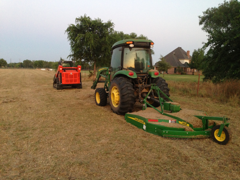

I'm sure your probably exaggerating a tad just to make a point but if that were true that its so bad you have to clean a cabin air filter every hour, you would have to do the same for the engine air filter and your radiator fins. Your machine would be a nightmare. Working in mass e excavation I have been in some disaster situations but can still get a full week in before cleaning anything. Just saying, you must be exaggerating a bit
I don't think he is exaggerating at all.. on my 3520 today and yesterday, while bush hogging... I had to clean it every hour.. including grille and radiator, else heat alarm would come on...

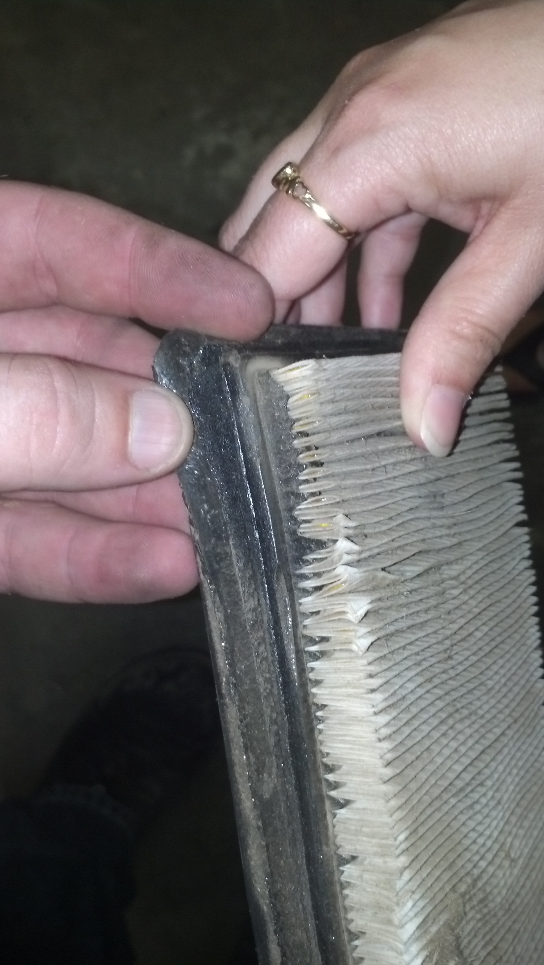

What if the crap filter fails? Which they do quite often.
Crap deign - cant defend John Deere n this one.

I looked at mine yesterday afternoon and will pull the top off to clean it up. Need to make a trip to the dealer for a new filter first. Gotta say the dust was real thick when using the tractor this year. I didn't have any problems with my filter edges coming apart as Darin's did but think that would be a sore point as much as the filters cost.
