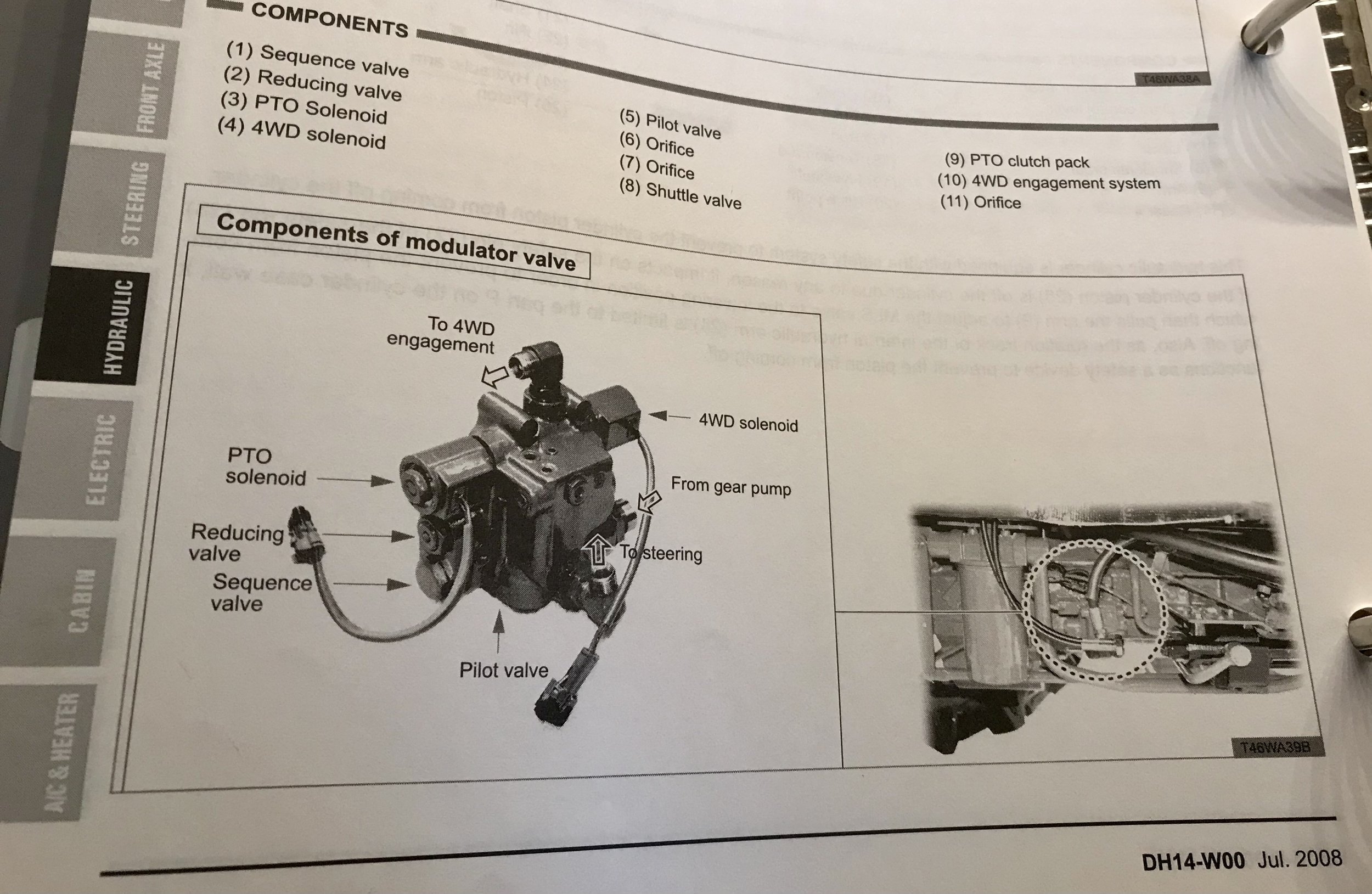

Ok, this gets a bit complicated, as i dont know year of your unit. But if its close to my 2010, the solenoid is attached to the modulator assembly on the hydraulic lever control unit. Ill also attach a link to another doscussion.

And finally, heres the info on the PTO Solenoid

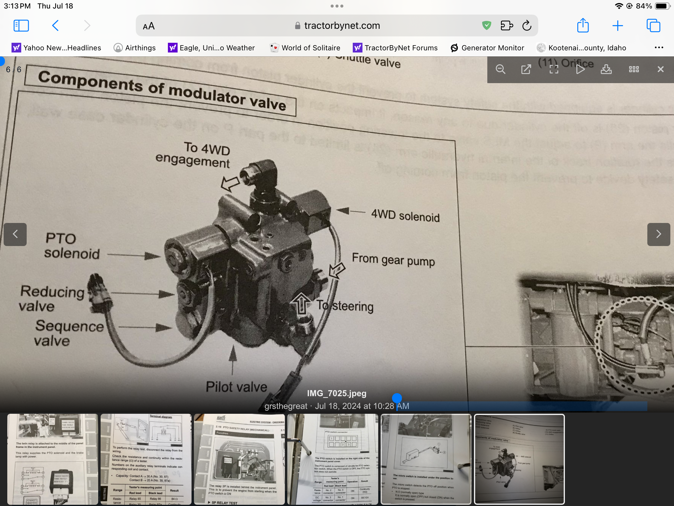

Ok, the book sucks in diagnosing 4wd solenoid, but it is part of the modulating valve assembly. Look at this diagram
