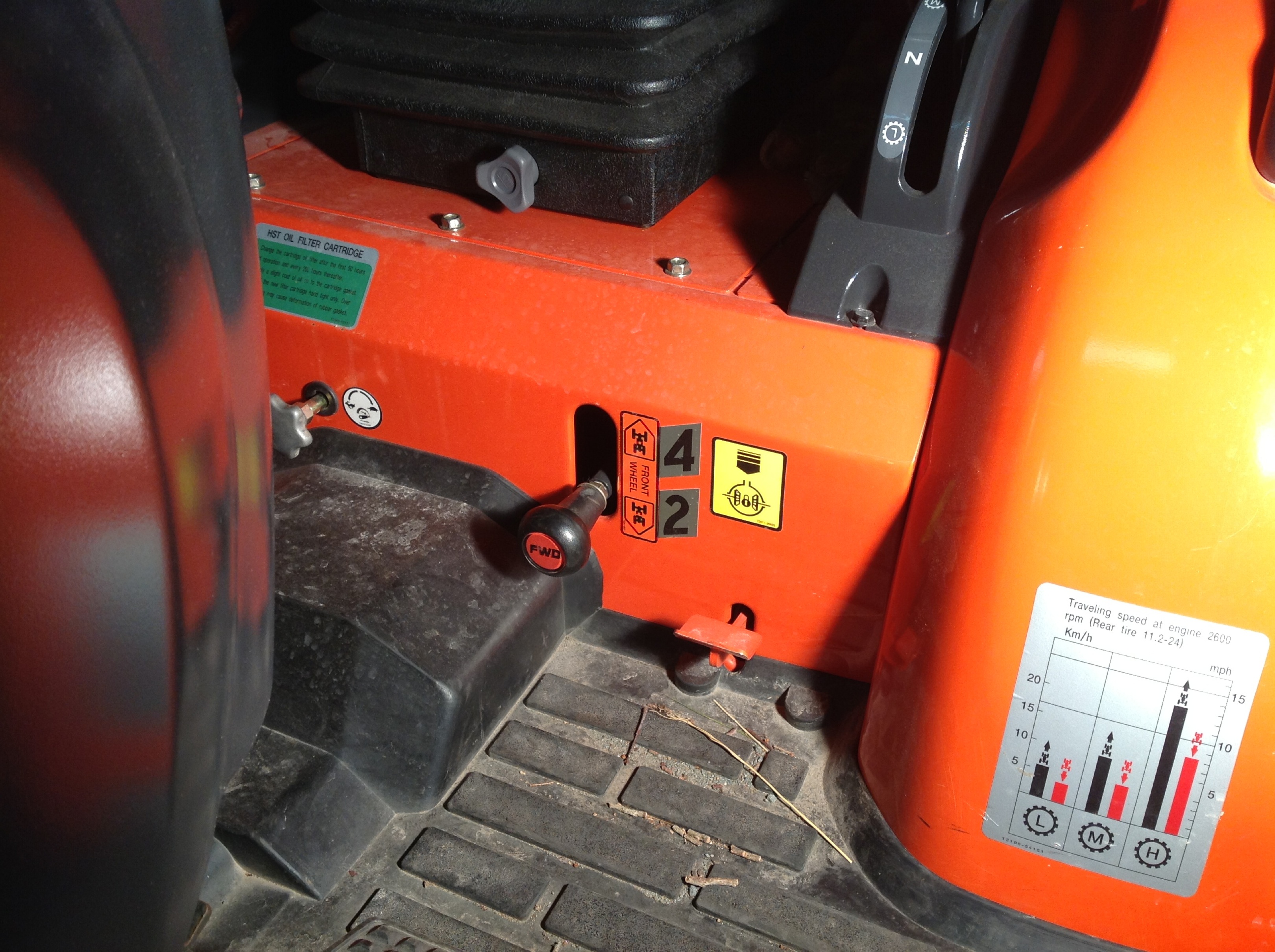

I have a 2018 DK5510. There is a 4wd dash light only on startup. I emailed Kioti and was told only the European models have a 4wd light while in 4wd. American models do not.
/ 4WD lever & indicator light. #22
After looking at the wiring schematics, saw that the US drawing did not show anything coming off of the 4wd (A22) and QT (A23) outputs on panel, but EU drawing showed connection to rocker switch identified with circuit as 32C. I took a look under the lower dash by the parking brake (DK4510SM) to see if maybe they used the same wiring harness. No luck. However I did find where the diagnostic port is, LOL.
