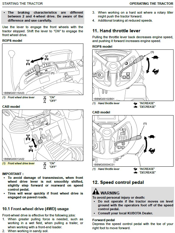

I read in the manual for my LX2610 that it's fine to work in 4WD doing loader work, which I have been doing. I watched a video with Tractor Time with Tim and one of the comments was that he should not being doing loader work in 4WD as it's gear on gear drive and its grinding gears when one of the front wheels spins and the other doesn't.
I just want to make sure that I'm not doing anything wrong.

/ 4WD and loader work #2
The manual states to not use 4wd anytime 2wd will do. If you need 4wd to get into the pile then that is fine. The wheels should not be slipping when filling the bucket. It they are you are not loading the bucket correctly or your pile is too solid and needs some breaking up before trying to scoop a bucket up.
Be sure to use proper loading techniques. Enter the pile flat, lift and curl while moving into the pile to fill the bucket.
The dealer had told me that they use 4WD for all loader work. I moved a mount of soil over the weekend on un even ground which is why one of the wheels had spun, plus it was pretty wet. I'm confused as to why the manual shows what it does below for 4WD.
/ 4WD and loader work #4
The up position is 4wd indicated by the closed link. There is another foot lever on my model that locks the rear differential so there is no spin in the rear when stepping on that lever.
/ 4WD and loader work #5
your going to learn people have no idea what they are talking about, gear grinding is clear as can be, do you hear it? prolly not, its generally a open differential, there is a reason they have lockers. if your not hearing noise, your not doing damage. i use 4x4 constantly and was slipping non stop today dealing with a flood.
do you know how much my wheels slip while plowing?
I didn't hear any grinding noises, I just looked down and saw one wheel spinning and the other not.
I should have been more clear, TTWT was doing similar work as I was, a commenter, not Tim, said that.
To be clear, it's safe to be in 4WD and be scooping dirt?
/ 4WD and loader work #11
It is safe to be in 4WD anytime you need it or want it. There is no such thing as a danger about being in 4WD. Forget that. Once you understand the machine and 4WD, etc. there are a lot of points to be made:
1) not good to be using it on dry pavement because that just wears tires worse and stresses the drive train due to slight differences in gearing from front to back, tire sizes, etc. Plus you generally have no need for it on pavement. Picture the average 4WD pickup truck. It has not only a differential in front and one in back but also a 3rd one in the middle which accommodates differences between front and rear rpm. You do not have that 3rd middle differential in a tractor. Differentials allow... go look it up if you do not already know.
2) Almost no tractors have front brakes. So especially on steep ground you often need/want all wheel braking. You get that in 4WD and not in 2WD.
3) A 2WD tractor is a stuck tractor ... and other opinions you do not need to hear. Good luck to ya.
