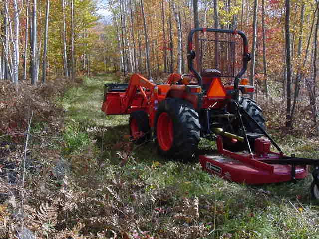

I have been using my hog alot this week, in some pretty rought stuff. I do tend to use stuff to it's full capictity. I couldn't be happier w/ it's performance. It is a Dale Phillip's . Huge blades, heavy metal on the body, and like I said, I have been rough on it. Here is a pic of the tractor and the blade and then I will show you some afters.
/ 4ft brushhog? Any suggestions? #24
before any work
/ 4ft brushhog? Any suggestions? #25
same spot after
