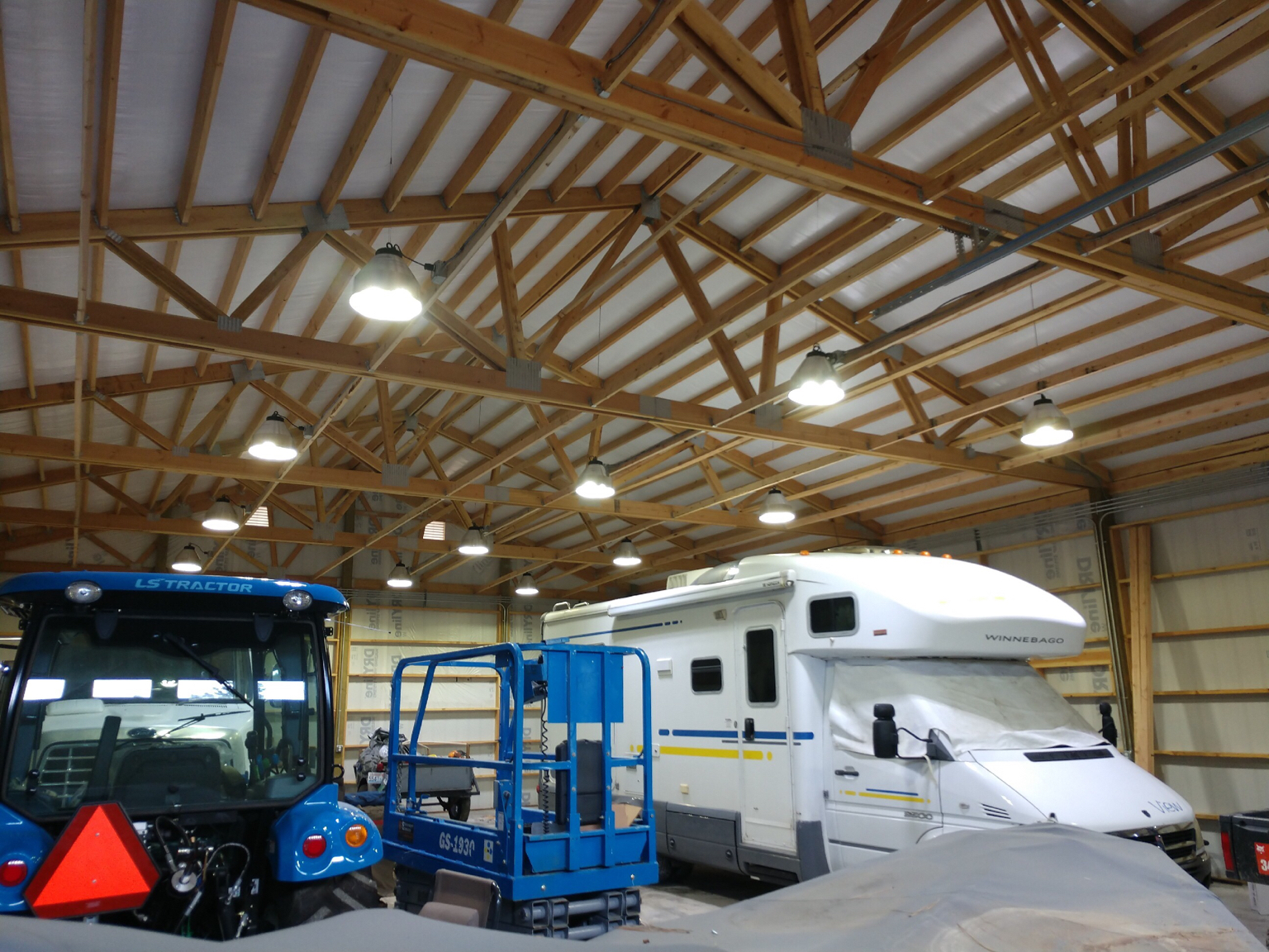

Got them yesterday, installed today, no change.
Talked to an Electrical Contractor today. Said he has two buildings with same equipment, same problem.
One last thing I'm going to try. My shop is 35ft from my transformer and meter pad. They are grounded with a copper rod driven into the soil. I did not do that at my shop. Tomorrow I'll add a ground rod. I'll report my results.

I just installed 11 with 5k LED tubes in my 30 x 40 x 14 work area, with the white metal walls and light gray floor worked out nice. I too don’t care for anything over 5k , the LED work lights on my tractor are 6k or better and are to blue for me.
Now you have me curious if the lighting will bother my openers, guess I need to try them.
I'm almost positive that my problem is the ballasts. They are emitting a radio frequency very similar to the frequency used by my openers. This creates "noise" that the opener can't handle. So it never "hears" the remote signal.
If your lights function without similar ballasts you should be fine.
I can't find anyone with this problem. I've talked with others that have range problems. But none that are as specific as mine. Just my luck... :)
