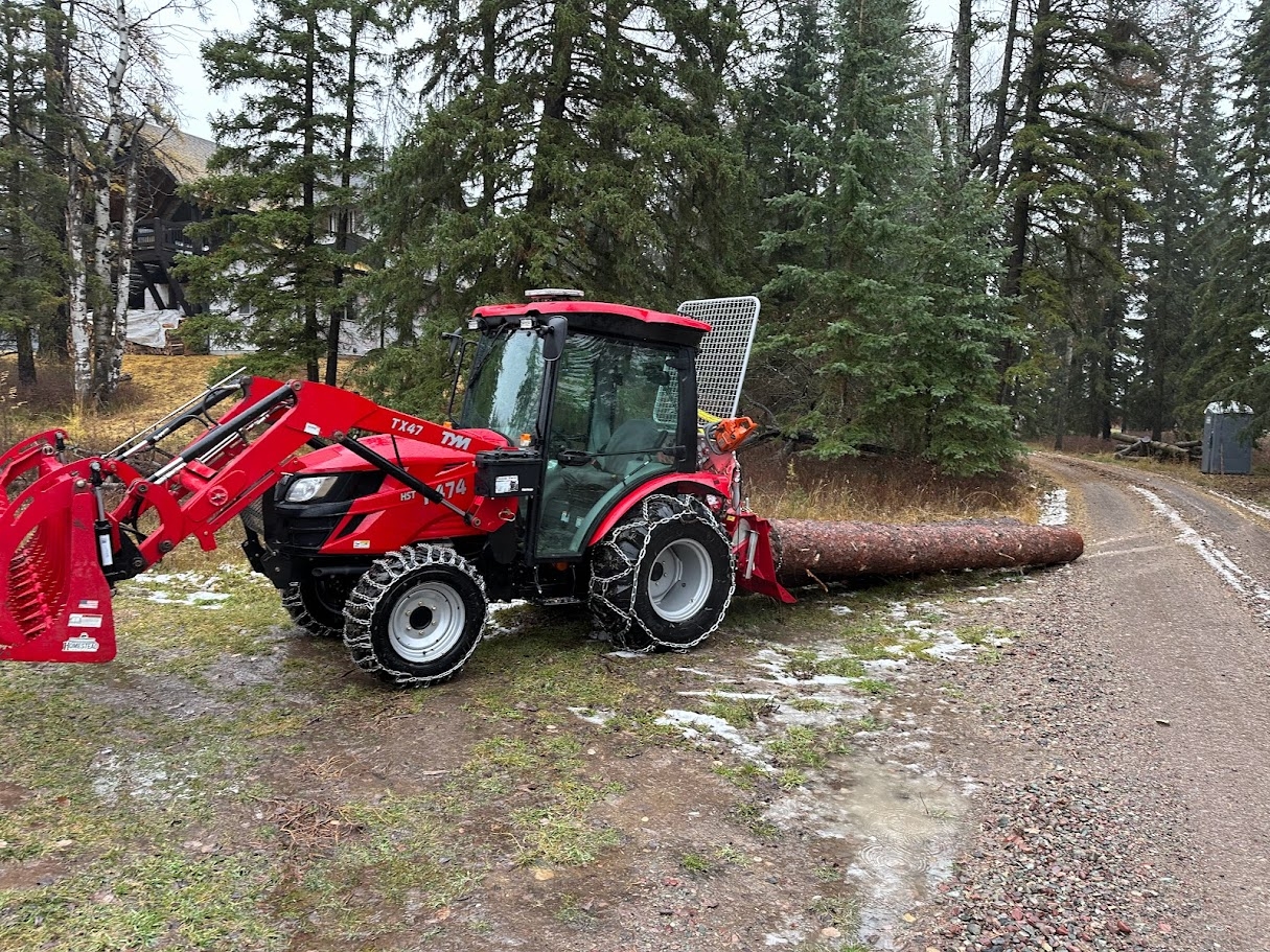

This is the reason I went with a T474 vs a T494. The 474 fits in my garage with an 8' door with a few inches to spare. The 494, although my first choice, would not fit.
I pull logs out of the woods all the time.
