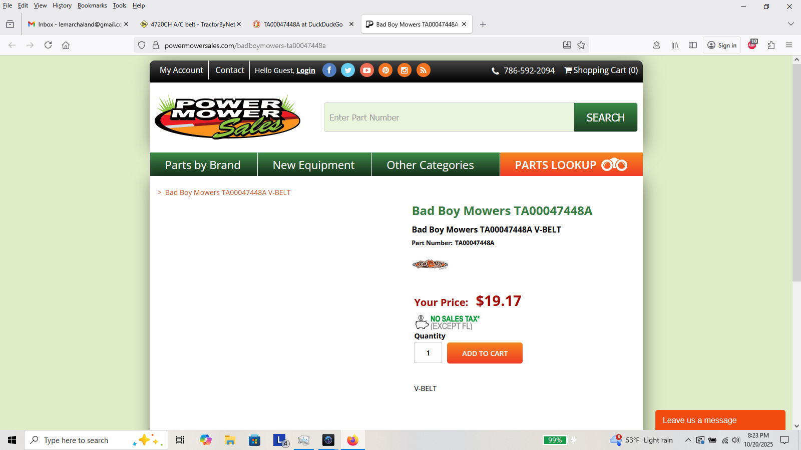

Does anybody know the belt size for the A/C? Mine broke today and the cab is like an oven without A/C. The part number is TA00047448A, but I don't have a dealer near me and I would like to just go to the autoparts store and pick up a belt so I can finish mowing.
Thanks
