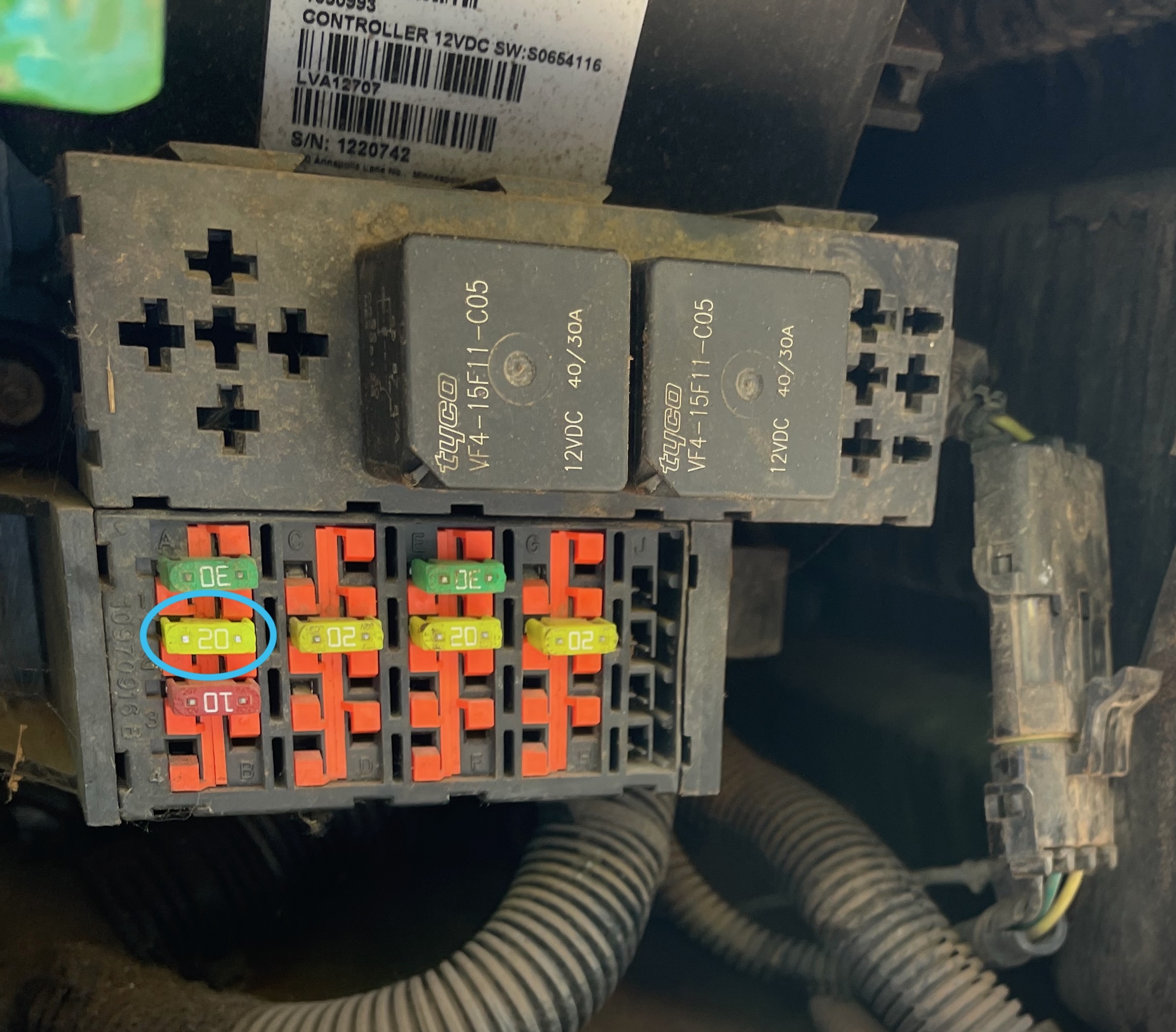

I was spraying my field using a 3pt sprayer with a PTO pump. Tractor unexpectedly shut down. When I tried to re-start it I got nothing. No dash lights, no cranking, nothing. It's as if there were no battery in it all.
Battery tests good. Removed and replaced battery after testing. Nothing.
Made sure PTO switch was pushed in. Still nothing.
All fuses and relays under the steering wheel appear and/or test fine.
Is there a fusible link or a max fuse or other fuses someplace?

I rechecked the fuses. One was blown. 🤦‍♂️

By this time I'm tired and hungry and it's getting dark. I message my family to say if anyone is coming up to the ranch, to please bring me food and a drink. My dear wife, whose love for me far exceeds her confidence, asks my neighbor to take me a sandwich and see if he can help. By then I had decided to wait until morning when I had some light, and perhaps a clearer head. Despite my pleas that he not come, he arrived a half hour later and we went to work. After at least a couple hours of cranking, resetting the come along, cranking, resetting, oh! is the brake still on?, cranking, etc., etc. we got the tractor loaded and headed to town. This morning, before hauling it 35 miles to the nearest John Deere shop, I decide to take one more look at the fuses. Especially that one that was to dirty to see the fuse element. Duh. That "dirty" spot was where the housing was charred. Popped in a new fuse and, or course, she fired right up.

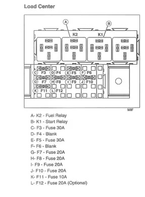

Which fuse?
Good question. It was the 20A fuse in the F7 position on the diagram below.
The operator's manual here: OMLVU24810_D1 numbers the fuses a little differently. On the owners manual diagram the one I replaced is identified as F05 (Ignition Run Power).
