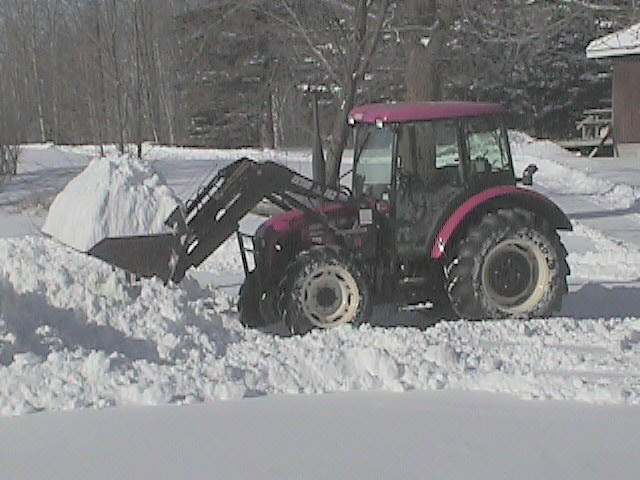

On a backhoe tlb getting a used industrial commercial quality machine that will shrug off the abuse 200 acres can create might be a better way to go. $10-15K could get an older 60 hp reliable open station.
I find 2 tractors come in handy as one loads & one pulls a trailer, wagon etc.
