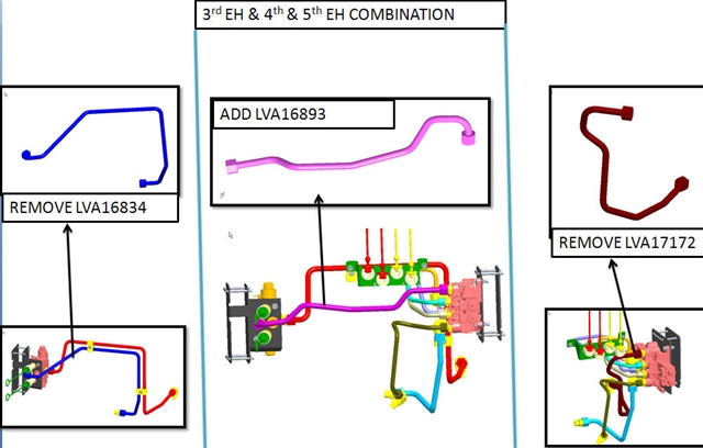

I just purchased a 2012 4720 cab model tractor. I also asked the dealer to supply the 3rd hydraulic valve, as well as the 4th and 5th. I got kits LVB26033 and LVB26072. The way the kits are supplied you can only install 1 or the other, as the steel lines provided only allow you to hook up 1 or the other to the hydraulic system. I installed the 4th and 5th kit over the weekend, but would still like to get the 3rd kit on. Is there a different part number for the 3rd kit when you have the 4th and 5th already installed?

Thanks Furu;
You are correct, I just ordered the parts to install myself. Both kits were correct IF you installed only 1 kit. IE: I could install the 3rd kit, or the 4th and 5th but not both as both kits tie in at the same place. I installed the 4th and 5th kit this weekend and returned the 3rd kit today. The dealer is going to look into it, but there is no different kit numbers if you already have one or the other installed. My 4th and 5th kit is electric, and works great! The 3rd kit would work if I had different steel lines. I believe what should happen is the 3rd and 4/5 kits should go in series, so if I had different steel lines then I could plum both in, but I am not 100% sure on this.

There is an additional steel line to make the kits work together. LVA16893 for the cab tractor and LVA16839 for the open station. Attached pic of changes.
Thanks JD110!
I see what they do. They come off the front service valve, to the 3rd valve with the line in the 3rd kit, then they go to the 4/5 valve with the change up line, then from the 4/5 valve back to tank with the line in the 4/5 kit.
Perfect. Thanks!

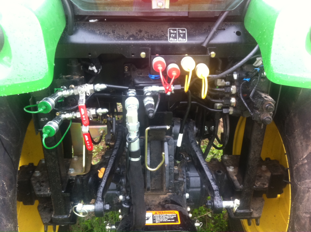

I installed the LVA16893 line and all is perfect! Thanks. Next problem. I got the power beyond kit to install now and I have the same issue. The kit would work great if I didn't have the 3rd, 4th & 5th kits installed. The lines supplied are for a bare tractor without any additional service valves. JD110 would you happen to have another diagram?

Thanks Jd110. That is exactly it. I have the 1 line, just need the other 2.
/ 4720 3rd, 4th & 5th hydraulics
#15
Thanks again JD110. Just thought I would toss up a picture of it all assembeled. You part numbers were perfect fit.

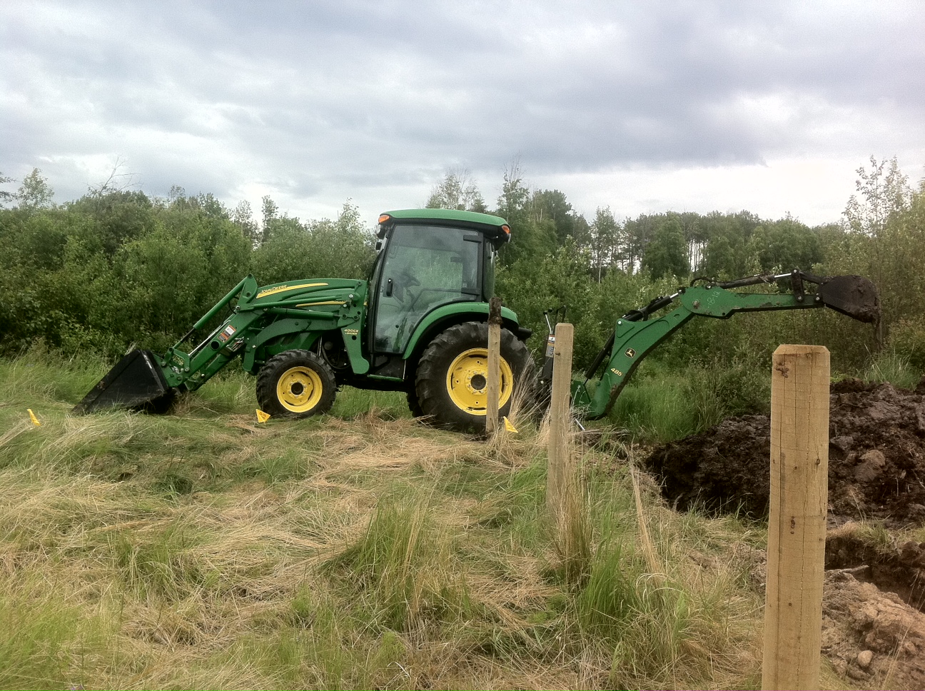

Ah, good question. I was rigging up a grapple for my bucket and I want to run a hydraulic thumb on my 485. I was just going to plumb the thumb into the 3rd quick couplers and then when I want to use it I can just shut off the flow to the front end grapple. I may just use the 4th or 5th spool instead. I am just in the process of building a thumb now, so that will probably be a week or two away. A hydraulic thumb is so nice for placing culverts...
/ 4720 3rd, 4th & 5th hydraulics #18
Have you played with the 485 yet? I've considered getting one, I just want to make sure it is a "real" backhoe. I wonder if JD will ever offer a hydrulic thumb. I'm curious to see what you come up with.

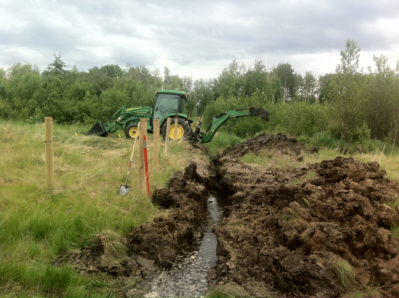

Yes, I have played a bit. I dug a 40' trench (seen in pics) it's about 4 1/2' deep at one end and tapers down to nothing on the other. The gas company had flagged a gas line crossing about 1/2, but no reference as to how deep it was. I put in a 16" culvert. The whole thing took me about 3 1/2 hours, including digging near the gas line by hand with a spade, and buring the whole thing when done. It's a pretty decent back hoe. My biggest complaint is I am used to the ISO pattern, so the dipper and the boom are backwards for me. It's hard to teach an old dog to change. I'll post something when I get the thumb on and running.
