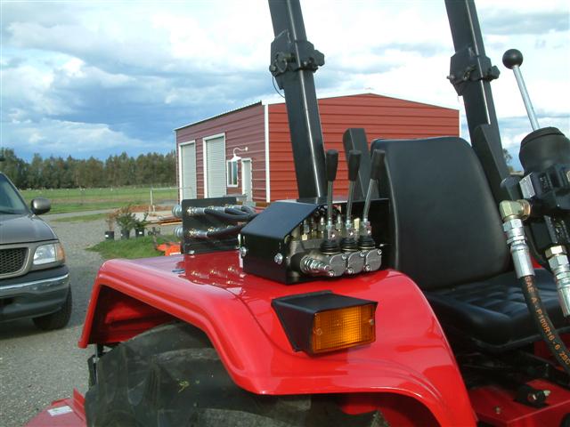

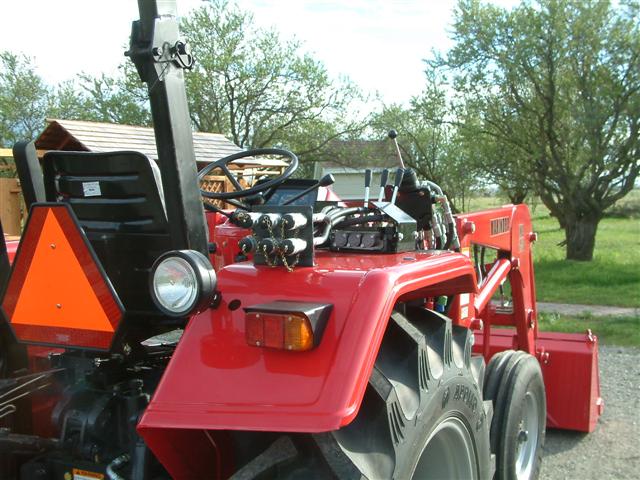

It would be cheaper to get the remotes as part of the tractor purchase rather than buying them later and installing them yourself. You need a minimum of two rear hydraulic remote circuits, three is better.
When I bought my new 2008 Mahindra 5525 tractor, I got triple rear remotes installed for $750 (dealer's design, not from the factory).
