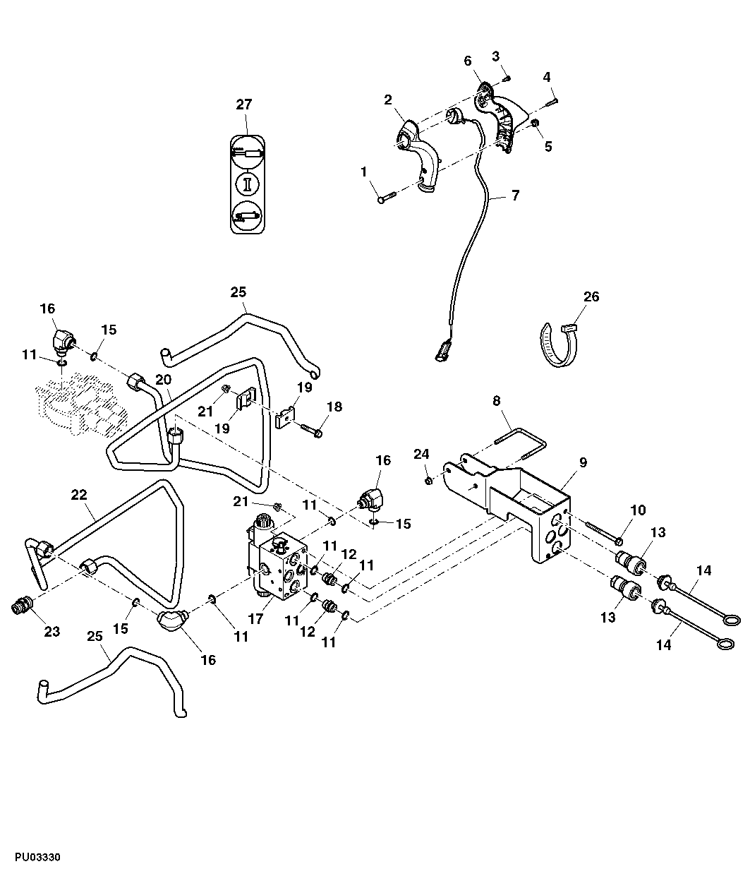

This is what I believe you are looking for. I have a 4520 and been thinking of doing the same thing you are doing. The bundle part number for this entire kit is LVB26032.

That's the handle and switch.
I looked in installation book but it didn't have pn's
   / 4700 - Best way to add valves for grappler and stump grinder #16
Here are the part numbers individually from JDParts. This will make up the handle and switch.
1-21H1486-Screw-Qty 2
2-LVU16650-Grip-Qty 1
6-LVU16701-Grip-Qty 1
3-37M7355-Screw-Qty 2
4-37M7356-Screw-Qty 1
5-LVA12162-Nut-Qty 2
7-LVA17501-Wiring Harness-Qty 1

Thanks Mechatgsk!
I added pricing I fund online for each part:
1-21H1486-Screw-Qty 2 @ $0.50 = $1.00
2-LVU16650-Grip-Qty 1 @ $3.20 = $3.20
6-LVU16701-Grip-Qty 1 @ $14.75 = $14.75
3-37M7355-Screw-Qty 2 @ $0.30 = $0.60
4-37M7356-Screw-Qty 1 @ $0.33 = $0.33
5-LVA12162-Nut-Qty 2 @ $0.35 = $0.70
7-LVA17501-Wiring Harness-Qty 1 @ $48.25 = $48.25
Total $68.83, which is less than what W.R.Long charges for their handle/switch by itself, which is $85.00.
