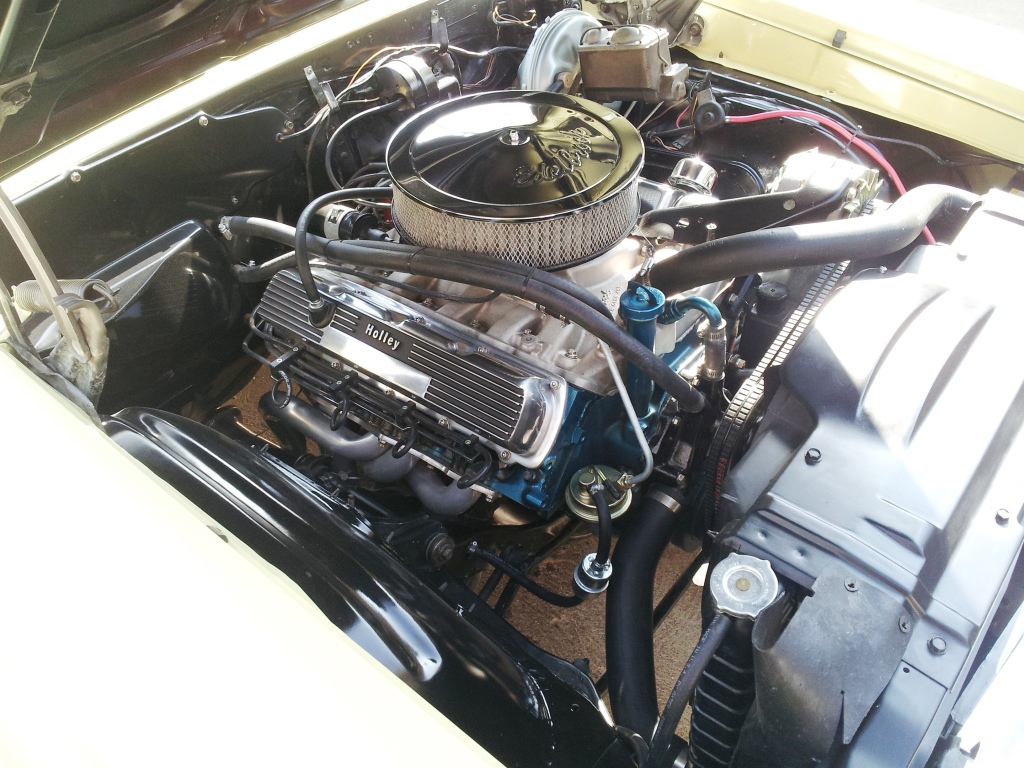

I had to take some pix of my 67 so I can get muscle car insurance coverage.
It turned out pretty sweet!

Very nice !!! And very rare up this way. Make sure you put lots of insurance on it. :thumbsup:
/ 455 Rocket #6
Now that is just Purrrdy!!:thumbsup: I can see allot of work and $$ in that job.
Labor of "love" I'm sure.
/ 455 Rocket #8
Awesome car. Great color. Looks like she's built to run too.
/ 455 Rocket #9
Great car. These engines work great with a longer duration cam than the factory put in.

Thanks for the kind words. It's a fun project still in progress. That's the OEM factory color, you don't see too many of those. It seems most muscle is red, blue or a shade of grey. I liked the old school look.
Arrow, you should like my cam... I recommend cranking your speakers before playing. '67 Olds 442 on Vimeo
This is the build we did we with the 455.
BLOCK: 455 tanked, decked, bored .30 over
CRANK: Steel 10/20 w/ ARP bolt kit.
RODS: Stock w / ARP bolt kit
PISTONS: TRW
BEARINGS: Cleavite rods, mains and cam
CAMSHAFT: Engle Special Grind Hydraulic 522/542 277 285 230 238
LIFTERS: Engle Hydraulic
PUSHRODS: Stock
HEADS: G 3 angle with hardened seats, decked, ARP bolts
SPRINGS: PSI springs and clips
ROCKERS: Stock
OILING SYSTEM: Stock
TIMING: Cloyes double roller w/ hex adjust
INTAKE: Edlebrock Performer
CARB: 800 CFM Holley
HEADERS: Hooker
EXHAUST: Flowmaster 40 Series w 3" pipes.
SPARK PLUG WIRE: Taylor
REAR MAIN SEAL: Rope - and it doesn't leak!

Great cam for the engine. Should really start to pull in 3rd. For future considerations and if you wanted to increase bottom end torque, go to 2.5" pipe. I'd also not hesitate in the least of putting in no smaller than 4.33's at the rear. Heck , I might even go to 4.66's. Whatever the duration took away on the bottom, you'd pick up right quick with this set up. If its a "crusin" car, no lower than 3.73's. You have a super car. I used to have a 68. They had an ugly front end but with some head work (one of the best things you did was to deck the block) , cam change and headers, it ran 12.4s all day long. Really surprised some stock Cobra Jet 428 Mustangs.
