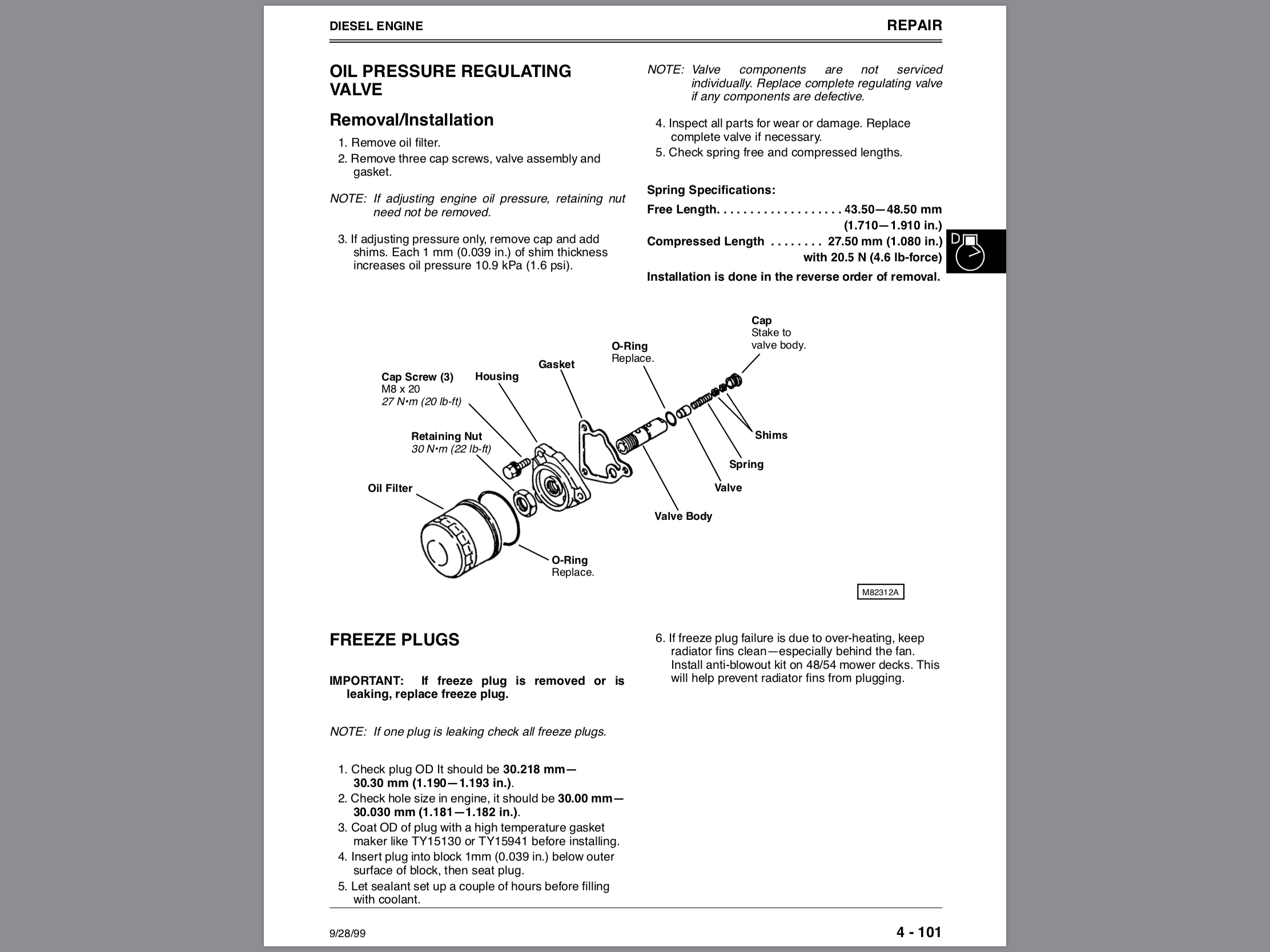

I was wondering if anyone else has had the same issue with this type engine? I have been reading the shop manual and it takes about checking the oil pressure regulator for wear. Not sure how you would do that. If the regulator is stuck I assume it could cause the low oil pressure. Can it be cleaned or it needs to be replaced. Don't want to just toss parts at it. I have always used JD oil and filters and it has been well taken care of.

Manual says to remove oil pressure sender. Which I have replaced already. Install adapter and pressure gauge. Oil pressure range is 43-64psi. Need to locate a pressure gauge that will fit and get some readings.
If low pressure confirmed the manual says to check the oil pressure regulator first. Then the oil pump. I had thoughts of a too low idle causing the issue. I don't have a tach to test that. If I bump up the throttle a bit the light goes out. Slow idle is listed at 1650. I think best to check idle speed first then move on to an oil pressure test.

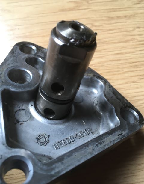

Sorry for resurrecting an old thread !
How did you guys remove the end cap off the oil relief valve ?
There are some flat parts on the cap and the valve which I had a 17mm spanner and an adjustable on, but I've now managed to round the flats on the cap and it hasn't budged. Is it actually threaded or is it pressed on? Wondering if it could be hammered out with a punch from the oil filter end somehow?
BTW, the reason I'm trying to take it apart is that I've just added an oil pressure gauge and it looks to be reading lower than the spec, at least according to the gauge which is saying 42 psi when full throttle when 'cold' but drops to 30 psi maybe when fully up to temperature, and is showing near 0. Oil light doesn't come on though.

Guessing you already have this page from the manual. Step 3. remove cap and add shims.
Not sure what “stake to valve body” means. Could there be a pin through it or is it crimped on. Can you post a pic of it? Don’t be embarrassed by any damage you may have done, we’ve all been there.

Do you have a reference or pic of this "end cap"? I don't find it yet in jdparts.
I believe they only sell the entire "Hydraulic pressure valve" as AM880983, which is everything, spring, cap, and valve body - quite expensive list price at my dealer at about $120.
Is this part referenced earlier in this thread?
Yes the part in the diagram earlier in the thread.
Are you planning to pull out the hydraulic pressure valve behind the oil filter and replace that spring ?? or something else?
Yes that's the plan, the manual has measurements for the spring in compressed and uncompressed states. So I was going to measure and check if it's within the specifications, and if not then see if I can find a suitable compression spring... or worst case replace the whole thing.
But I'm stuck being unable to remove the cap right now.
Yes, saw that. Doesn't explain how to remove the cap, no reference to the flats on it, and the guys on the thread haven't mentioned that bit.
Not sure what 都take to valve body means. Could there be a pin through it or is it crimped on. Can you post a pic of it? Don't be embarrassed by any damage you may have done, we've all been there.

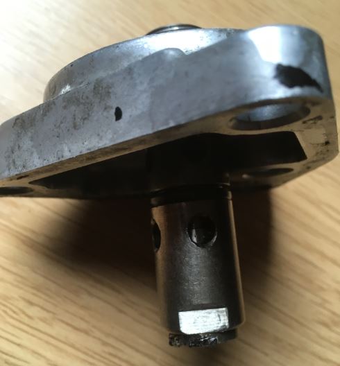

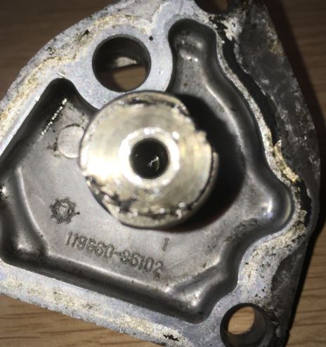

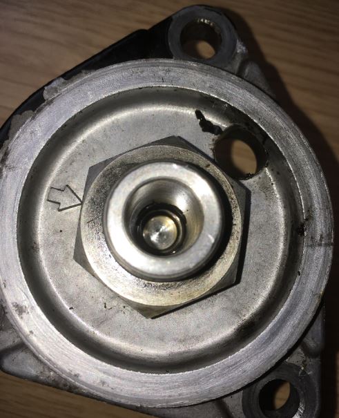

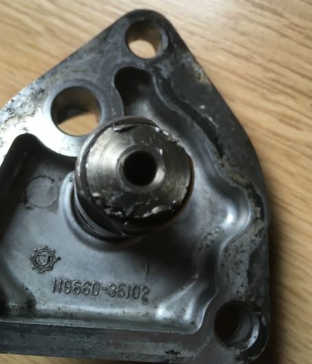

Nor me. Yes sure; here's a few photos of it, with the damage I've done to it !
You can see where I've chewed up the thread on the 'cap' part. The flats on the main part fit a 17mm spanner, but the cap flats were smaller than that... slightly larger than 15mm hence the adjustable. Any thoughts on how it's removed?
You can also see the Yanmar part number for the housing... using that I did a bit of detective work and I *think* that the valve unit is Yanmar part number 119225-35300 which I can get cheaper at $72 (assuming that it really is the exact same part !).
But I'd still like to check the spring length, and try to find just a spring before replacing it. I've also ordered another oil gauge in case it's a bad pressure reading on my existing gauge.

Just tried pushing the canister/valve part by pushing a bolt through the oil filter end. It pushes down against the spring maybe 10mm or so and then stops... so I'm thinking it might be possible to hammer/push the cap off from the inside that way, but not sure if it'll damage the valve depending on the force needed.
