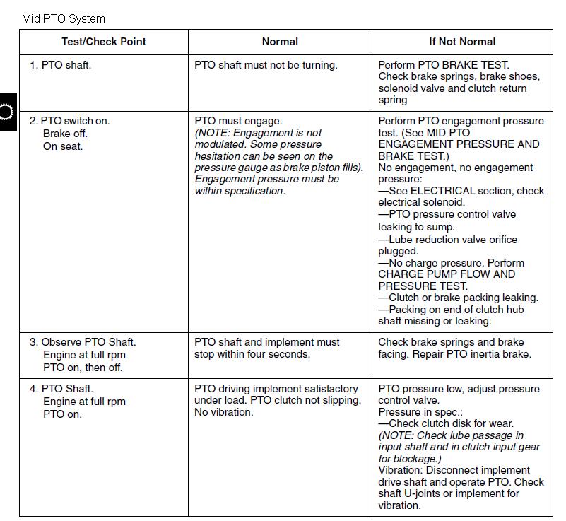

Hi, I have a JD 455 which has lost all power at the cutting deck. When I engage the PTO switch the deck barely spins (i mean barely) and you can stop it by putting your foot on one of the pulleys.
I know this machine has a combined hydraulic system, the one pump runs the drive, the steering, the deck lift and the PTO, and all the things except the PTO work fine, so I am fairly confident its not a dodgy pump or something as bad or expensive as that.
Does anyone have any ideas? I thought it may be the solenoid located on the back of the transmission case but Im not sure how to test it.
Thanks
Matt

Went and had another look yesturday and it is definately a mid PTO issue, not a problem with the deck. The manual has some ideas which I will try out over the weekend.
/ 455 54 inch deck problem #5
Sounds like adjustment of the mid-pto clutch/brake.
Do you have the tech manual?
Here is a chart of 4 tests leading to other tests.

I just read about a similar problem, but
on this one they noticed a lot of heat
on the transmission, turned out to be
a faulty pto brake problem.
(hanging up)
another option to investigate
