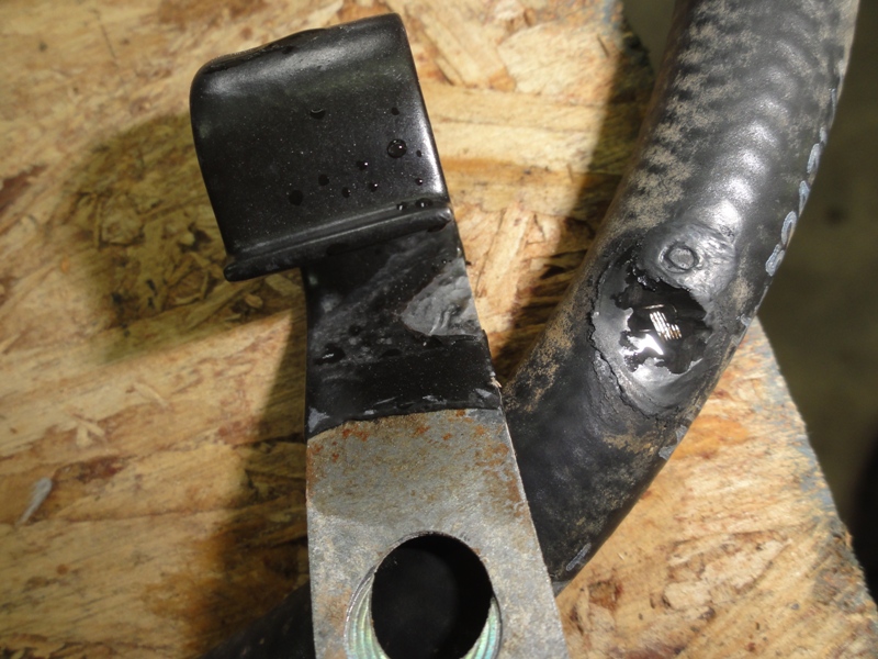

With the deck off I found the problem.
That largest hose from the transaxle to the power steering pump is held with a hanger.
That metal hanger, normally dipped in some black plastic, had worn thru the hose.(AM115774)

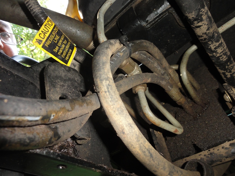

This picture was a while back, but it does show the lines connected to the Power Steering pump underneath.
This is looking up from underneath. The pump is behind the lines with the steering shaft running down.
Above these lines is the radiator/oil cooler.
The large hyd line that is busted is actually in the center.
That hanger is visible in the bottom right of the picture. The part where is cut through the line is just out of the picture.
Two lines go to the PS cylinder, and 2 hard lines that go to the oil cooler/radiator.
This hard pipe T's off feeding pressure to the deck lift valve assy.
It's a mess of lines in a small hidden place and it's danged hard to get a wrench on.
I hope to clean this up with Purple Dragon and water, then remove one of the PS lines.
Then, hoping to get that larger line off without removing the entire steering pump.

All you need is a new clip/hanger # AH96317. $2.54
This hose is bent and under some pressure at the hanger. It just wore the rubber off the hanger then the bare hanger cut thru the line.
I had seem oil on the deck recently, but I thought it was a PS hose o-ring leak.
For any 445 owners, check this the next time you have the deck off.

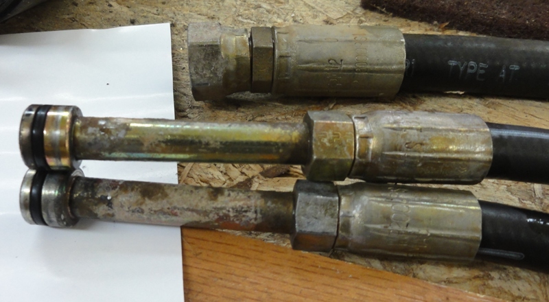

Just to help others I will post this info.

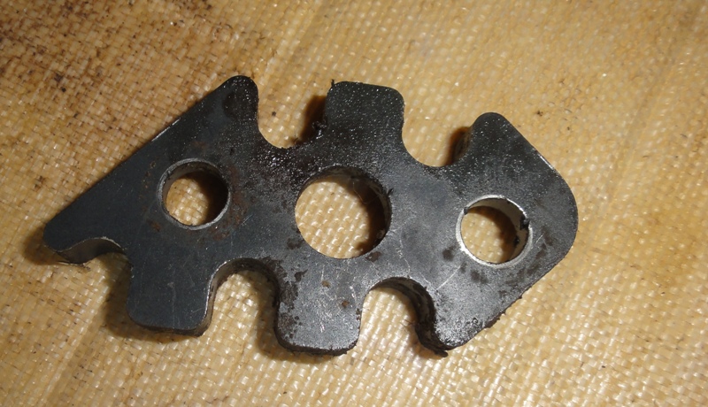

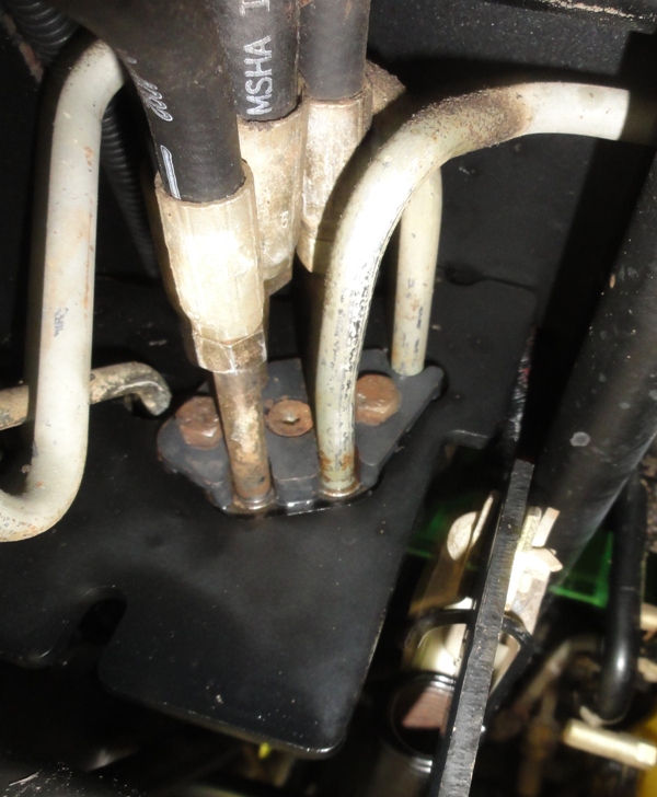

After I cleaned up the hose connections, you see a strange looking pressure plate.
These hose ends do not SCREW in at all...
You see two bolts (13mm socket) that has to come off and that strange shaped pressure bracket can be wiggled out.
All of these lines simply push in and the retainer tightens them all at the same time.
One photo shows the pump with the pressure bracket removed; the threaded hole is where the mounting bolt was.
Mine has leaked for years and I say it is a terrible design by JD.

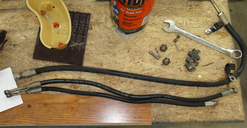

While previously replacing the PS cylinder, I had to rotate the whole cylinder to tighten the left hose connection.
I will install all new orings and new hyd hoses, as 2 of mine are already damaged.
In one of the pictures you can see where the hanger cut thru the line.
The 2 shorter hoses go to the PS cylinder.
The larger line is the supply from the transaxle.
The hard pipes go to the oil cooler inside the radiator.
As you can see I done LOTS of cleaning underneath before I started.
So if your pump is leaking from the connections, do NOT try to tighten these hose ends; all you can do is to try to tighten the pressure bracket.
And it's likely that it's not loose, but rather it needs new o-rings. It's hard for me to believe this design ever held hydraulic fluid...
This was a hard job to do without an overhead lift, but it can be done without removing the PS pump, radiator, steering sector etc.

Just one correction, as this is not a "pump" you are connecting to. It is the "power steering control valve".
And suspect that your repair was much simpler and easier with the push-in connectors held in by the plate design. Any leak can likely be fixed by new O-rings as you suggest.

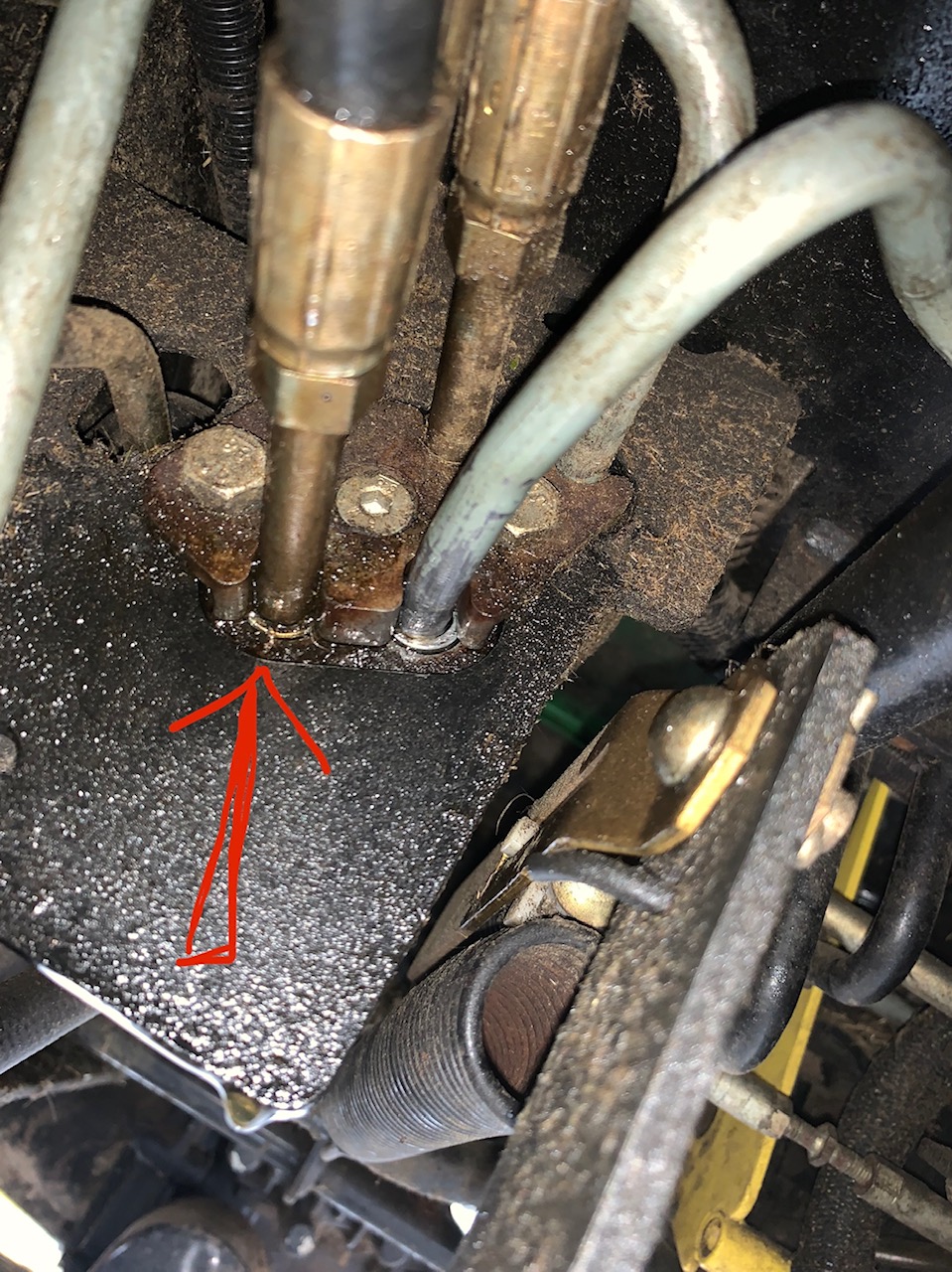

I am currently dealing with a leak at the same location what im finding is the schematic shows two o-rings the same size on the two formed metal lines. the fitting that goes in to the control block has an inner and outer o-ring. im having trouble getting the fitting back on the metal line with the inner o-ring in place.
anyone know of any special tools for this?
im using a little petroleum jelly for lubricant.

I busted a hose yesterday at same location. I might have missed it, but how do I actually remove the hoses from the valve body? Do I need to remove the plate at the front? I searched the forum and I can't find the obvious of how to actually remove the hoses. :)

Follow the procedure in reply #7. Remove the two bolts that hold that clamping plate. Have the replacement hose and o-rings ready to go back in. Avoid getting any debris/dirt in the hydraulic system.
Likely have to remove the deck, clean the steering valve area real well, maybe drain the hyd. oil from the system, raise the front of the tractor and hope that allows you to remove and replace the busted hose.

Got it! I missed that scrolling though my phone. Although fluid was spitting everywhere when sh*t hit the fan, I don't see any apparent breaks in a hose. But when I start it quickly, fluid seems to be oozing where the lowest hose enters the valve, see photo. Thanks again!!IMG_0965.jpg

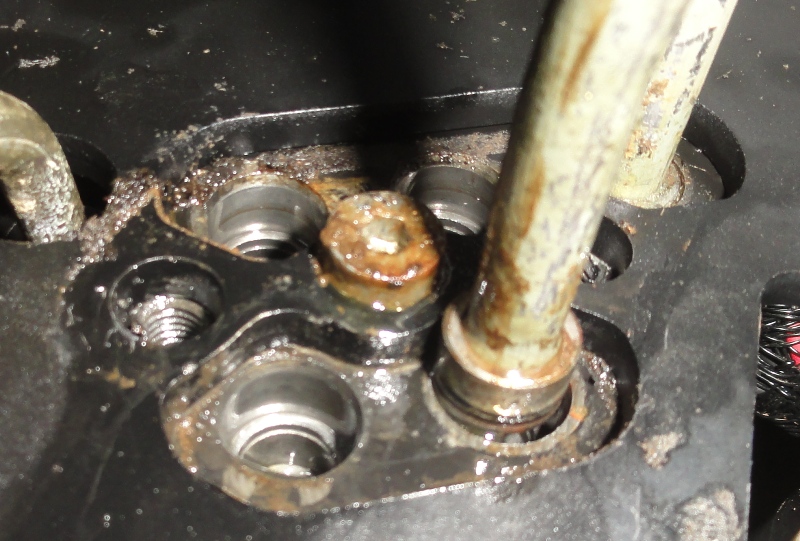

Nevermind! Its not the flexible hose, it is the hard line and it sheared off right at the pressure plate. Looks like there is another post in the forums about this same issue. That gentleman had it soldered back together.

Help!! I've got this question posted on another thread so I apologize for that, but I am really stuck after 5 hrs of trying to get this fixed. I have the hard line in place, one end hand tightened onto the SCV and the other line is sitting in the steering valve. However, I am going to really need to push this into place so it sits in the correct port. Right now it is sitting nicely in the port just to the left, where the main hose from the transmission is supposed to go. After all this kicking and screaming, I am hesistant to really push this hard line into place. Has anyone done this repair that can offer some guidance?? Please and thank you!!

If the correct receiving port is clean of any debris and the o-ring is the correct part number, then (although admit to not having done it) I'd force it in or rely on the bracket that holds it in drawing it tight when snugging up the two bolts.
